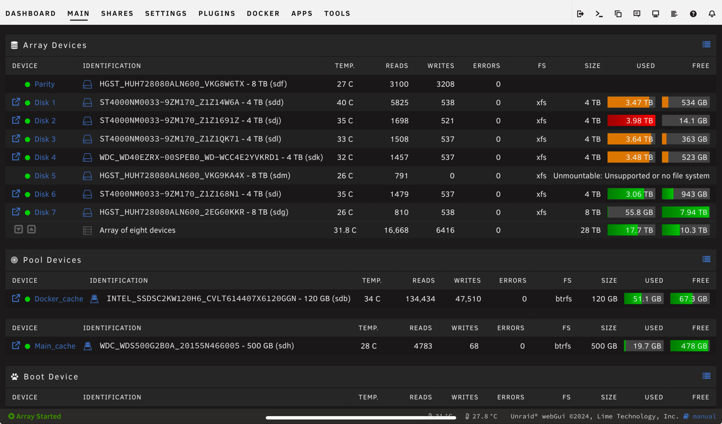

After adding and clearing and formatting a new drive (#7) got this error on disk 5.

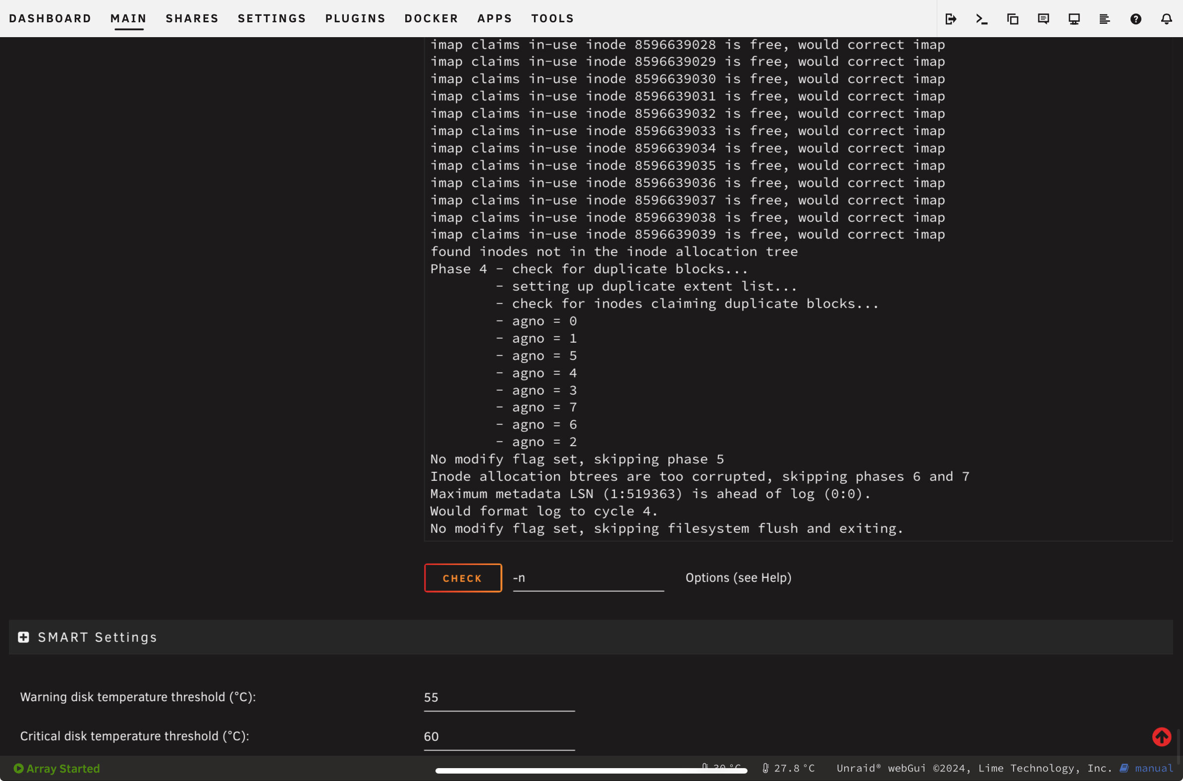

I searched the forums and ran the file system check in the docs, followed by the file system repair for xfs as per the docs.  Never got prompted for -L that I know of because it ran for a couple hours and finished on its own.  Now drive still shows the same unmountable error.  Ran another check and now the progress is full of entries whereas the first time it was short and all seemed ok.  Is this a failed/failing drive?  Can the drive or data be restored?

Run it again without -n, and if it asks for -L use it.

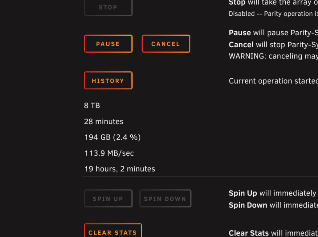

Just to close out this issue, I finally got home from a trip and was able to change the Sata cables around.  Long story short, changed Sata cables and then Parity disk showed red X.  Stopped the array, unassigned parity, started array without parity, stopped array and re-assigned old parity.  Started array and parity sync started and is running like normal, FINALLY!  I had been having issues with SLOW PARITY sync until this simple solution (replace Sata cables).  Parity running at 118MB/s still using the original “cheap” controller one of which has a multiplier on it.  I will let this finish to restore the array to proper state and then I have 2 new ASM1166 (6 port no multipliers) controllers ready to go which will optimize my throughput and future proof me as far as number of devices goes.  This thread and whole experience has been very educational and thanks to you guys for the guidance!
