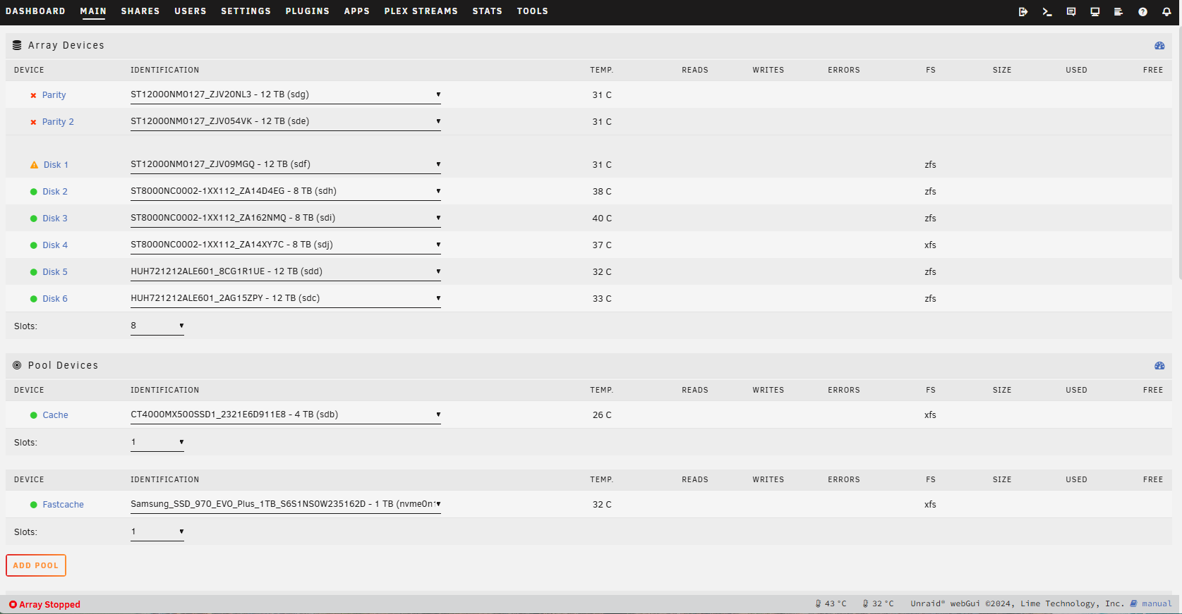

I have 8 drives in my array (2 parity + 6 data disks). They're connected to a 5 bay and 3 bay Kingwin drive enclosure, which in turn is connected to an HBA (LSI 9500-8I). The 5 bay is filled with 12TB drives where two of which are parity for the array, and the 3 bay is filled with 8 TB drives.
Tuesday night, Unraid started doing it's scheduled parity check. During this process, Parity2 and disk1 appear to have disconnected themselves from Unraid and remounted themselves under a different mountpoint. This caused a few error, Unraid disabled Parity2 and Disk1 and paused the parity check. Weird, no biggie, I'll work on rebuilding the array over the weekend (stupid me).

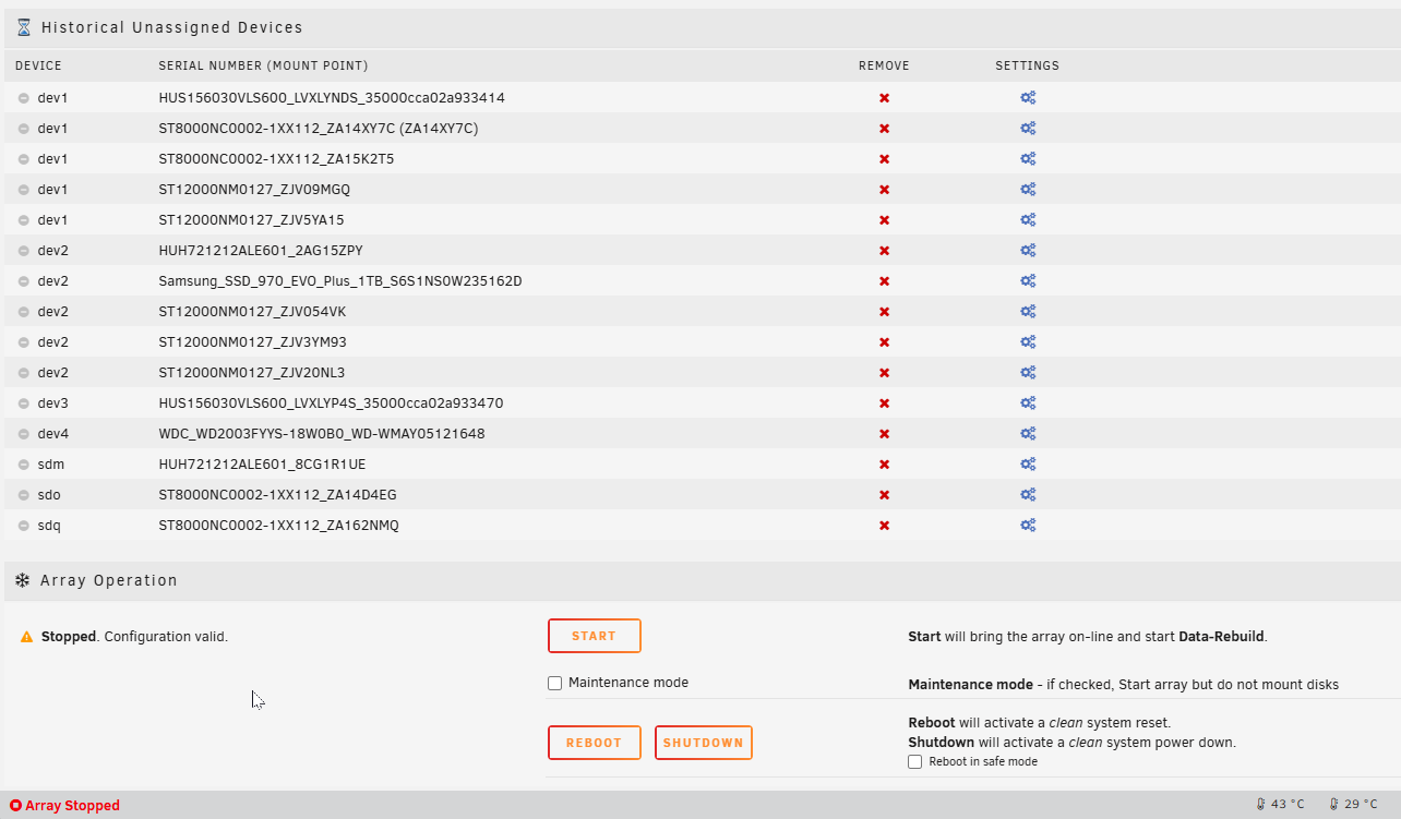

I log back in to Unraid yesterday and notice while the parity check was paused, Mover decided to run. Disk4 shows connected but spewing millions of errors. I panic, download diags (attached), attempt to reboot the server, but it doesn't reboot. So I force it (stupid me). Server boots back up. I start the array. Parity2 and Disk1 show disabled, and no errors on the other drives. I do a quick SMART test on Parity2, Disk1, and Disk4, and it comes back with no problems. Ok... let's rebuild. I stop the array, remove disk1, start the array, stop the array, add disk1 back, and the array starts rebuilding. A few minutes later Disk4 is spewing millions of errors again, and Parity1 now shows disabled. I shut down the server, reseat the cables, reseat the HDDs in the bays, boot the server back up, and kick off extended SMART tests.
The extended SMART tests just completed (attached) but they reported no errors. With parity1 and parity2 disabled, I'm going to assume a rebuild is not possible. I have no idea what to do next here. I'm hoping there's a way to come out of this with a few broken bones, but not completely dead. TIA
