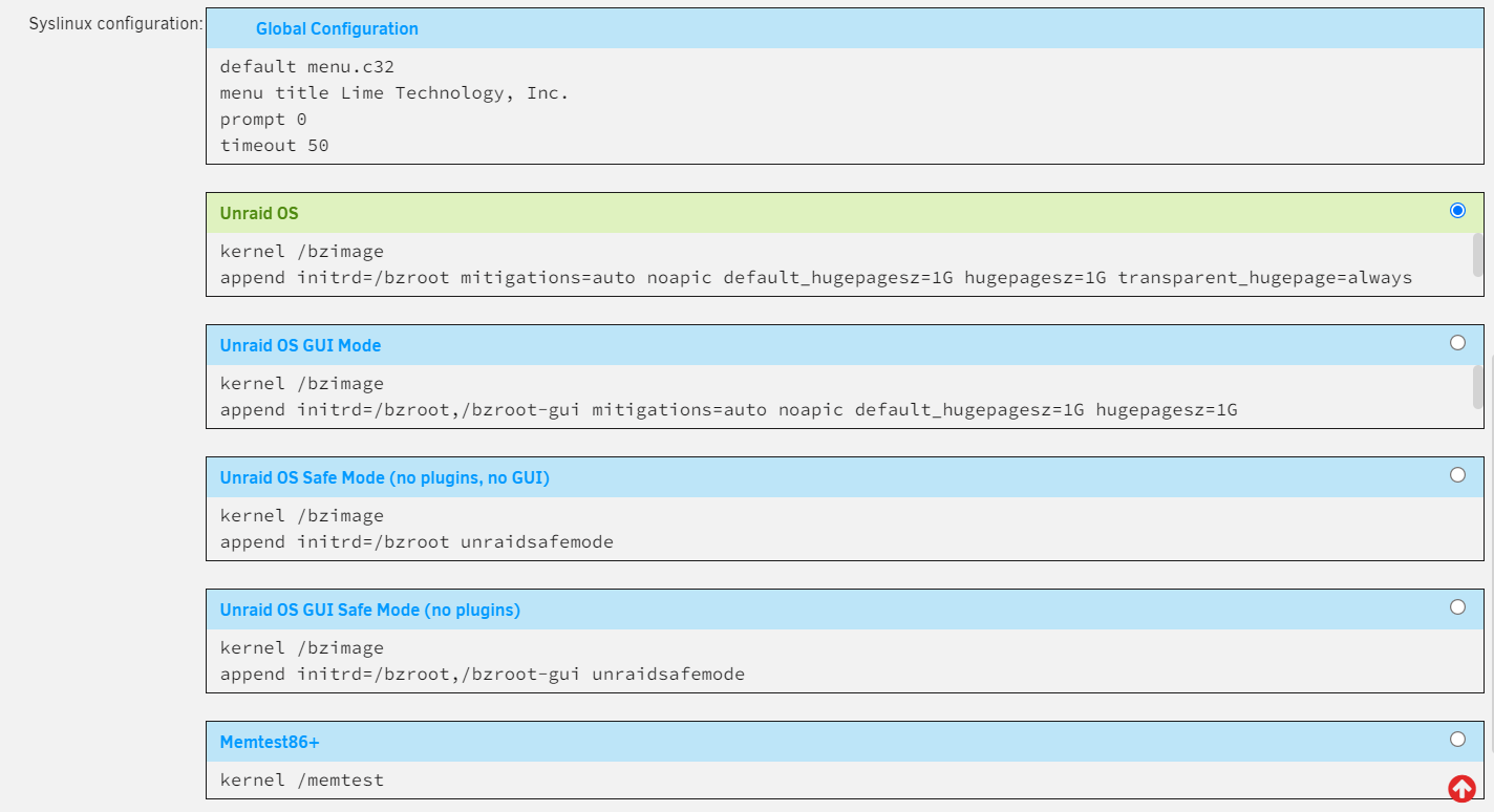

you do this at the grub / kernel parmerter the option is "pcie_aspm=off"
WebUI > Main > Flash > Syslinux options
The green tab is your default boot enviroment:

Thanks.
