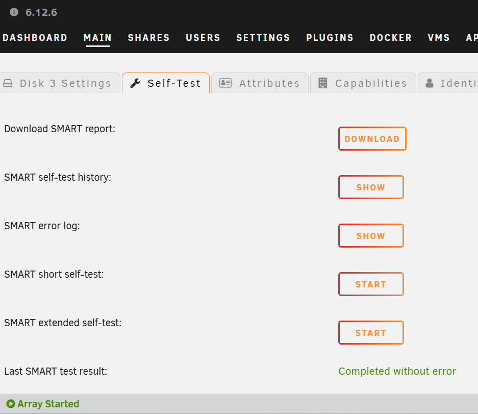

Its saying without Error. Whats my next move? I really dont want to loose any data on that drive.
SMART test passed, so the disk is OK for now, the emulated disk was mounting, assuming contents look correct, you can rebuild on top, then keep monitoring, but any more errors in the near future I would consider replacing that disk.
