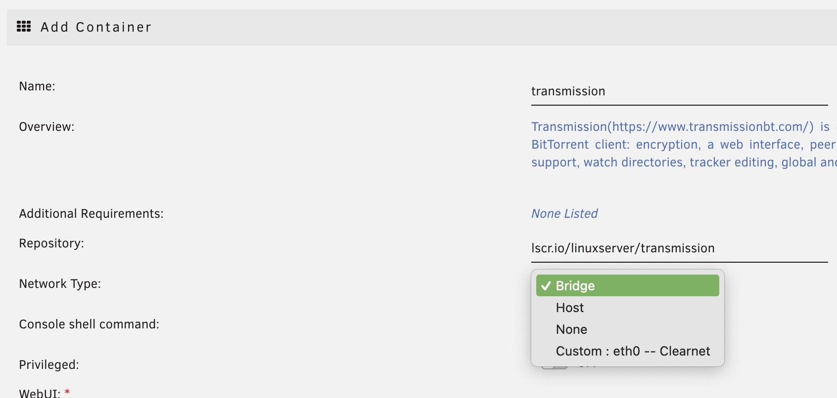

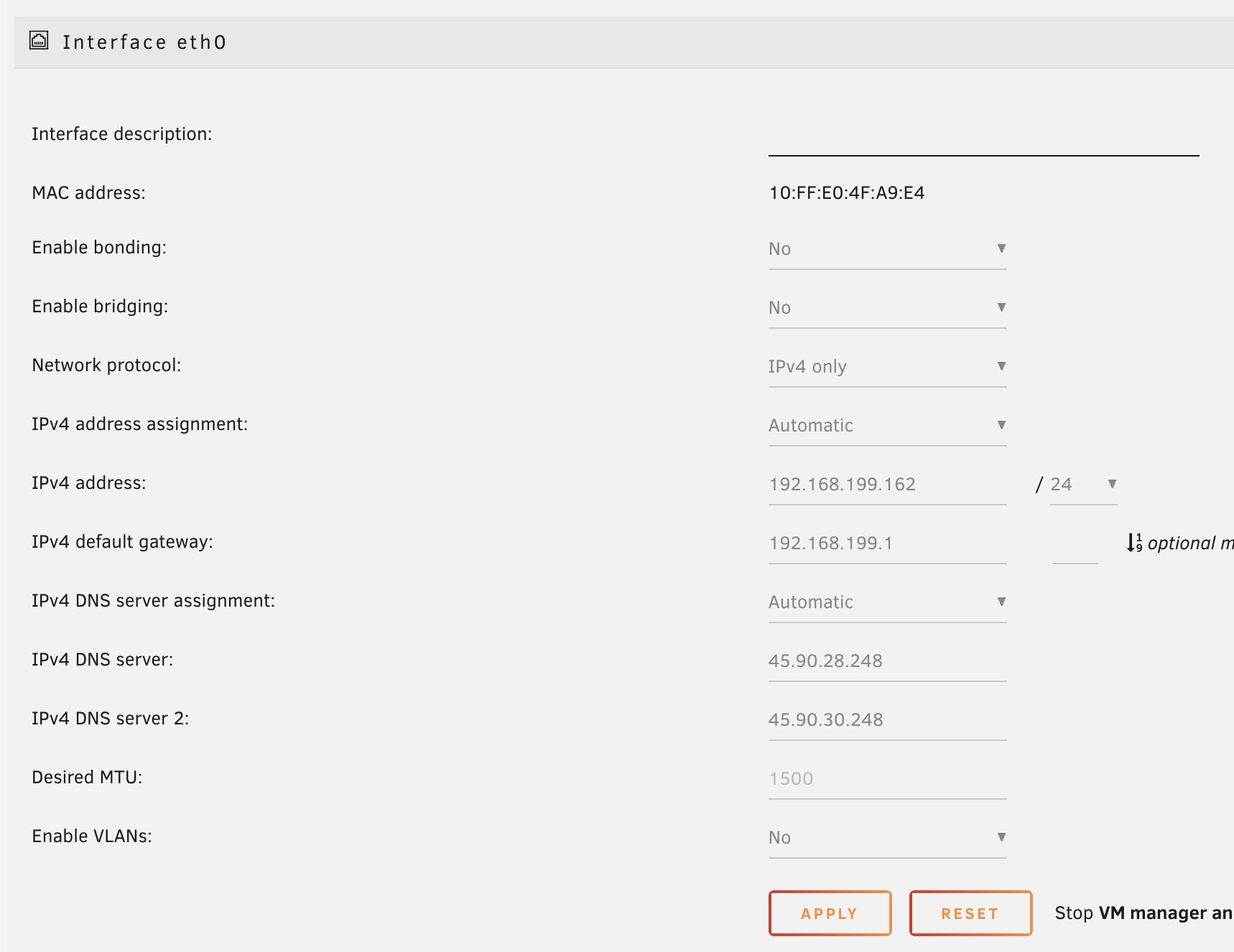

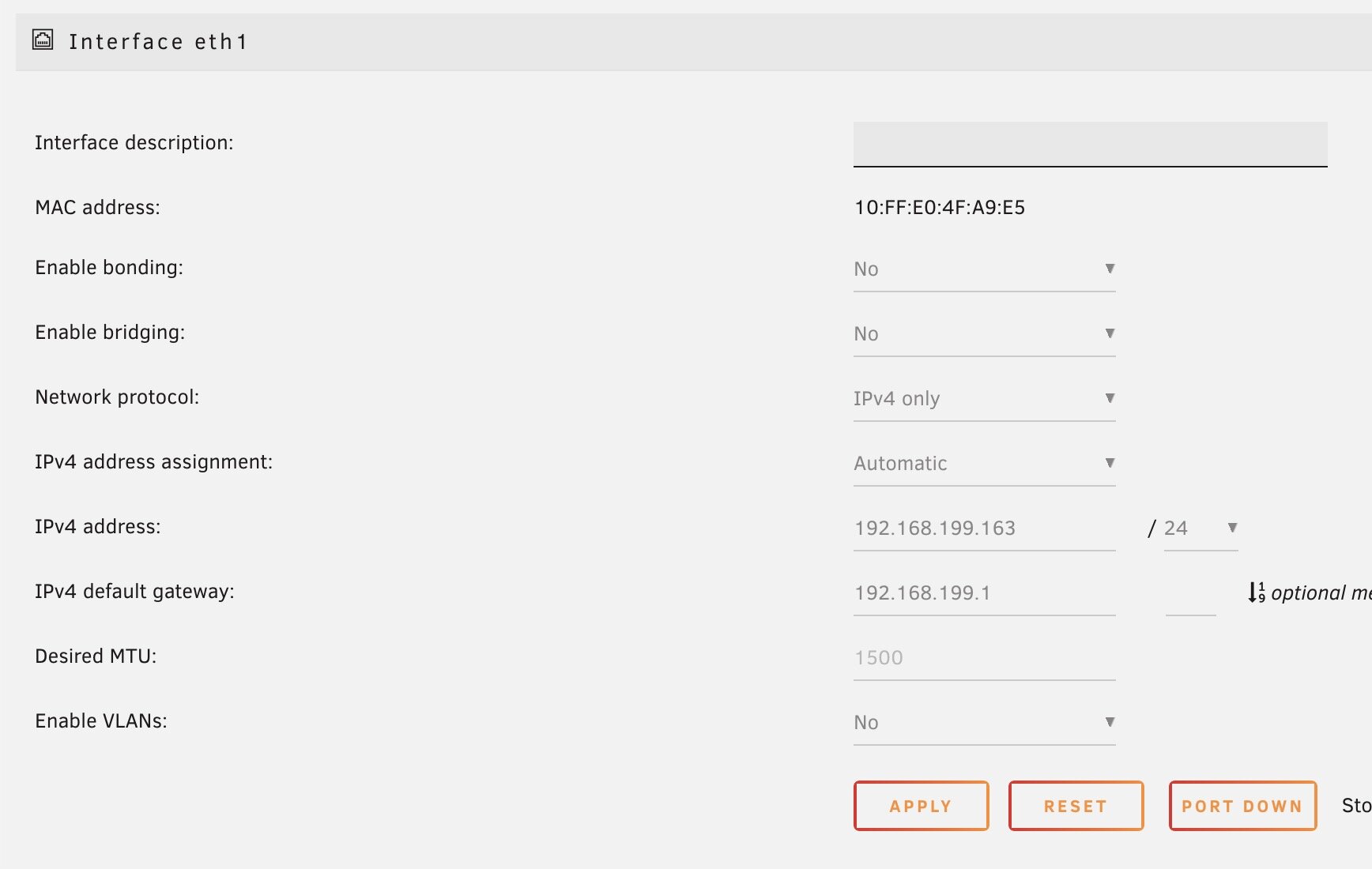

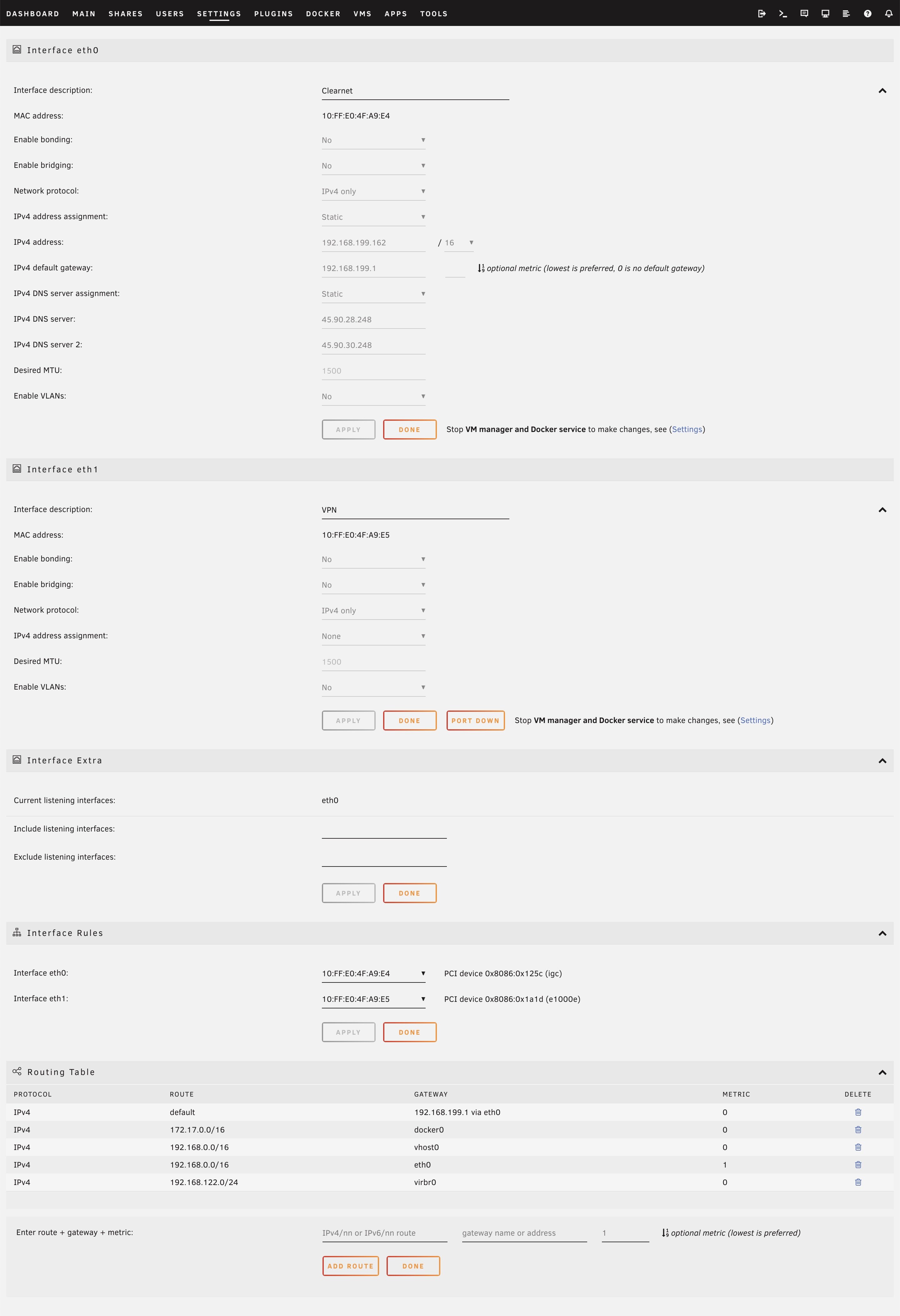

I have two physical networks, eth0 and eth1, but only eth0 is available for docker containers
Topic title says it all. I have two ethernet ports on my mobo, which show up as eth0 and eth1 on unraid. I would like some docker containers to interface with only eth0, and others to interface only with eth1, however eth1 does not show up as an option when installing new docker container. Does anyone know how to get eth1 to be an option when creating a container? Screenshots attached, thank you.

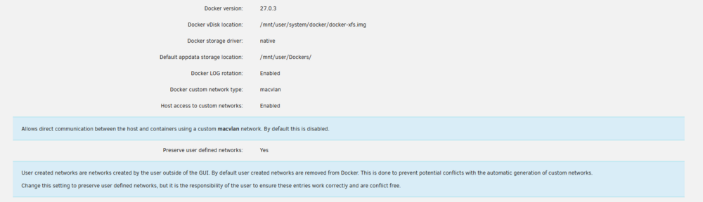

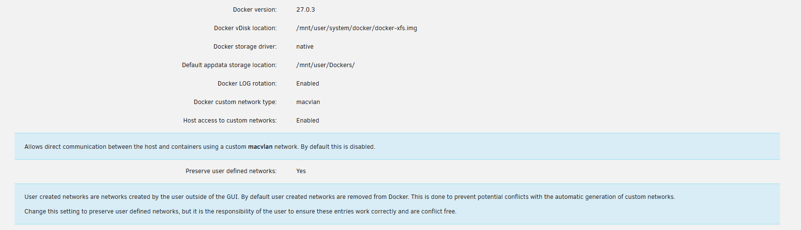

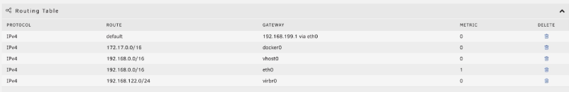

Post a screenshot from the docker settings, with advanced view enabled.
P.S. you should remove the gateway from eth1, or you can have connectivity issues, also having two NICs in the same subnet is not considered a valid config.

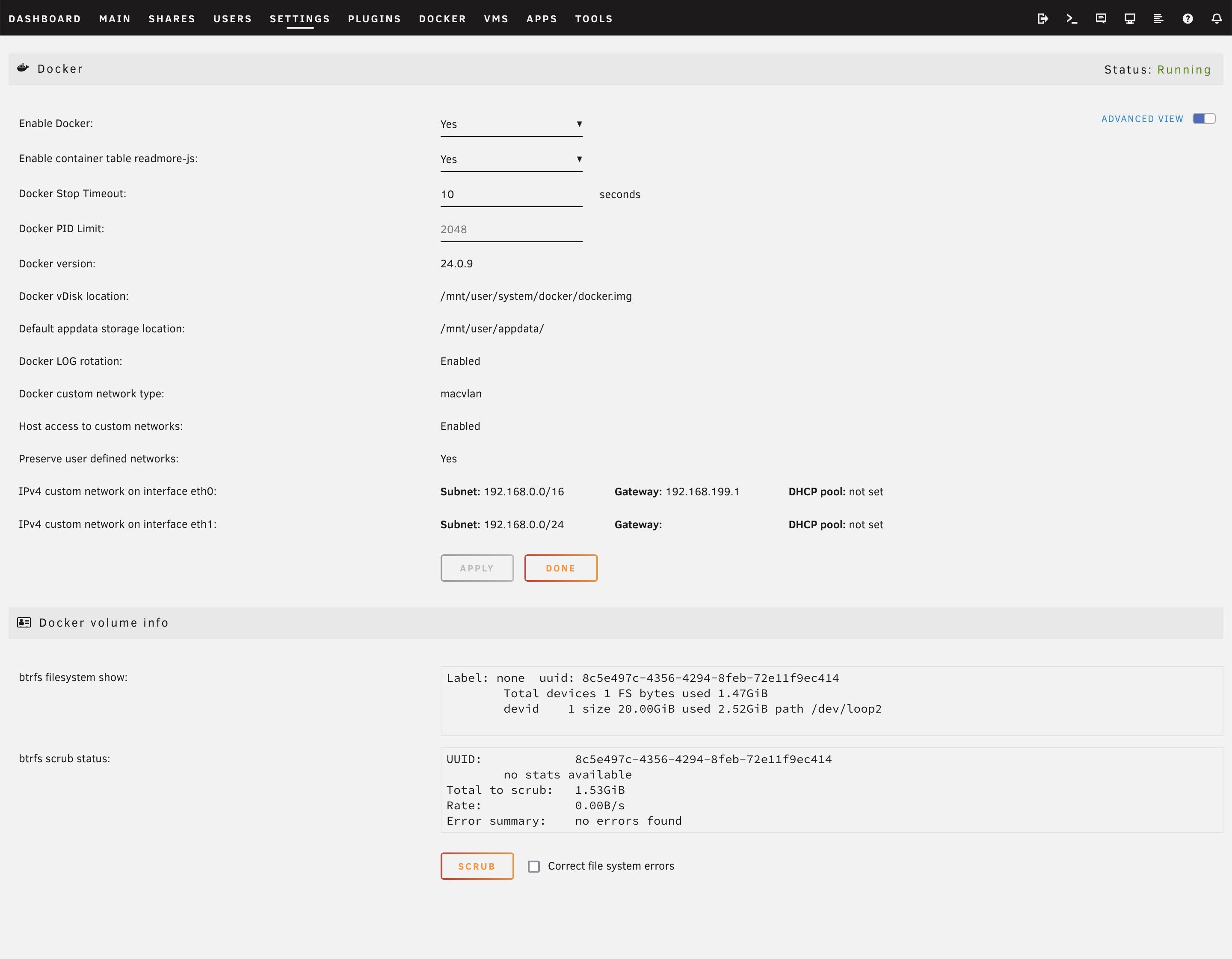

Thank you for the advice @JorgeB! I've removed the gateway from eth1, and here are my most recent networking and docker settings. I really appreciate the help.
Firefox2025-01-1514_03_58.thumb.jpeg.c5e420275a3dce2098db733bd4a336fd.jpegFirefox2025-01-1514_05_06.thumb.jpeg.d83924c5c23aa53e8a95bd43cadc3207.jpeg

since both share a ip router to eth0 and there would be a conflict by adding a similar ip route to eth1. This is why I would recommend Bond

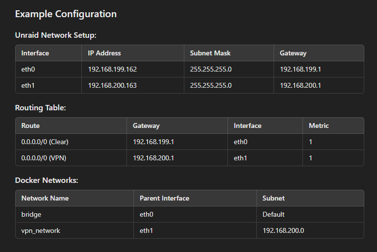

To fix the issue of routing on the same subnet (192.168.199.0/24) for eth0 and eth1 and configure Unraid to allow Docker containers to route through separate gateways (eth0 for clear internet and eth1 for the VPN), you need to perform the following:
Adjust Subnet or VLANs
Since eth0 and eth1 are currently in the same subnet, you need to separate them into different subnets or use VLANs to isolate traffic.
Option 1: Use a Different Subnet for eth1
Change the static IP of eth1 to a different subnet, such as 192.168.200.163/24.
Update your router settings to ensure 192.168.200.0/24 routes through the VPN accelerator.
Option 2: Use VLANs (if supported by your network)
Assign VLAN IDs to eth0 and eth1 to logically separate traffic on the same physical network.
Next Update Unraid Network Settings
After separating the subnets or VLANs:
Configure eth1:
Set the IPv4 address assignment for eth1 to Static.
Use the new subnet's IP (e.g., 192.168.200.163/24) and set the default gateway to your VPN accelerator.
Update Routing Table:
Ensure the route for the VPN gateway (e.g., 192.168.200.1) is associated with eth1
*This way your VPN traffic is clearly a 192.168.200.x network... and yor clearnet traffic is 192.168.199.x traffic...

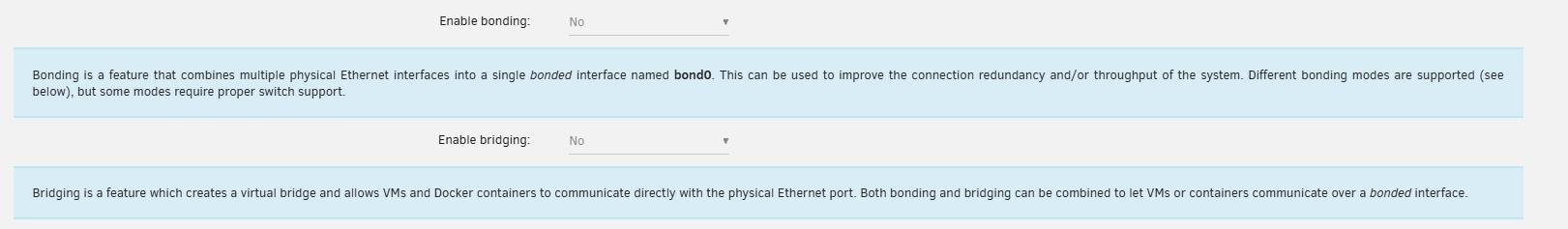

Turn off bridging turn off bonding... we will be making our own br0 network and these setting will interfere

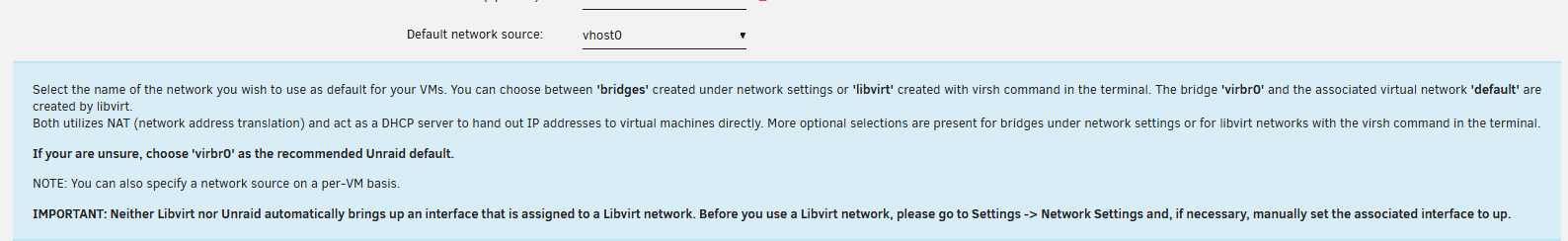

VM Settings I see that your using virbr0 we should change that to vhost... this will simplify docker and vm access to network...

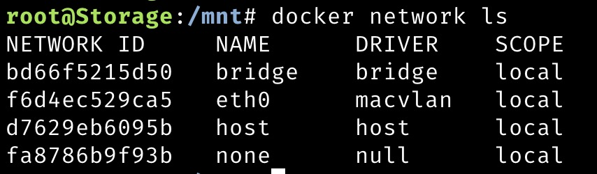

verfy docker networks:
docker network ls
in theory, using software bridges this way you can isolate and use the interface with their own subnet.
