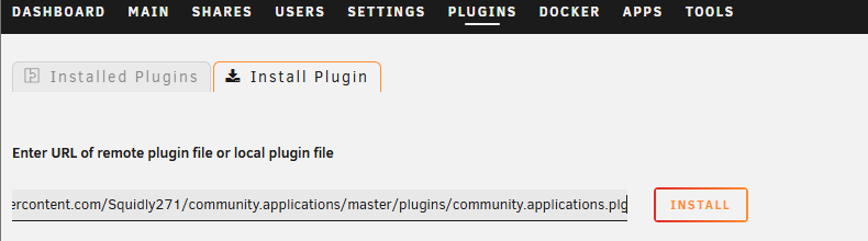

manuly update and instrall lattest:
from first post:
go to plugins and paste
https://raw.githubusercontent.com/Squidly271/community.applications/master/plugins/community.applications.plg
click install
