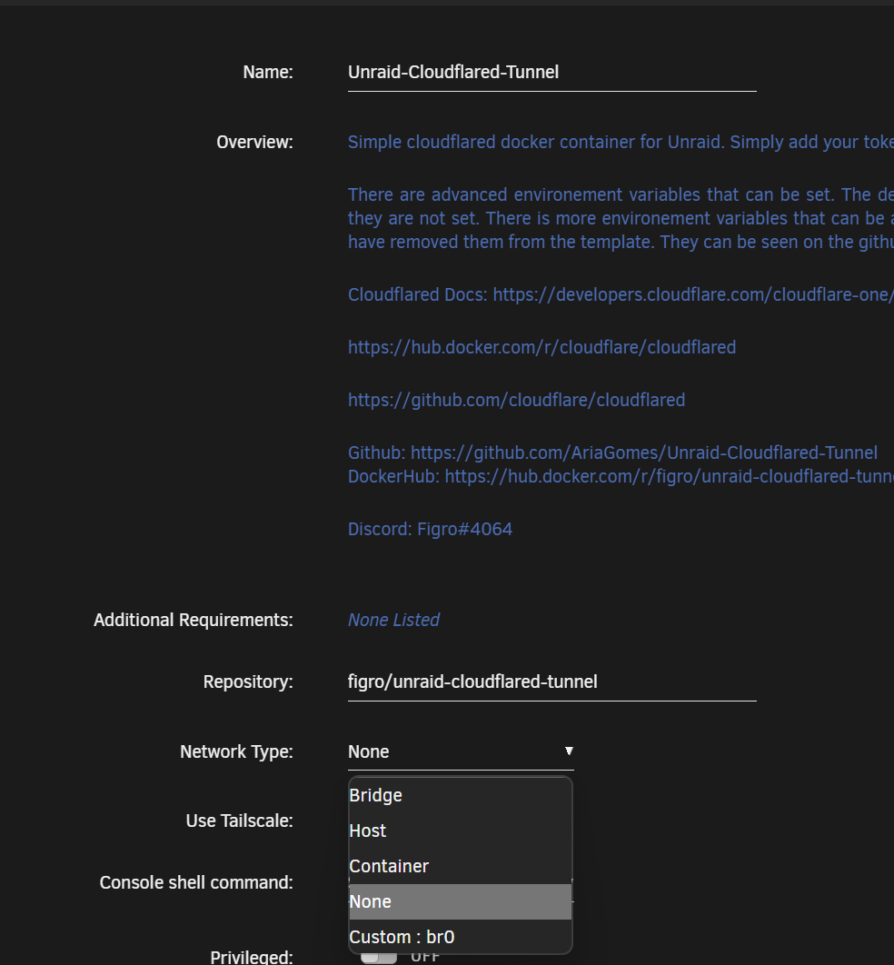

OS 7.0 Docker VLAN Bug?
Since upgrading to 7.0 I am no longer able to have a docker vlan interface with the IP address set to none and be able to use that network interface in containers. In previous versions, the Unraid host did not need an IP for Docker to allow me to use the interface on containers. Instead now I must set an IP on the host or use DHCP before Docker will allow me to use the vlan'd interface on containers.
Was this an intentional change and if so, why? I only want my Unraid host to be addressable/accessible via it's IP, not over my container or virtual machine vlans. Attached two screenshots for reference of desired configuration and how the interface does not show up on the container for use (it previously did and worked on 6.12)

your docker connection based on your post is fundamentally wrong.
Network type would need to be host not none...

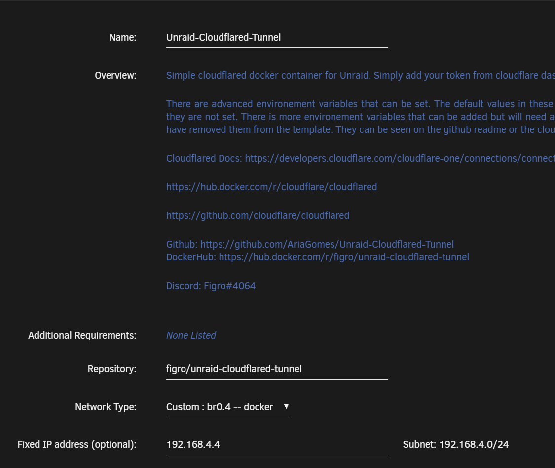

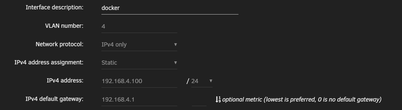

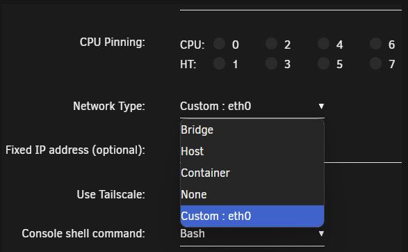

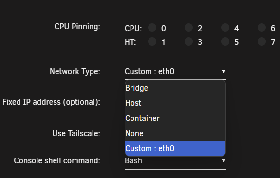

You misunderstand the post. None is not what I selected, none is what it forced to because my desired bridge is not displayed as a choice. The desired bridge interface should be br0.4 (which corresponds to vlan 4 pictured in the above screenshot). Unraid / Docker will not display this as an option unless I put an IP on the interface on the Unraid host configuration, which I absolutely do not want, and have never had to have before 7.0.
Adding screenshots of how it is forced to work in 7.0 for you.

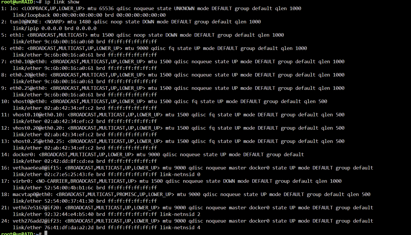

I need a output of
docker ls network
and
ip a
ip link show
as I don't think your docker network exist... even then in network settings to not specify a IP that interface would need a IP or pre knowldged on a ip for the subnet...

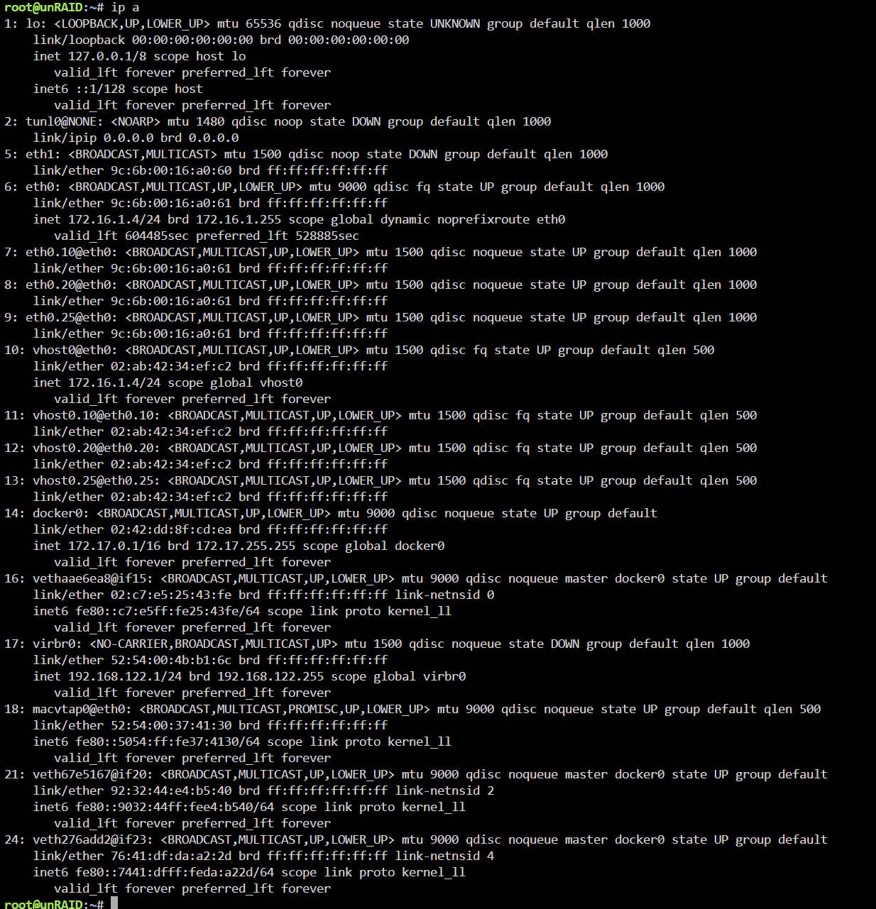

I need a output of
docker ls netwrork
and
ip a
docker ls netwrork (assuming typo should be network and a missing dash before ls) is not working. "Unable to parse logging level "s"

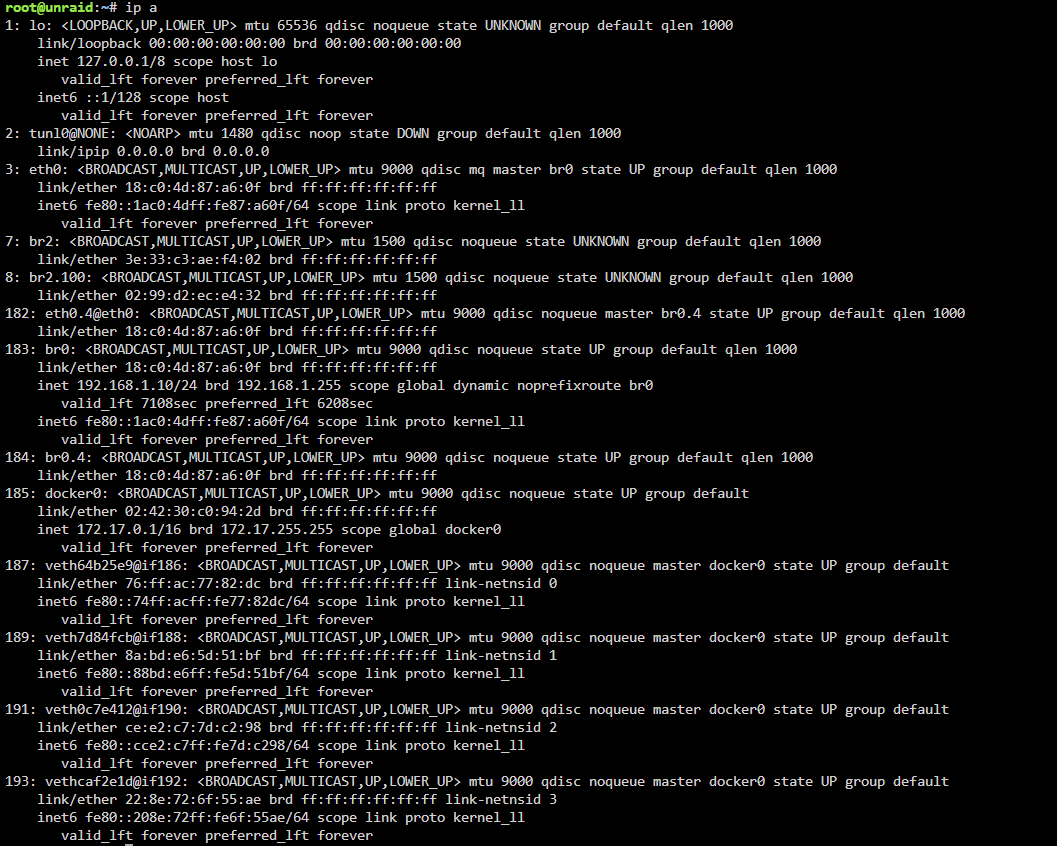

ip a is attached

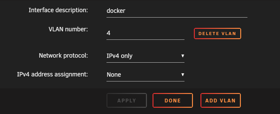

recreated interface, with IP set to none on the host, still unable to use on any containers just as before.
thx was trying to grab info unraids forum glitch on me sometimes when trying to paste pictures. and I often have to go back and reedit.
thank you for posting the IP a this confirms your vlan network is none which is what i'm looking for.

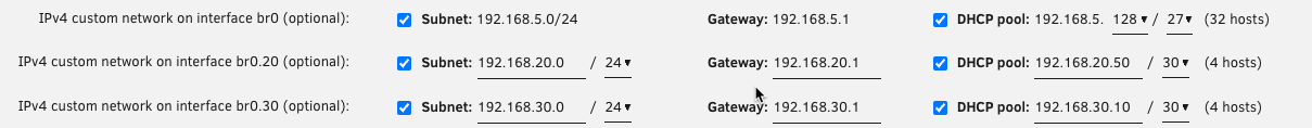

Same issue here.  I just upgraded and my docker containers that were connected to a specific VLAN are no longer are able to run.  The VLAN network is no longer available as a selection in the container configuration.
I re-created the VLAN in unraid and I noticed network route was not created when the VLAN was created.  I think it automatically was created when I set this up ages ago.  I manually created the route and it still does not work.  I do not see the option to select the VLAN under the container config.  I'm not really sure, but it seems something is broken here.
Edited by brian.cline2
comment clarity

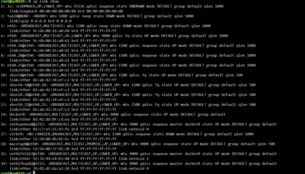

side comands that a diag wont capture
current docker networks
docker network ls
current listed interfaces
ip a
ip link show
Potent picture of your current network routes per unraid web ui...

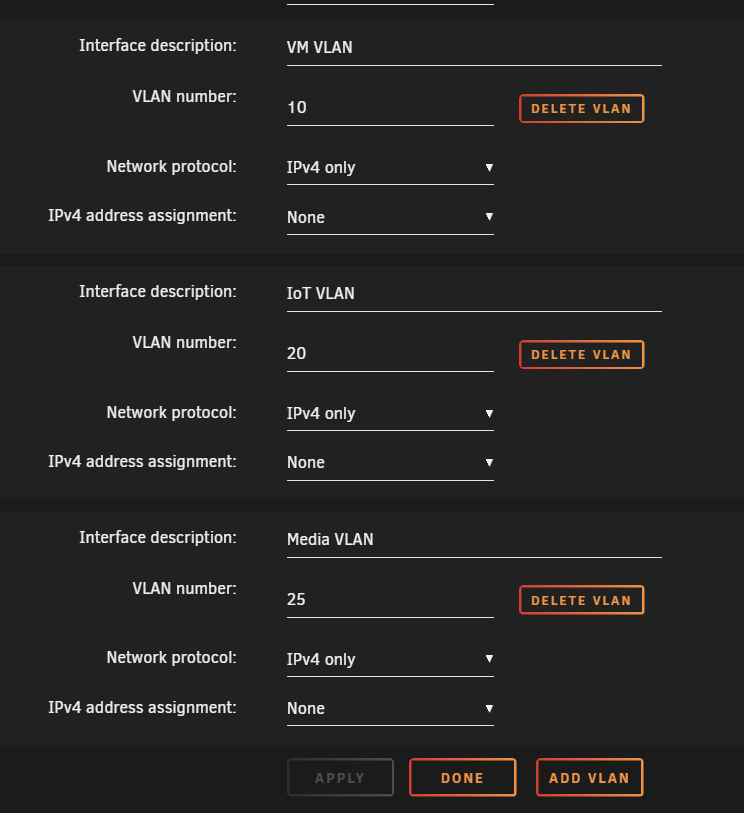

Same issue, only using ipv4. No changes made other than the version 7.0 upgrade.

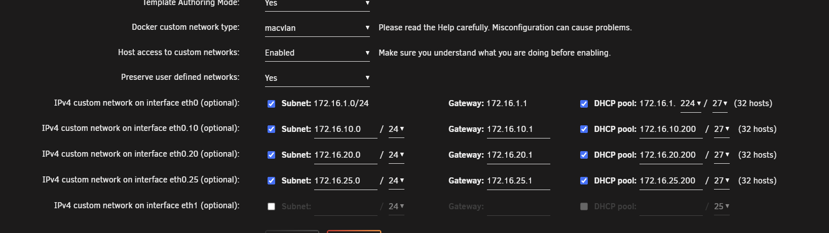

Thank you for the additional data...
Would still need to know other docker settings. as it appear you need to make the docker networks again...

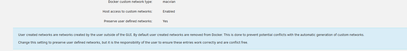

you really need to have the presve user defined networks enabled! ...
As again I don't think you had that setting enabled before the upgrade thus the docker db and network data was wiped...
to fix this, enable that setting for future updates to not break again. and remake your docker networks.
Per your picture that setting seems to be enabled. per other data, you have interface with vlans corectly.
the defualt custom eth in the picture is vlan1
to make a docker network and use the subnet on a vlan you need to make a docker network.
since your network settings are bridging off and bonding off (same as me). you need to make a docker interface with the parent and tell dockers to use that network.
as per picture:
don't have a docker netwokr only eth0 gets a defuaut docker network...
to fix this make docker network:
# VLAN 10: Subnet 172.16.10.0/24, Gateway 172.16.10.1
docker network create \
  --driver macvlan \
  --subnet=172.16.10.0/24 \
  --gateway=172.16.10.1 \
  -o parent=eth0.10 \
  macvlan_vlan10
# VLAN 20: Subnet 172.16.20.0/24, Gateway 172.16.20.1
  --driver macvlan \
  --subnet=172.16.20.0/24 \
  --gateway=172.16.20.1 \
  -o parent=eth0.20 \
  macvlan_vlan20
# VLAN 25: Subnet 172.16.25.0/24, Gateway 172.16.25.1
  --driver macvlan \
  --subnet=172.16.25.0/24 \
  --gateway=172.16.25.1 \
  -o parent=eth0.25 \
  macvlan_vlan25
run the above command then edit the docker and you will see macvlan_vlan## and select that if you want that docker on that vlan.
thats it.
I don't know what failed, what setting, or if you had previous docker corruption that is fixed or reset with the upgrade. but in my testing it involved around the docker setting preserver user defined... which is why I recommend upgrading to 6 stable then 7... as some setting were not introduced from 6.9 due to the macvlan bug...

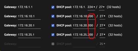

I think the issue is that v7 is not accepting non stander CIDR subnets for VLANs:
Please retest with 0 as the last digit.

I can confirm that yes you had teh option preserver and that the upgrade ignroed that option. the question is why. was there a docker config conflict or check that your current configuration failed
8 minutes ago, bmartino1 said:
Having older flash backs as this is the docker config file located under teh config folcer on the flash drive
My current config
root@BMM-Unraid:/boot/config# cat docker.cfg
DOCKER_ENABLED="yes"
DOCKER_IMAGE_FILE="/mnt/user/system/docker/docker-xfs.img"
DOCKER_IMAGE_SIZE="500"
DOCKER_APP_CONFIG_PATH="/mnt/user/Dockers/"
DOCKER_APP_UNRAID_PATH=""
DOCKER_READMORE="yes"
DOCKER_PID_LIMIT=""
DOCKER_CUSTOM_NETWORKS=" "
DOCKER_TIMEOUT="10"
DOCKER_LOG_ROTATION="yes"
DOCKER_LOG_SIZE="1g"
DOCKER_LOG_FILES="1"
DOCKER_AUTHORING_MODE="yes"
DOCKER_ALLOW_ACCESS="yes"
DOCKER_USER_NETWORKS="preserve"
DOCKER_IMAGE_TYPE="xfs"
DOCKER_BACKINGFS="native"
as my oldest rc 7 beta 1
root@BMM-Unraid:/mnt/user/Users/Elliott# cat docker.cfg
DOCKER_IMAGE_SIZE="100"
DOCKER_APP_CONFIG_PATH="/mnt/user/appdata/"
DOCKER_TIMEOUT="10"
*No vlans as this is the one i have access too to show the preserve option is set.
I only have a month of daily backups so the docker.cfg files are identical to the one I posted since it was modified in September of 2024. Also, I was updating from 6.12.14 if that's helpful.
12 hours ago, dchadd said:
DOCKER_RANGE_ETH0_25="172.16.25.200/27"
This is the problem, see the recent note added to the release notes:
Sorry for being dumb here, but "fix the CIDR" how?
I believe he is saying since we were using a non-standard CIDR you need to switch the last digit of the DHCP range to a 0. For instance for 192.168.20.50 would switch to 192.168.20.0.
Edited by dchadd
I'll give it a shot and see what happens.  Thanks for the suggestion 👍
@dchadd, that did it.  My VLANs are back and selectable now.  Thanks for the suggestion!!
Yes, thanks, you can only use standard subnets, ending in 0, for both the subnets and the DHCP pools.
