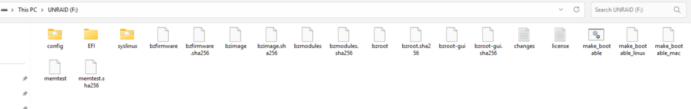

Nope, no folder listed as 'efi-'
See attached screenshot.image.thumb.png.c1450001614126501fc853971f613520.png
Ok, so EFI is already activated.
