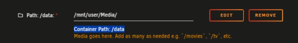

a lot here so lets first start with some basics.
Regarding #3 with plex on (as this sounds and seems like the culprit.
I set up container path under name /TV Shows. I assume path name doesn't change just because host path is /mnt/remotes/......?
Console the plex docker and cd into the template path you shared that connect to the /mnt/remotes/TOWER3_Media3/TV SHOWS/
if you don't see TV Shows/Series name/Season 1>media.mp4/mkv/avi etc...
Then you have issues with the remote and volume mounts. and may need to adjust your plex system.
My guess is that somehow the template path mounted something else and tv shows is not in the plex path provided over the share.

#3 plex docker can read write the path sent in via the docker template... confirm you see file and folder within the docker...

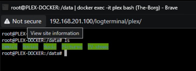

We need to make sure the plex docker when in the docker is seeing the folder and files at the remote mount paths...
Please confirm if this is shared via SMB / NFS...

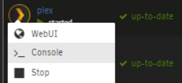

Please confimr in the plex docker, console into it and cd to the template path
cd /data
ls
depenign on the plex container path set in the docker template.

What I'm refering too is:
confirming your plex container path and mount path for the /mnt/remote
In my case I want to confirm plex docker can see the folder and files.
I'm referring you to enter console fo plex. a terminal windows as if you are on the local machine at a CMD promt for plex:
then cd into the path. in my case this is /data
and make sure the folder and files are there.
then we can look at plex and the library options to sync the content.
