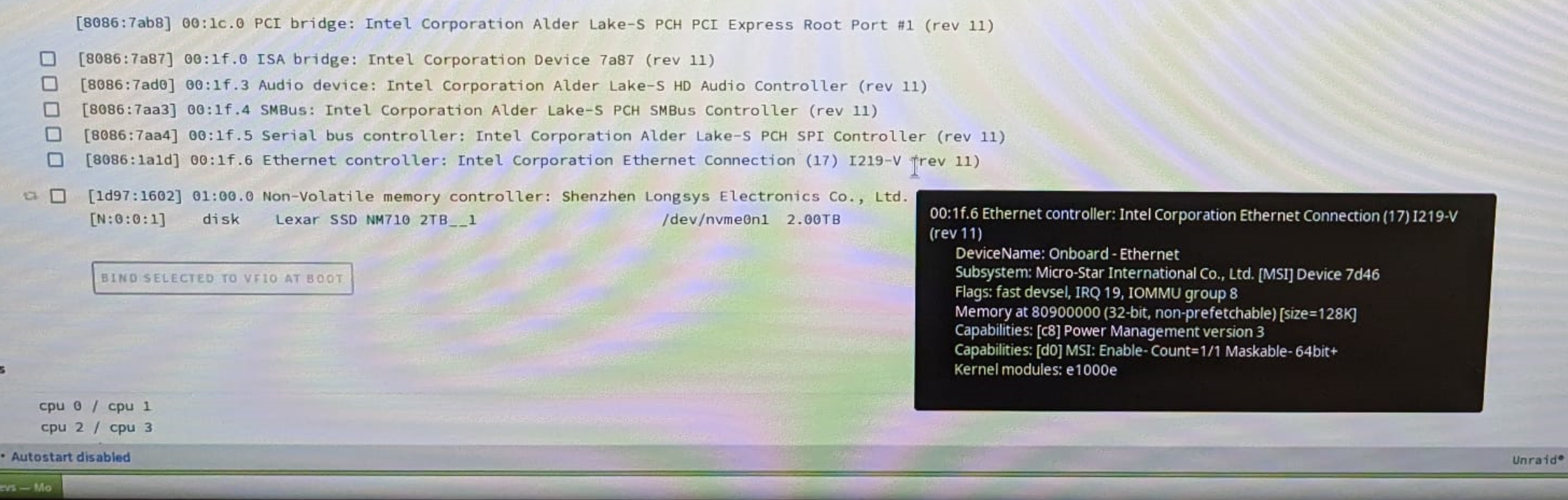

I ran Unraid in GUI mode and confirmed it is picking up the ethernet controller.

Jan 12 10:41:22 Nexus kernel: e1000e 0000:00:1f.6: The NVM Checksum Is Not Valid
Jan 12 10:41:22 Nexus kernel: e1000e: probe of 0000:00:1f.6 failed with error -5
NIC is detected but failing to initialize due to that error, try Googling it
Thanks for the suggestion, however I ended up purchasing and installing a relatively cheap 2.5G PCIe NIC (TP-Link TX201).
Unraid detected it without problems and its working great.
Marking this as solved.
