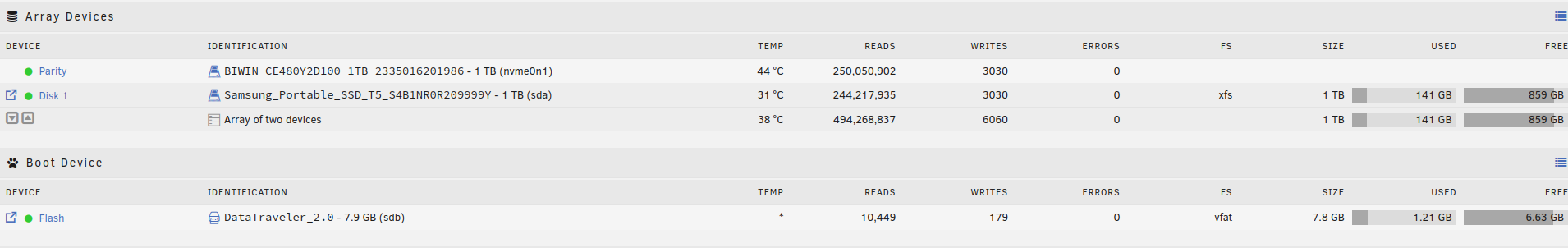

I've updated from 6.12.10 if I remember correctly. My 2 x 1TB SSDs should actually be an array of two devices:
I also remember that my USB Boot Device showed up as not connected after update.

I don't understand why you said this since the array is all you expected to have.
By the way, SSDs in the array cannot be trimmed.
They are an array of two devices, and since there are no pools this is normal:
