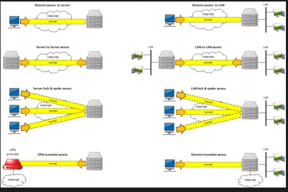

I need you network layout:
ISP > Router > switch > unraid
and what type of wireguard VPN your tying to setup...
?site to site?
server host?
etc...
read the docs:
https://docs.unraid.net/unraid-os/manual/security/vpn/
