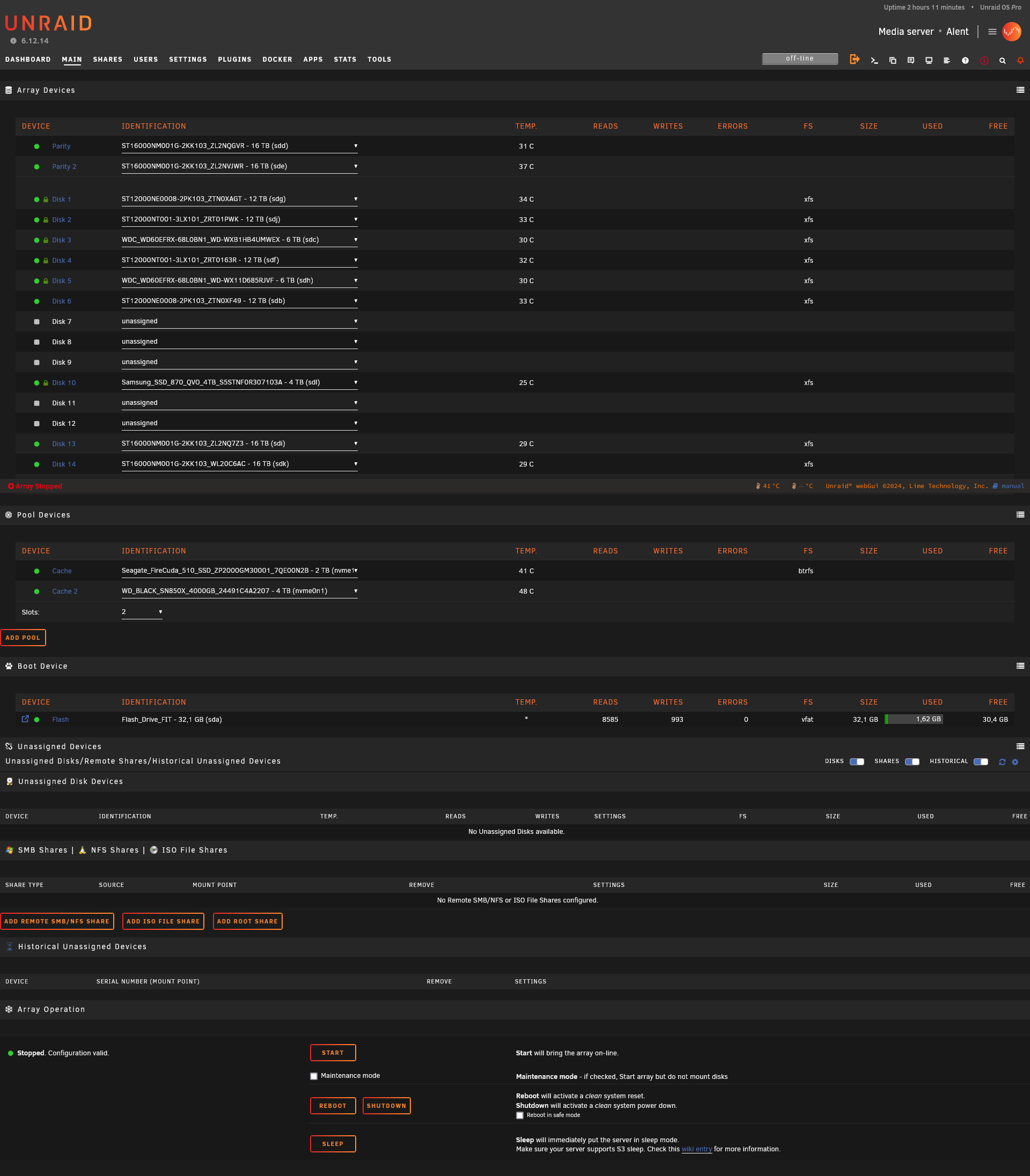

I have just done something very stupid.
I deselected the 4TB as Unassigned under “Main”.
Then I selected “Array” under “Tools>New Config” under “Preserve current assignments:” and clicked Apply.
Unfortunately, I clicked too quickly. Can I undo this?

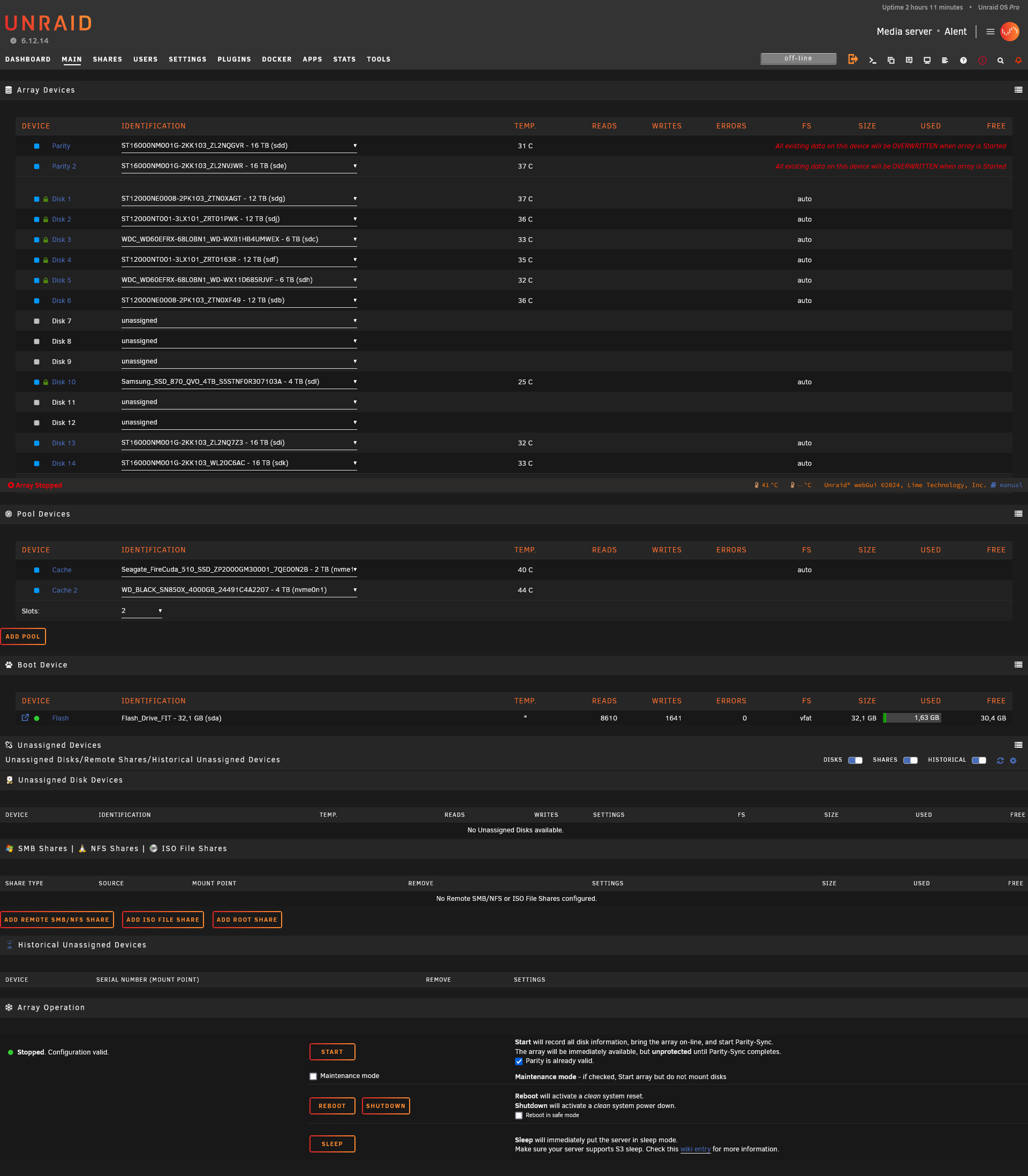

I still have my exact assignments in an Excel file. I have reassigned these accordingly.
But what is the next step?
Can I just start the array and have to create the parity again?
Can I remove the 4TB SDD from the Cache pool at the same time?
Edited by AceBurn90

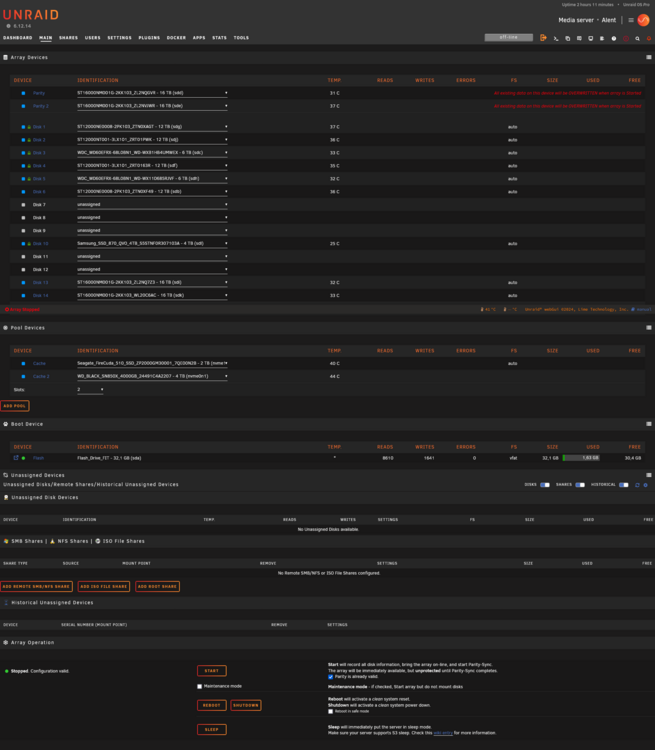

If the array assignments are the same as before, you can check "parity is already valid" before array start, but you must start the array once before trying to remove the pool device.
Thanks for your help.
Looks good. Everything seems to be working.
