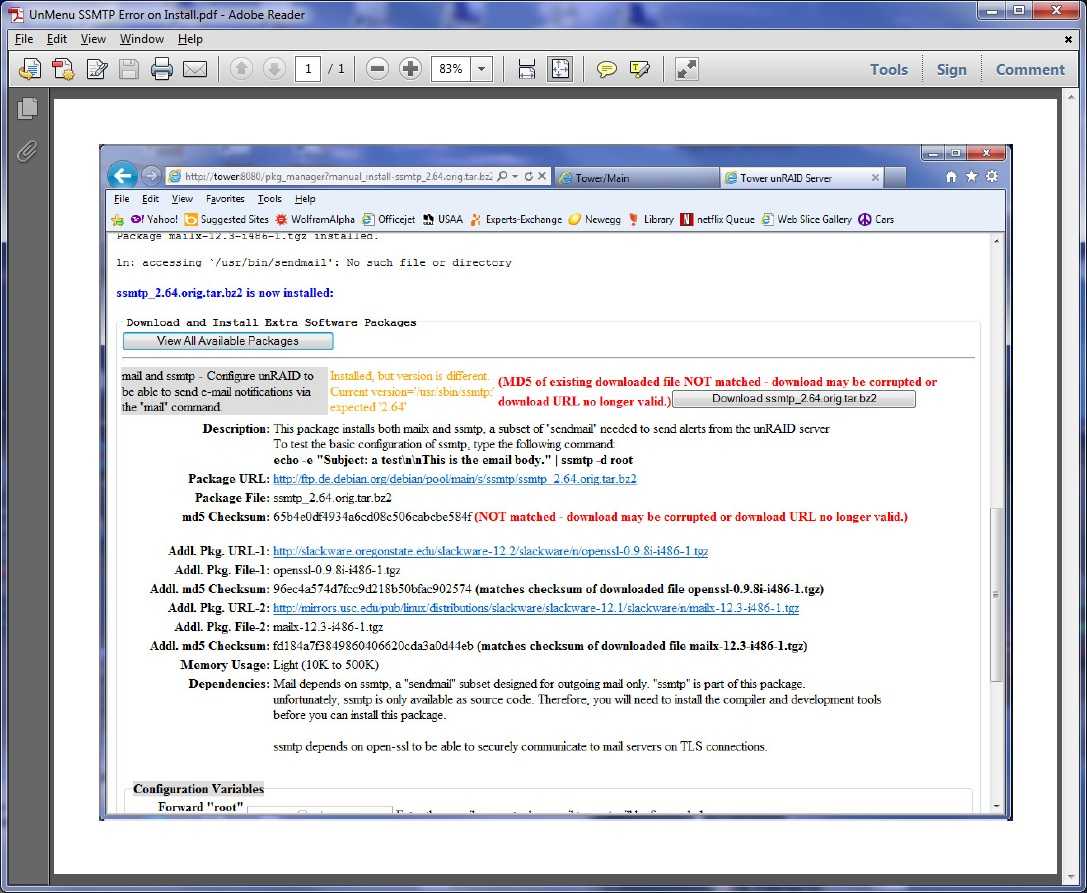

I also have this problem though it says version expected 2.64
Installed, but version is different.
Current version='/usr/sbin/ssmtp:' expected '2.64'
How do i fix this in laymans terms? how exactly do i istall this fix? where do i put the file? I have absolutly no idea how to use tenet/putty and such except for the tutorial in the wiki
  • 4 weeks later...
I'm getting the exact same error -- as you can see in the attached file.
Using the latest version of UnMenu ... with the replacement .conf file mentioned earlier in this thread.
I'm at a loss as to how to get SSMTP to install correctly.
[it's also not at all clear exactly what the Configuration Variables need to be -- but that's a lot easier to "play" (i.e. experiment) with after the package actually gets loaded.

Executing install script for gcc-4.2.4-i486-1.tgz.
Package gcc-4.2.4-i486-1.tgz installed.
Verifying package glibc-2.7-i486-17.tgz.
gzip: stdin: unexpected end of file
Unable to install glibc-2.7-i486-17.tgz:  tar archive is corrupt (tar returned error code 2)
Verifying package binutils-2.18.50.0.9-i486-1.tgz.
Installing package binutils-2.18.50.0.9-i486-1.tgz:
PACKAGE DESCRIPTION:
# binutils (GNU binary development tools)
# Binutils is a collection of binary utilities.  It includes "as" (the
# portable GNU assembler), "ld" (the GNU linker), and other utilities
# for creating and working with binary programs.
# These utilities are REQUIRED to compile C, C++, Objective-C, Fortran,
# and most other programming languages.
Executing install script for binutils-2.18.50.0.9-i486-1.tgz.
Package binutils-2.18.50.0.9-i486-1.tgz installed.
Verifying package make-3.81-i486-1.tgz.
Installing package make-3.81-i486-1.tgz:
# make (GNU make utility to maintain groups of programs)
# This is the GNU implementation of make, which was written by Richard
# Stallman and Roland McGrath.  The purpose of the make utility is to
# determine automatically which pieces of a large program need to be
# recompiled, and issue the commands to recompile them.
# This is needed to compile just about any major C program, including
# the Linux kernel.
Executing install script for make-3.81-i486-1.tgz.
Package make-3.81-i486-1.tgz installed.
Verifying package cxxlibs-6.0.9-i486-1.tgz.
Installing package cxxlibs-6.0.9-i486-1.tgz:
# cxxlibs (C++ shared library compatibility package)
# This package contains the shared libraries needed to run dynamically
# linked C++ binaries linked with older versions of libstdc++.
Executing install script for cxxlibs-6.0.9-i486-1.tgz.
Package cxxlibs-6.0.9-i486-1.tgz installed.
Verifying package kernel-headers-2.6.27.7_smp-x86-1.tgz.
Installing package kernel-headers-2.6.27.7_smp-x86-1.tgz:
# kernel-headers (Linux kernel include files)
# These are the include files from the Linux kernel.
# You'll need these to compile most system software for Linux.
Executing install script for kernel-headers-2.6.27.7_smp-x86-1.tgz.
Package kernel-headers-2.6.27.7_smp-x86-1.tgz installed.
deleted the glibc file and just fetched it myself now.
root@Tower:/boot/packages# wget http://slackware.oregonstate.edu/slackware-12.2/slackware/l/glibc-2.7-i486-17.tgz
--2013-02-25 14:24:30--  http://slackware.oregonstate.edu/slackware-12.2/slackware/l/glibc-2.7-i486-17.tgz
Resolving slackware.oregonstate.edu (slackware.oregonstate.edu)... 64.50.233.100, 64.50.236.52
Connecting to slackware.oregonstate.edu (slackware.oregonstate.edu)|64.50.233.100|:80... connected.
HTTP request sent, awaiting response... 200 OK
Length: 29688052 (28M) [application/x-gzip]
Saving to: `glibc-2.7-i486-17.tgz'
100%[========================================================================================================================================>] 29,688,052  8.96M/s   in 3.6s
2013-02-25 14:24:33 (7.81 MB/s) - `glibc-2.7-i486-17.tgz' saved [29688052/29688052]
installed the glibc package myself without any problems:
root@Tower:/boot/packages# installpkg glibc-2.7-i486-17.tgz
Installing package glibc-2.7-i486-17.tgz:
# glibc (GNU C libraries)
# This package contains the GNU C libraries and header files.  The GNU
# C library was written originally by Roland McGrath, and is currently
# maintained by Ulrich Drepper.  Some parts of the library were
# contributed or worked on by other people.
# You'll need this package to compile programs.
Executing install script for glibc-2.7-i486-17.tgz.
Package glibc-2.7-i486-17.tgz installed.
then tried to reinstall the gcc package via unmenu... worked fine. tried ssmtp again.. worked fine now.
