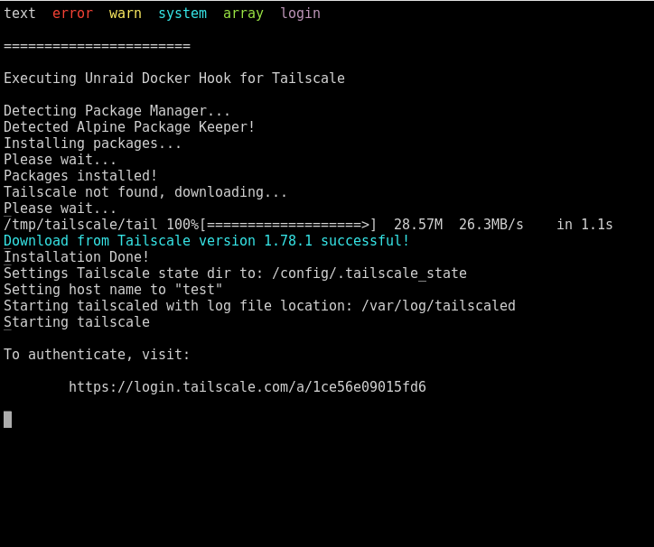

EDIT: I just tried FreePBX and it seems to work just fine:
I assume for Caddy v2 you are trying to run it with Tailscale Serve correct? If that is the case you have to disable port 443 in Caddy v2 since Tailscale Serve is using that port already, you can of course change that but I'm not sure if that's what you want if your goal is to route everything through Tailscale.

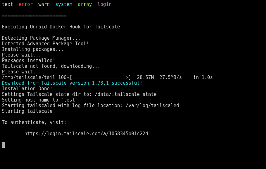

For me it also starts fine, here is the log:

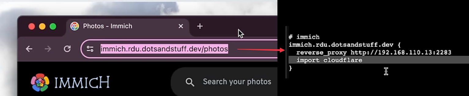

Ah now I get it!
Please look at the Caddyfile from Alex here, as you can see he doesn't have ports 8080 and 8443 in his Caddyfile because he all routes that through Tailscale but he uses Cloudflare for his public DNS records but keep in mind that these domains will not be accessible from the outside only if you share it out to someone that has Tailscale installed and you have shared your machines (and of course in your Tailnet it will work too).
So to speak you could use your (purchased) domain name from everywhere in the world but only if you are connected to your Tailnet, this means your public FQDNs will be forwarded to your Tailnet.
I hope you understand what I mean, this is a bit complicated to explain or I did a bad job at explaining.
2 minutes ago, ich777 said:
Ah now I get it!

I assumes as he is able to use the below url and the caddyfile, it answers correctly on port 80 in his example?
Nope, that's not how that works.
Cloudflare is translating his DNS into his Tailscale IP/Domain and then you are basically connecting through the Tailscale IP/Domain.
This method that he uses here never connects through the servers port it just connects through your Tailscale IP/Domains.
