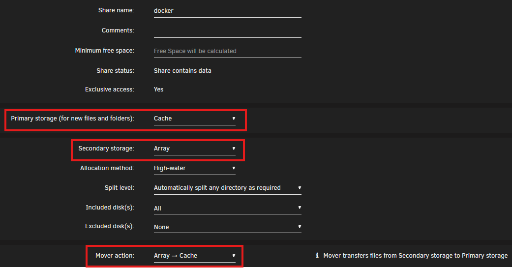

From the settings menu, making sure both the docker and vm services are entirely disabled, then set the following settings for each of the shares:
Pay extra attention to the mover action field, notice that the Array points to the Cache and not the other way around, this is important as that is how the data is moved when mover runs. If you set it to "Cache -> Array" the data would be moved to the Array disks and not to the cache.
Once you've done this for each share you want to have data moved to cache, run mover. Also note that mover will not move files if a duplicate file exists on the destination.  Mover also does not move files in use either.
