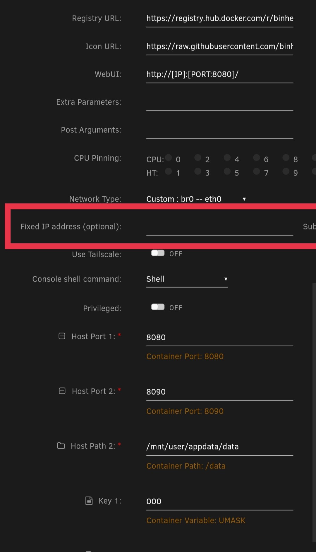

If you want your containers to have a different address than your host you can either assign it in the optional spot (if already built in) or got to the container console and run ifconfig.  You should find the Mac address in there that you can use to configure your DHCP server.
If you attach diagnostics some more info can likely be found by some of the pros that hang out on these forums.
If you console into the container and do ifconfig there, you will see the mac address that unRAID gave it.  With that mac, you should be able to configure your DHCP server to assign your chosen IP to it (the mac).
The easiest is to assign your IP address manually though. IMG_20250116_020147.thumb.jpg.b4e153de2324763cfff59c7c6608ae2a.jpg

In the image it shows network type is custom: bond0
Can you change that to read something more like custom br0 - eth0?
I can change it back.
