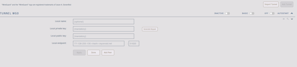

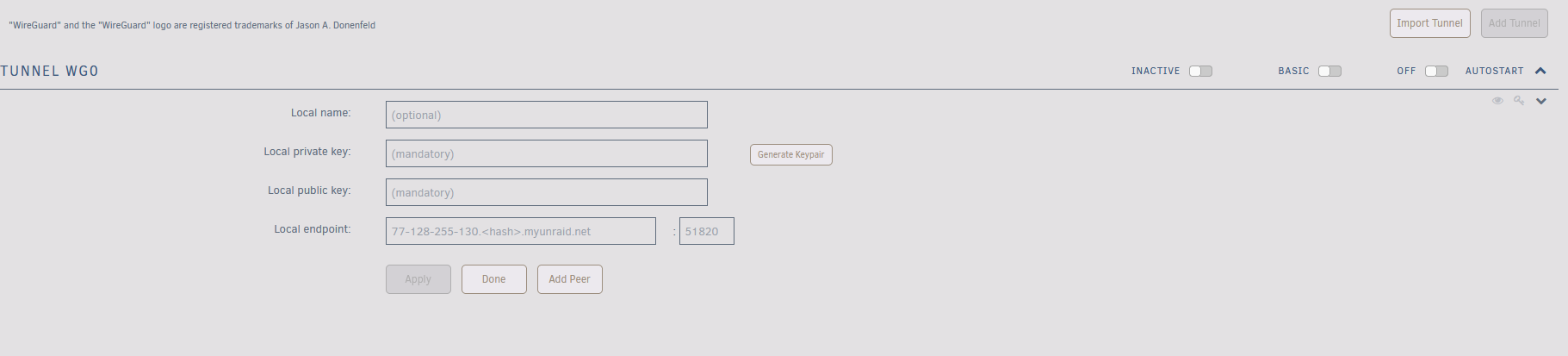

If you have a WireGuard tunnel configured, try removing it.
I removed the wireguard tunnel but I still have the same messages in the logs
Do I need to reboot ?
Try that.
Rebooted one hour ago, no logs anymore
Thanks
