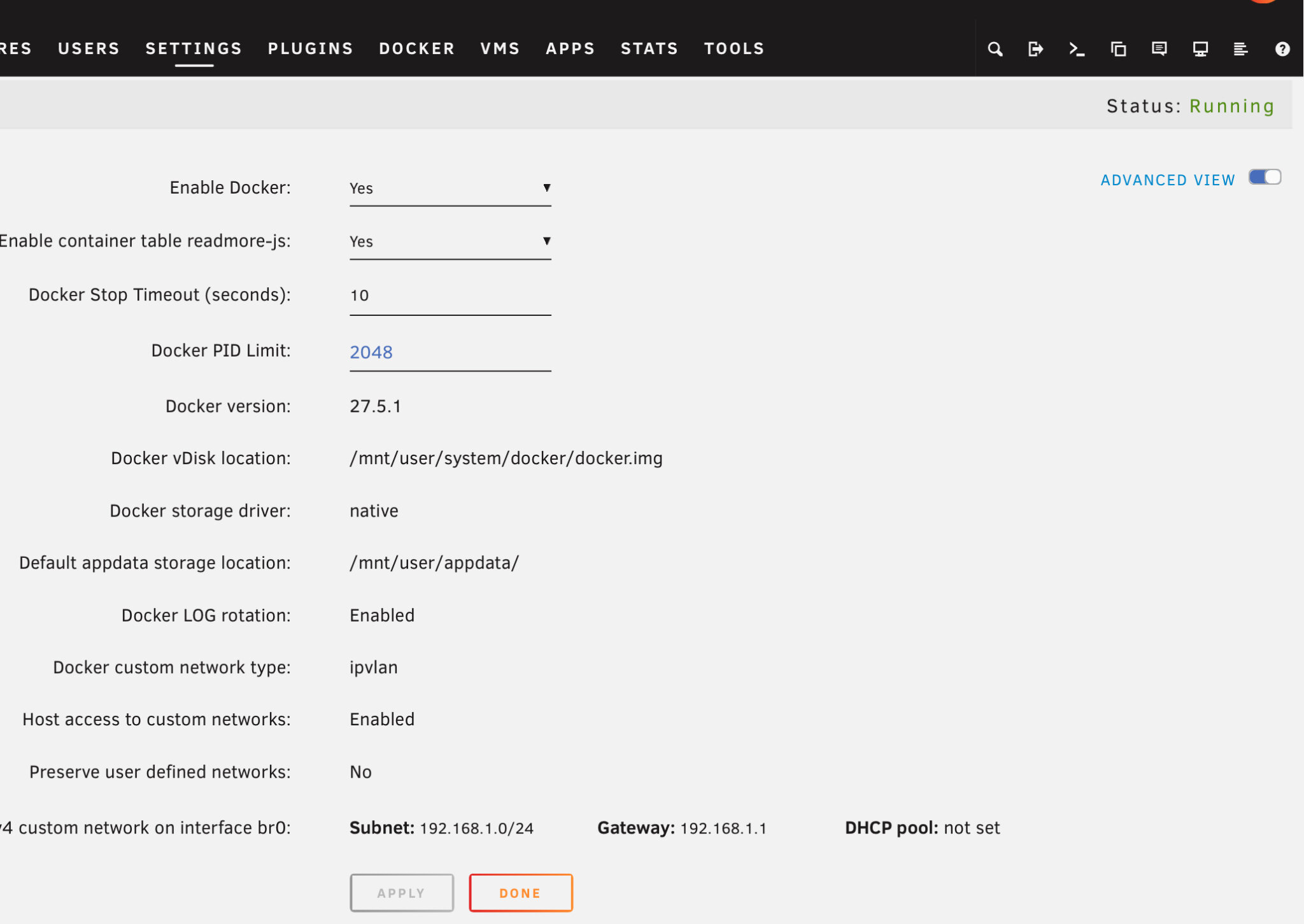

Right, I have solved the issue on my server anyway.  I decided to disable docker in settings, and my server then appeared on my windows network. So then obviously a problem with the docker settings. I had to disable (Host access to custom networks) and now I can see my server on my windows network. Everything seems to be working as normal with this disabled.

Thanks, can you confirm if you also have Host access to custom networks enabled in Docker?
Confirmed
I rolled back then updated to the stable 7.0.1 version. and made sure (Host access to custom networks) was disabled as in my last post. i can confirm that everything is functioning normally and I can see my server in windows Network panel.

I did test with 7.1.0-beta.1, and I had to disable (Host access to custom networks) in docker settings for my server to appear on windows network.

I'll try turning off the docker option of host access and see if that fixes it but that may not be a long term solution if it breaks other functionality with my containers (I have no memory over whether it was needed for any of my containers or custom networks).

The easiest way to resolve this is usually to disable "Host access to custom networks", if enabled and not really needed.

Unraid does appear in the Network tab while "Host access to custom networks" enabled.
