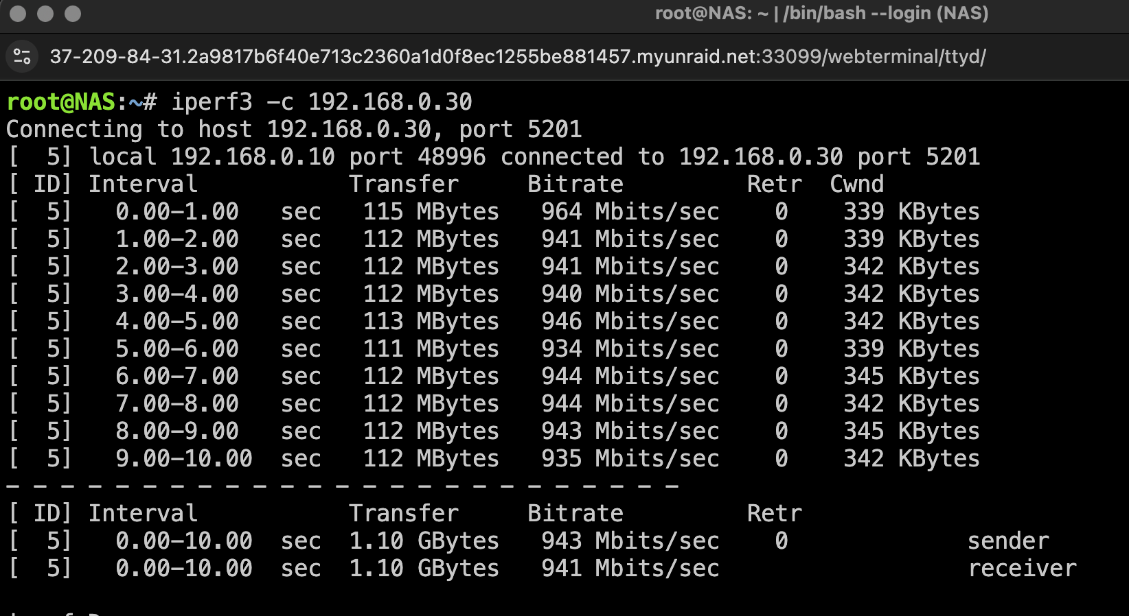

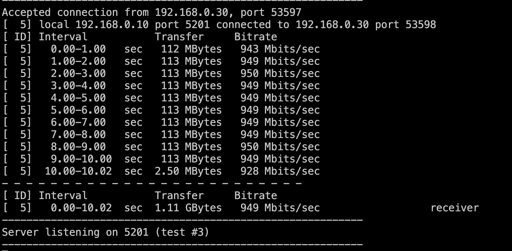

I though write speed was the problem, run a single stream iperf test in both directions and post the results.
My first thoughts with plugins seems wrong. i am not sure why my transfer speed is so slow
Networks seems good

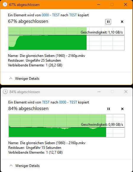

Something must be different in unraid 7 compared with unraid 6...
I did a test with a 83GB file and its always the same.
When copied from Windows 11 to unraid, it always starts with ~150-200MB/sek
After a longer periode it went up to 1100MB/sek.
On some smaller files, it never reaches more then ~450MB/sek.
On the old v6 it started immediately with the full speed.
The other direction (from unraid to windows) is almost like normal...
On unraid v6 i had ~1000MB/sek and on v7 its slightly under 1000MB/Sek.
