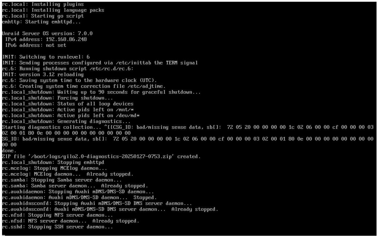

So finally had to do a reboot as plex stopped working...... I had no consoles open and I got the below during shut down.
This pool was the problem:
Jan 27 07:53:23 Gilo2 emhttpd: shcmd (5569140): /usr/sbin/zpool export -f docker
Jan 27 07:53:23 Gilo2 root: cannot unmount '/mnt/docker/zfs-system': pool or dataset is busy
Okay so this is my docker pool that i run all my containers from and any other system bits, i only rebooted as Plex had hung been having an issue with it for a little while now . It basically crashes but states it is running then i try and reboot the container but get a system error pop up. I have tried deleting the container and recreating it but this dosnt seem to resolve it mainly happens after it has been updated.
That may be the one causing the problem.
