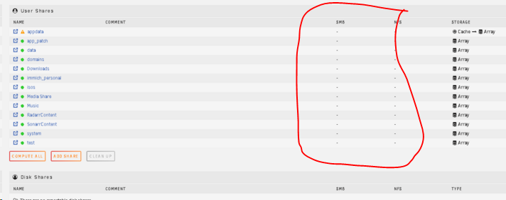

I can see my shares on the system but with all the SMB settings turned on they won't show on my machine when I connect.
here you see my flash I've made public jus to see something and the other shares in the background that are all there and visible.

Regarding the shares first, are you exporting them? The screenshot you posted has that info covered, post a new one showing the full shares page.
Hi Jorge,
Not sure what you mean by exporting them. That screenshot is the full shares page. here's a new image of the shares page zoomed out slightly to show nothing else on the same pageimage.thumb.png.b7751d389b214f41958e26a61af0c216.png
unless, apologies do you want this page e.g. the details of the share (this one is appdata when i click on it)
If you look in the SMB Security Settings you seem to have Export set to No.    this means the share is not set to be visible on the network.
This part here shows that none of the shares are being exported, since some time ago, they are not exported by default, so you just need to toggle export to yes, for the shares you want to access over SMB only:
ok thank you @JorgeB and @itimpi
the SMB issue I see now is fixed. ei totally missed the export option I thought that meant something else, not sure why. I can now see exported shares over SMB.
