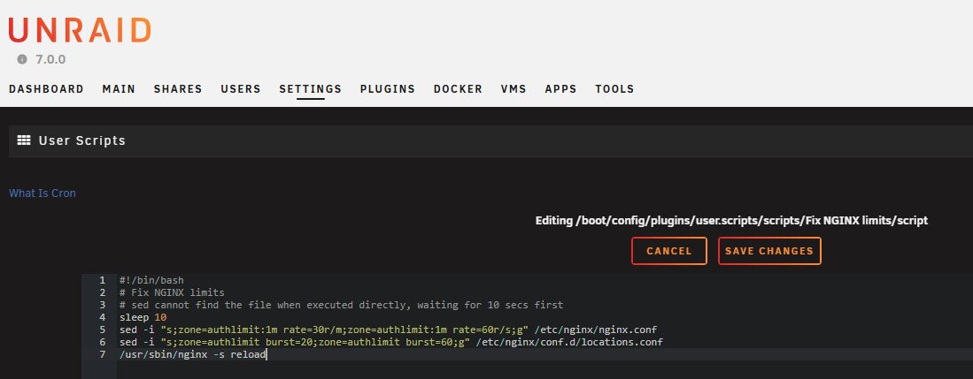

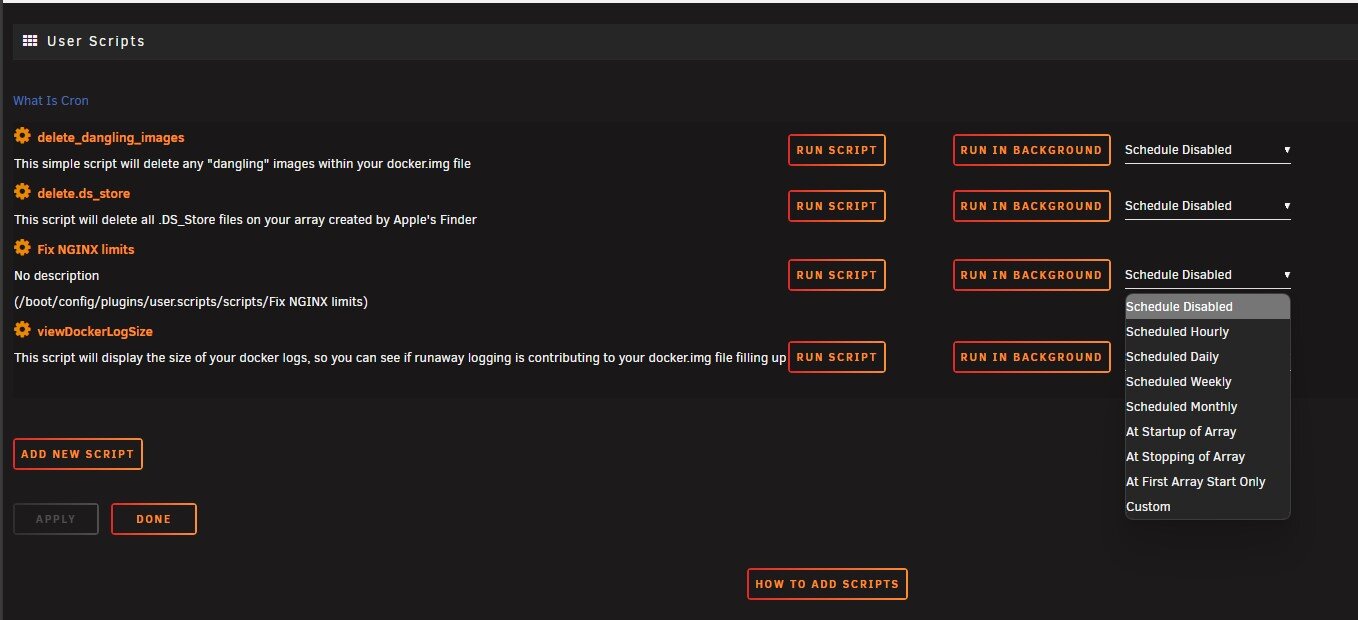

@tazman
Is this everything I need to do?
I installed user script and copy pasted your script, sce screenshots
What schedule should it be on?
8 minutes ago, Whiskers said:
@tazman
yes I have found that I need to wait 20 seconds after the array has auto started via disk settings for everything to be happy be fore making system services changes.
at first array start is the corn for this script to edit Nginx and add the data.
# Fix NGINX limits
# sed cannot find the file when executed directly, waiting for 10 secs first
sleep 10
sed -i "s;zone=authlimit:1m rate=30r/m;zone=authlimit:1m rate=60r/s;g" /etc/nginx/nginx.conf
sed -i "s;zone=authlimit burst=20;zone=authlimit burst=60;g" /etc/nginx/conf.d/locations.conf
/usr/sbin/nginx -s reload
edit nginx at your own risk...
