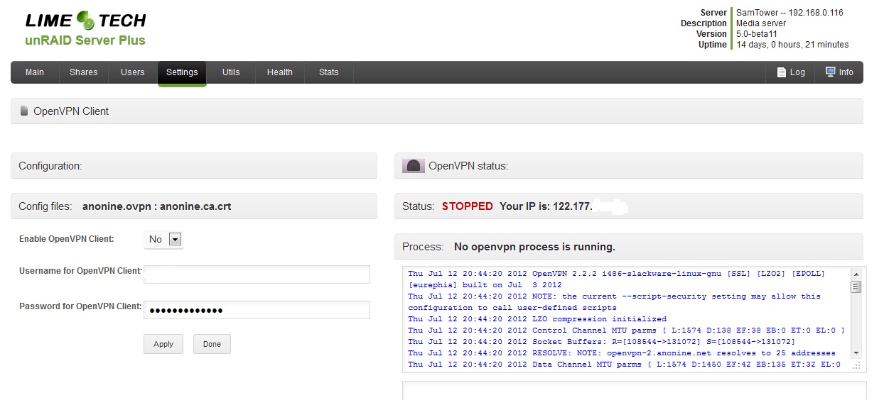

Peter, I followed your procedure and installed Open VPN client, with anonine certificates. But when I enable Open VPN client it is not starting. Gives an error for fraction of a second that I could not even read it, says something like, an error has occurred, something has gone wrong probably in your account." and then "Enable open VPN client reverts back to "NO"
Kindly assist.
Last few entries in the log file  ..
Thu Jul 12 20:55:08 2012 [titan] Peer Connection Initiated with 80.67.8.213:1195
Thu Jul 12 20:55:11 2012 SENT CONTROL [titan]: 'PUSH_REQUEST' (status=1)
Thu Jul 12 20:55:11 2012 AUTH: Received AUTH_FAILED control message
Thu Jul 12 20:55:11 2012 TCP/UDP: Closing socket
Thu Jul 12 20:55:11 2012 SIGTERM[soft,auth-failure] received, process exiting
can you ry to NO -> apply, then Yes -> apply ?

I am afraid its still the same ... :( :(
Ok I got it , I had to use the same credentials that I used while registering at Anonine. Now I am connected.
