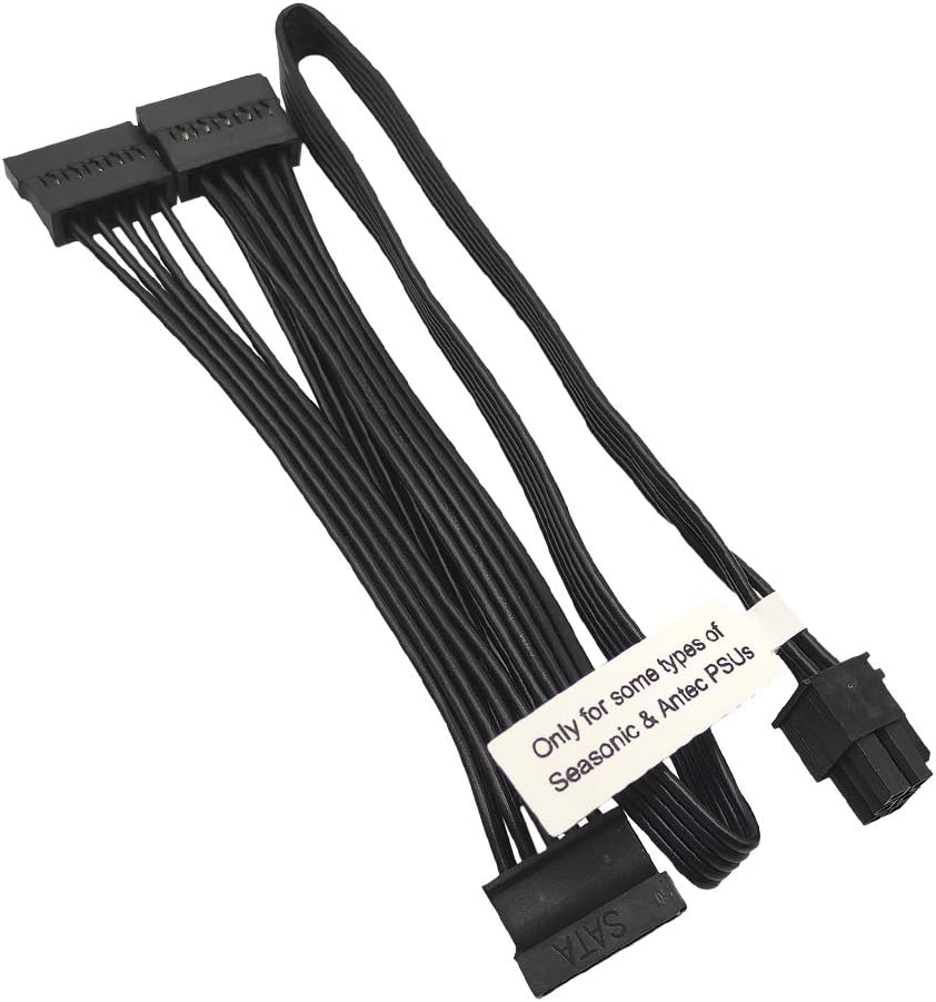

Any power splitters in use?
I am using SATA power cable that came with my PSU (mine is Corsair, picture is just an example). Is that considered a power splitter?
Edited by Icekronik
no
If no splitters are in use, and you have already replaced the cables, it could be just a firmware issue with those disks, I also have some Toshiba disks where the models that start with a common serial show some ATA errors during high load, in any controller.
If you don't notice any effects, I would just ignore, next time you need to upgrade a disk, try using one for a different brand/model and then see if that one no longer shows the same issue.
