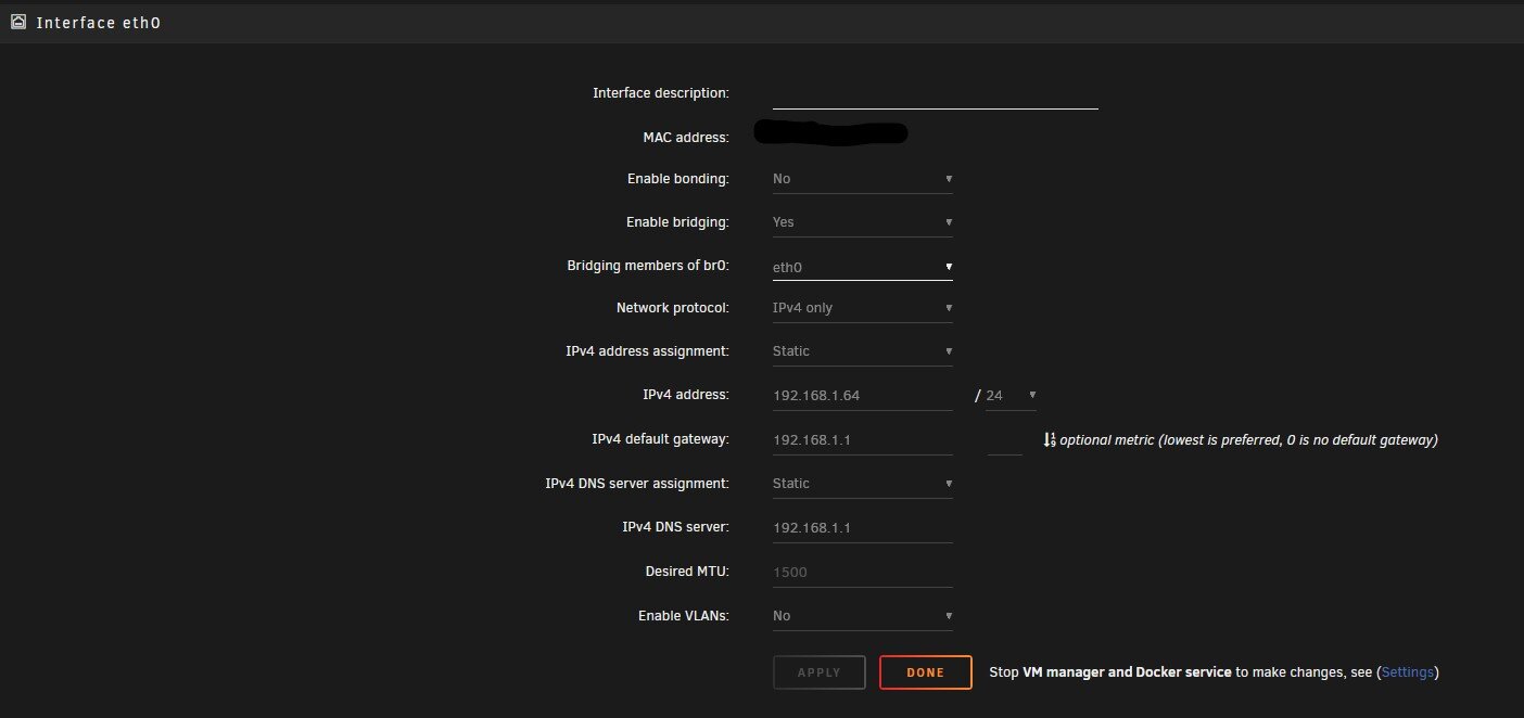

My VM is running slow as hell. My daily computer is getting 950 mb/s download and 115 mb/s upload while my VM is struggling to get 115 mb/s download and 100 mb/s upload. I've attached my network settings and my VM XML script. Any help would be appreciated. My VM is so laggy it's unbearable!

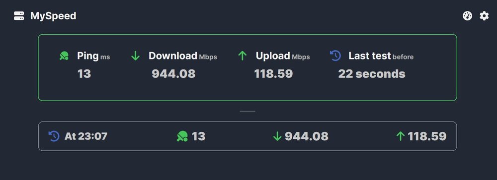

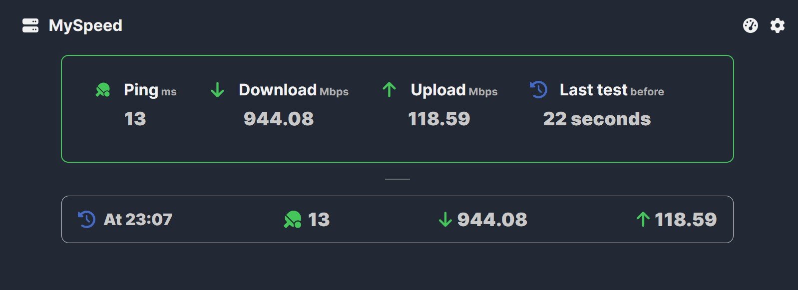

I don't get it. One is the VM speeds and the other is the docker "myspeed" running on the same Unraid server. They're sharing the same ethernet line.

@JorgeB I got it figured out. My NIC was set at 100mb/s in the properties. I have no idea why Windows would pre-set it like that. All good now though.
