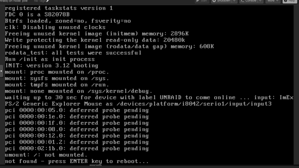

I have Unraid running as a VM under Proxmox and its been running great until I tried to upgrade to 7.0 rc2 and 7.0 Final.
After upgrading to 7.0 the system fails to boot with the following error.
Notice the dev mapping of the USB stick - sdi
If I remove a drive from the system it will boot under 7.0, the drive will be recognized as sdh. But I am of course down a disk.
I can then boot into Unraid and downgrade to 6.
After I roll back to 6.12.14 with all my drives notice that the USB drive is detected as sda.
So booting with 9 drive fails, but booting with 8 works.
My theory is that the new kernel detects or assigns the SCSI drives in a different order placing the USB stick at the end of the /dev mapping instead of the beginning and the boot only checks the first 8 devices.

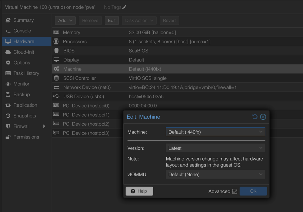

I don't know why it was on, must have changed it when I checked the settings, but turning of vIOMMU fixed it fore me.
Ya, that didn't work for me, but I am running a q35 machine insted of a 440lx.
Prior I did try changing the machine type to some older versions, but had no luck.
Glad you got it working.

i have the same issue, removing some drives didn´t help. i´m also with proxmox. Now i´m stuck. I´m look for the way to downgrade
I just remove another 2 drives, total of 4 and now is booting, let see what happend
