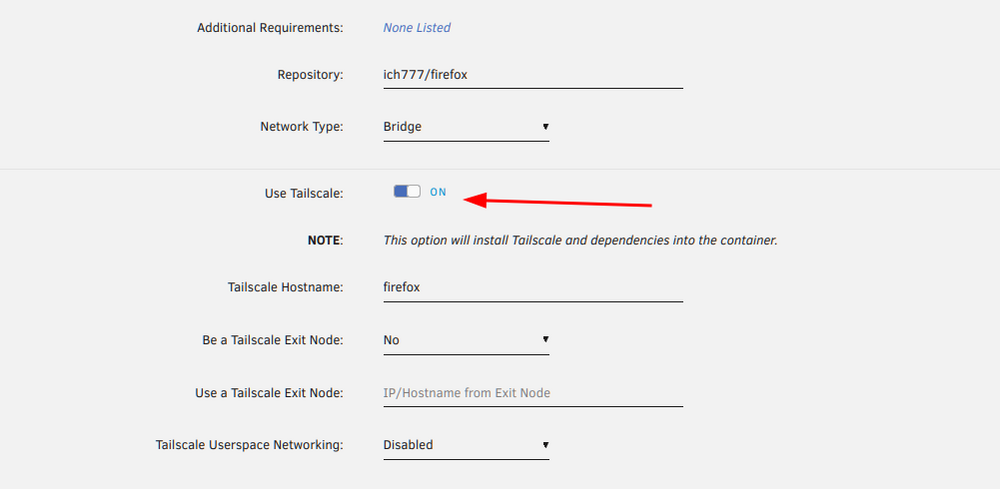

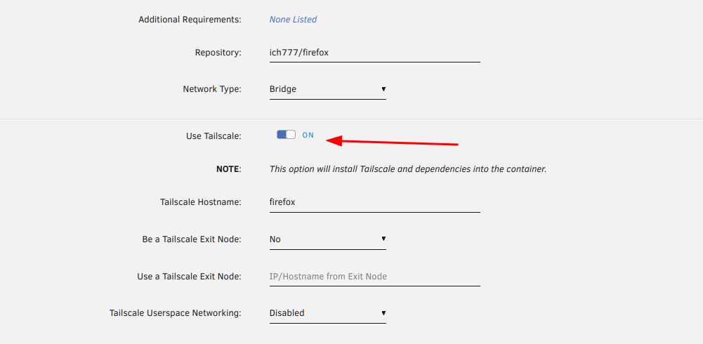

I use the integration as in the picture

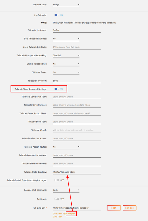

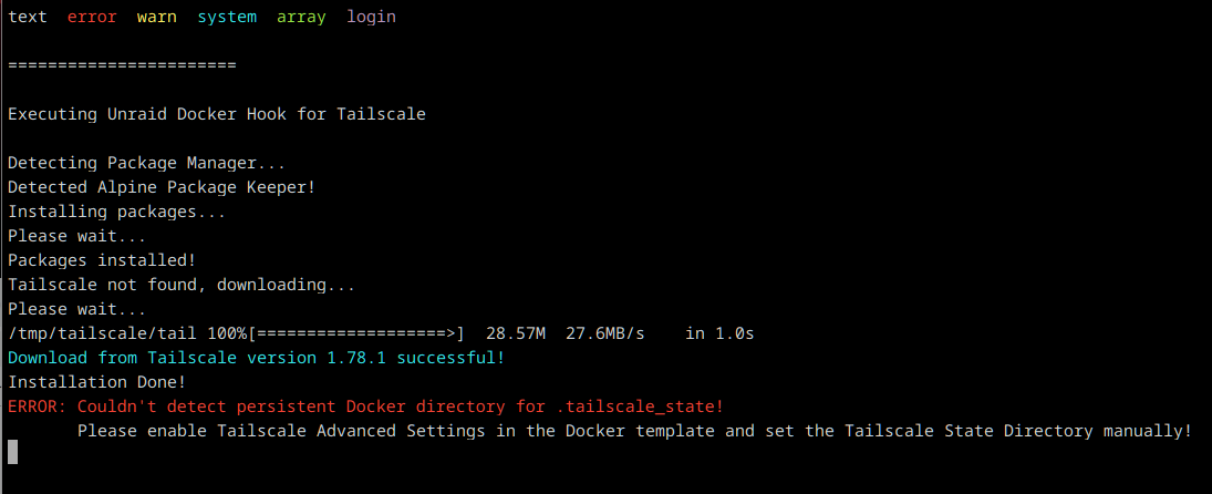

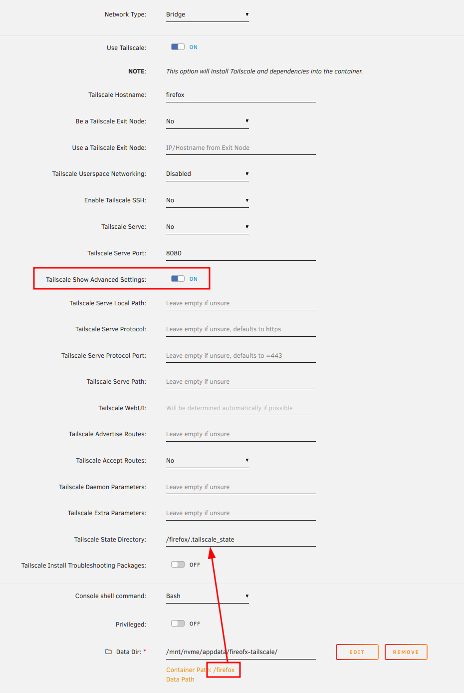

Okay, what container gives you issues? It might be possible that the wrong state directory is selected.
You can set the state directory manually by opening the Docker template, enabled "Tailscale Show Advanced Settings" and at "Tailscale State Directory" enter a persistent storage path from inside the container (not the path on the host):
In this case the path in the container would be "/firefox" and if you need or want to set it manually you would need to enter this directory followed by a directory where you want to store the files for Tailscale (I would recommend to use a "." at the beginning because then the directory is hidden) so to speak the path would be: "/firefox/.tailscale_state"

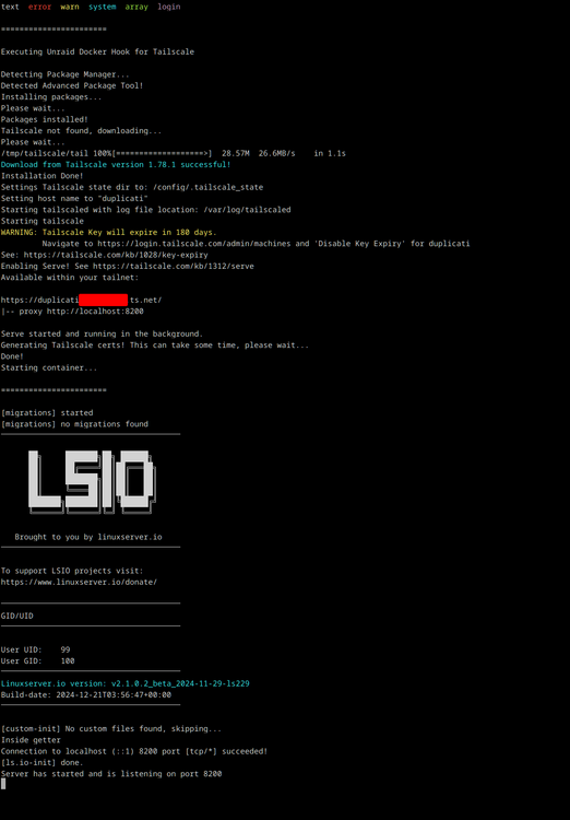

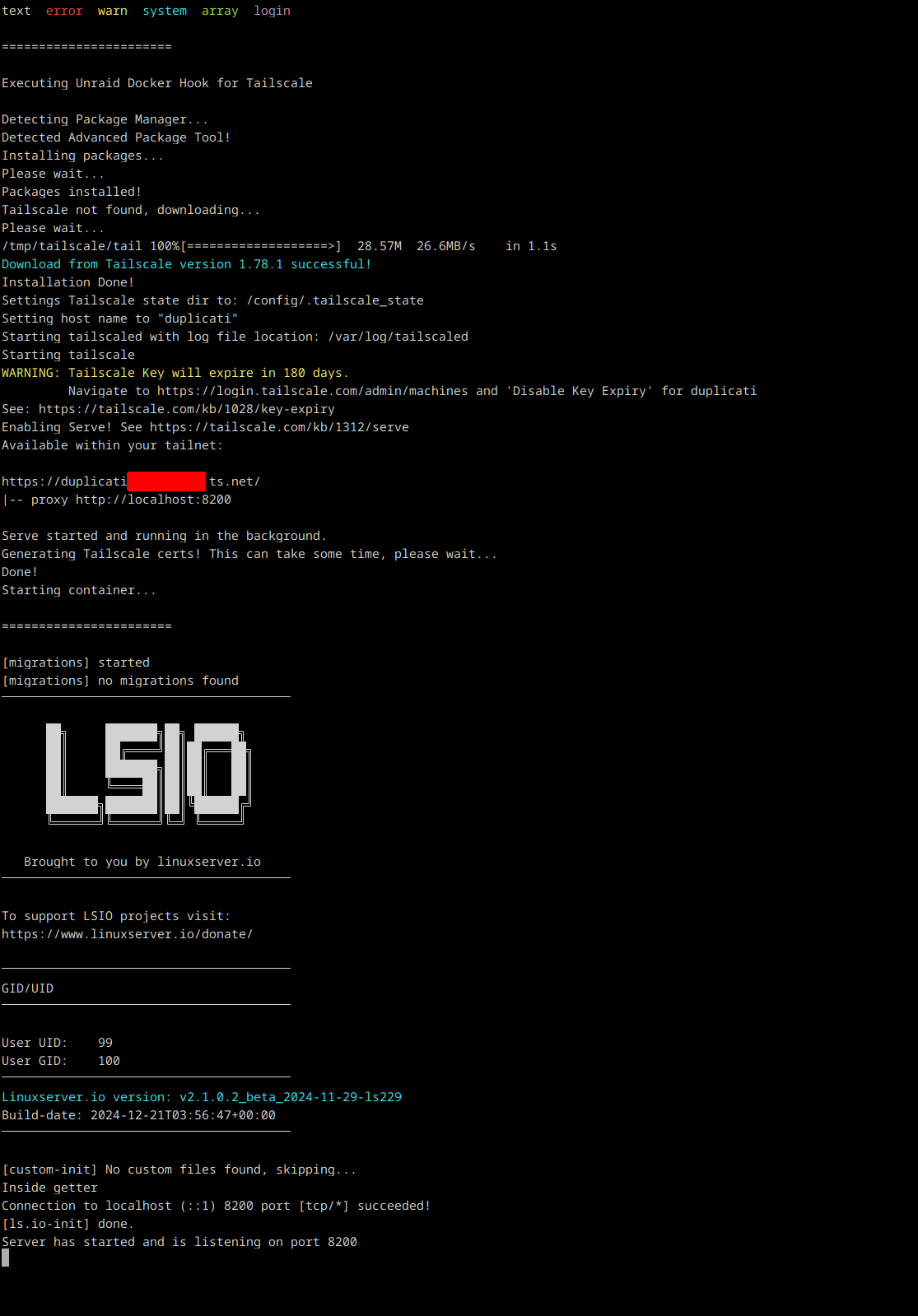

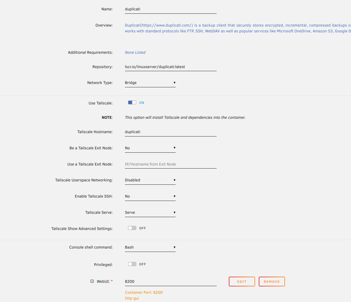

10 minutes ago, SL99999999 said:
Duplicati

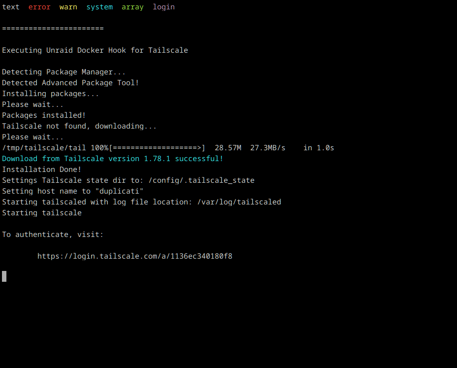

It picked up the state dir automatically:

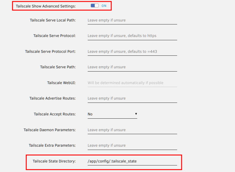

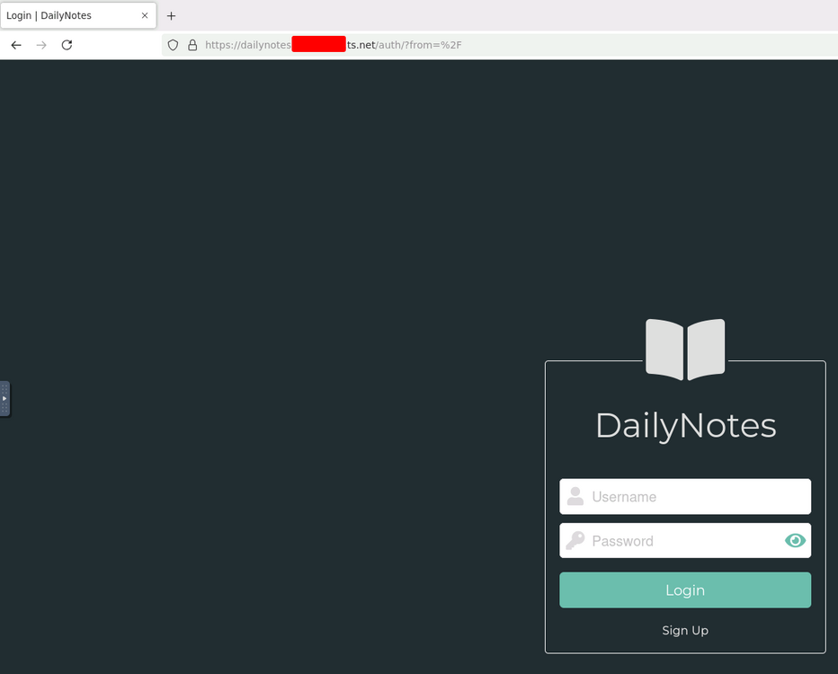

16 minutes ago, SL99999999 said:

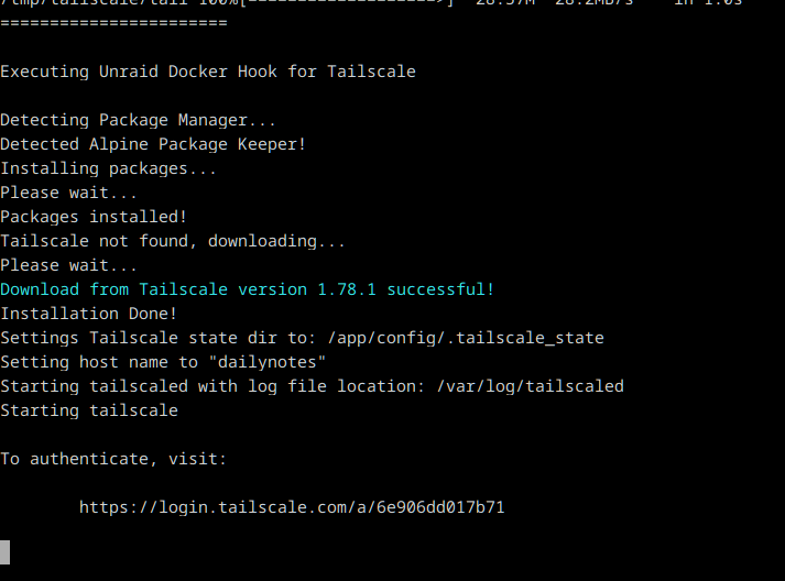

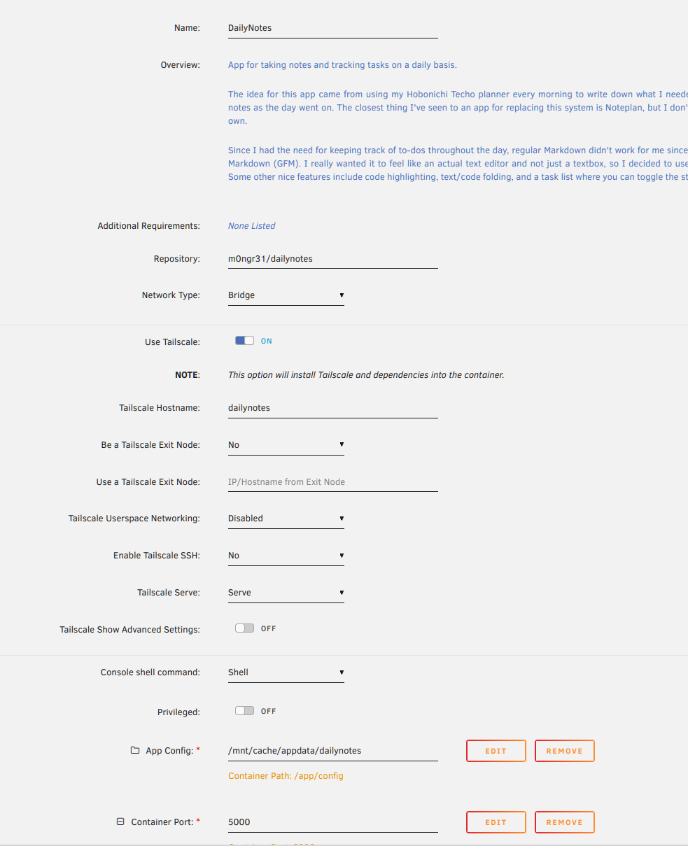

Dailynotes
Here you can see that it doesn't picked up the state directory:
but after setting it manually:
everything is working as it should

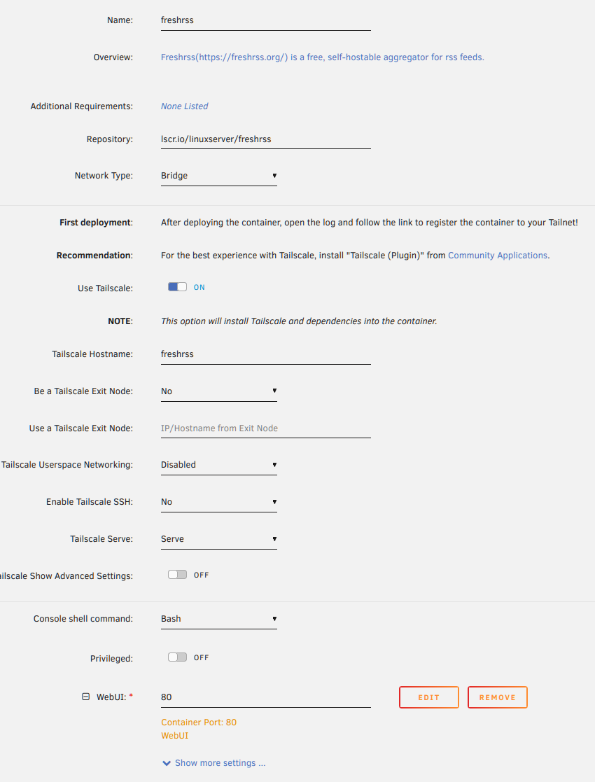

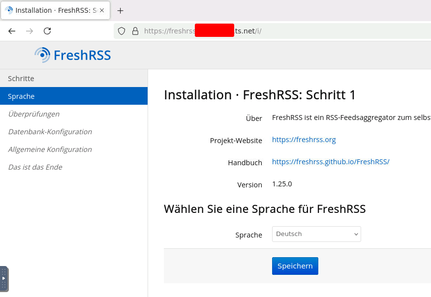

22 minutes ago, SL99999999 said:

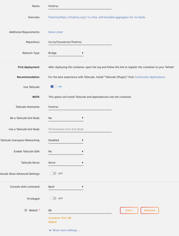

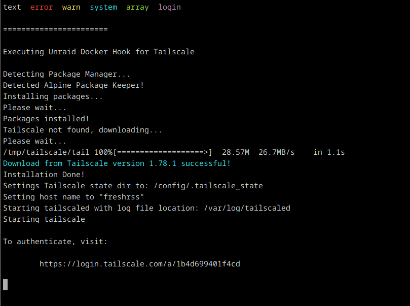

FreshRSS
After the start authentication works:

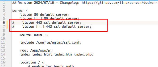

However if you are using Serve like me you have to disable https in the nginx configuration from FreshRSS, you can simply do that by going to the directory from FreshRSS and edit the nginx default site config: .../freshrss/nginx/site-confs/default.conf and comment these two lines:
since Serve uses by default port 443 and nginx can't simply start if a application already uses 443, after that restart the container and freshrss is started.

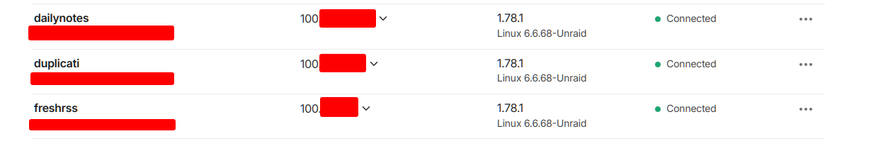

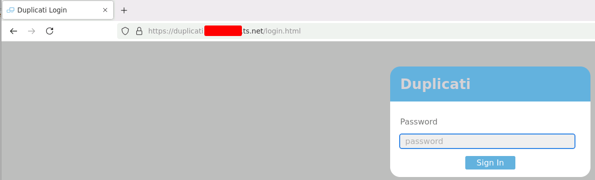

I can now see all three container in my Tailnet:
And I can connect to them via the Tailnet:

My log never show 'To autenticate, visit:"

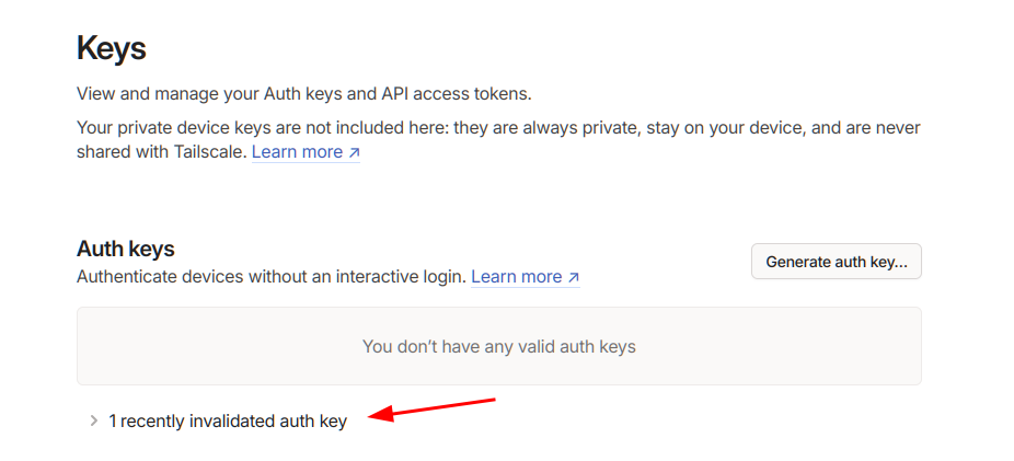

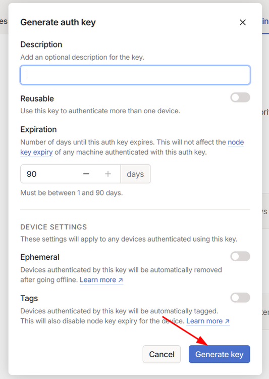

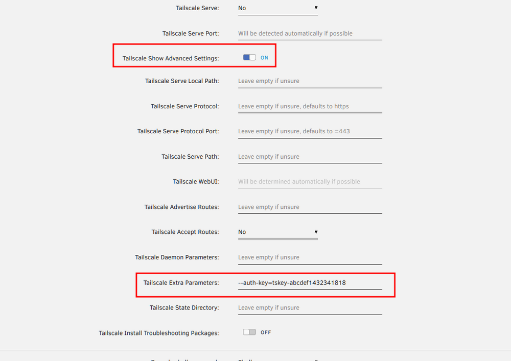

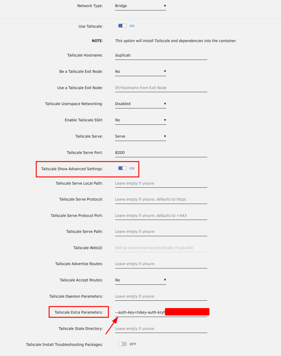

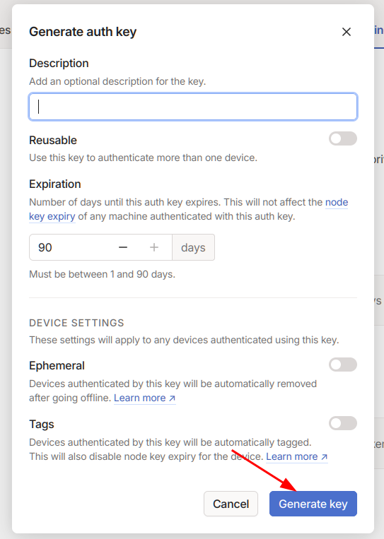

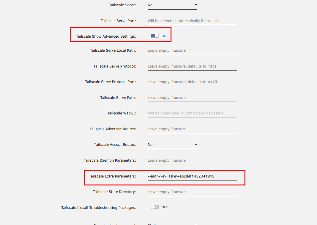

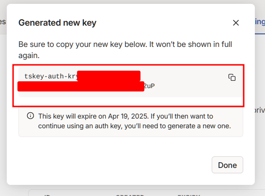

Please maybe also try to use a key:

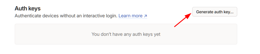

Go to your Tailscale Dashboard -> Settings -> Keys: https://login.tailscale.com/admin/settings/keys
Then click Generate auth key...:
In the following prompt klick Generate Key:
Copy the auth key from the following windows to your clipboard:
In the template copy the auth key to Tailscale Extra Parameters (don't forget to add --auth-key= in front of the key) :
After that you should see that you don't get a prompt to authenticate:
and in your Tailscale Dashboard you should see that the key is now invalidated since if it is used once it will be invalidated (as long as you don't set it to be Reusable) :
