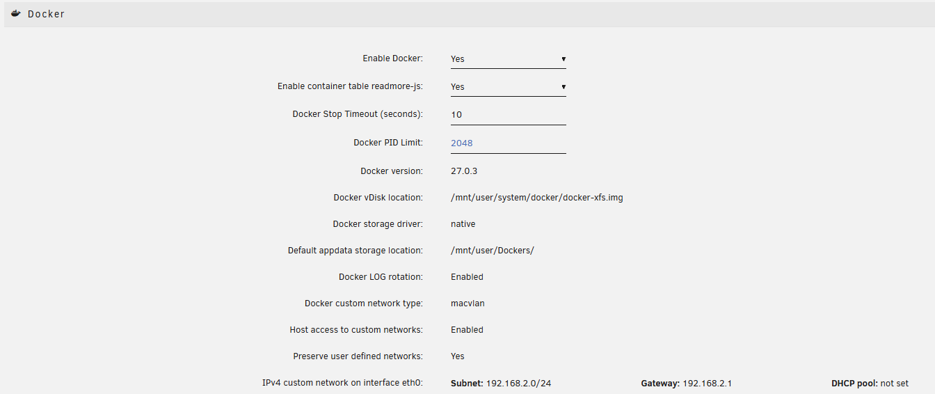

Thanks!  messing around with it more I noticed that it was saying that "Docker wasn't running" when trying to install apps, but on the System Settings Docker it did say it was running.  I ended up rebooting the machine and now it seems to be working...for now.

your on unriad 7 yes?
there have been some changes to the unraid docker system...
I recommend deleting the docker image and recreating it using XFS...
Depending on your pool setup You may need to use overlay 2 as per the release notes and new docs

Thanks @bmartino1 rebuilding the docker image seems to have fixed the problem (for now at least).  No more of those errors in the log.
