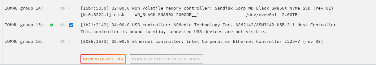

My USB controller is an ASMedia Technology Inc. ASM2142/ASM3142 USB 3.1 Host Controller, set to bind to VFIO. The System Devices page reports that this was successful.

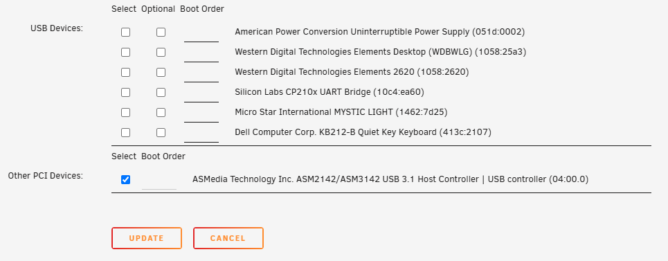

Windows 11 VM settings have the controller checked under "Other PCI Devices".

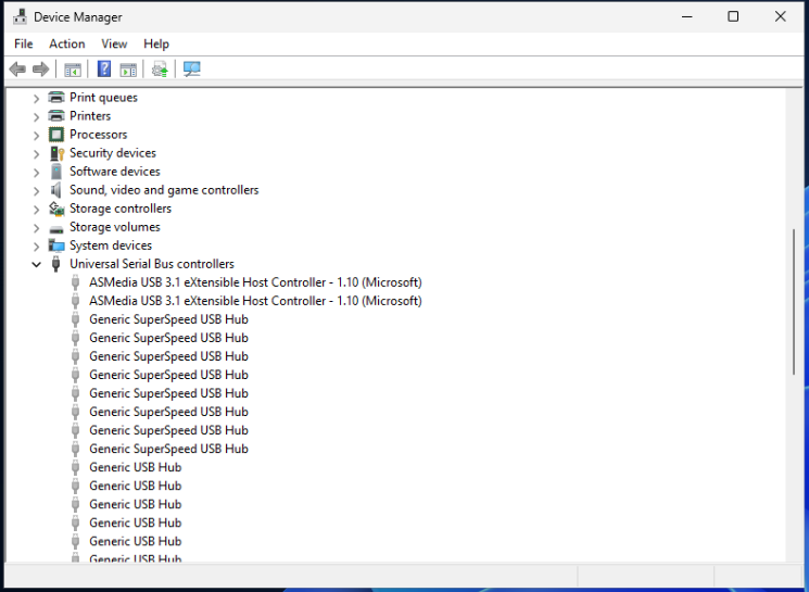

Booting into the Windows 11 VM, the controller can not be seen in device manager. I have included a screenshot of the greyed out USB controller where it used to be detected before the update.

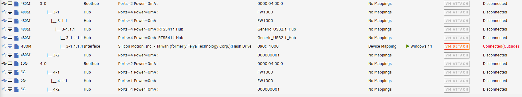

I have tested passing individual devices through to VMs (without the controller bound to VFIO) which works fine, so I don't think there is an issue with the controller itself.
