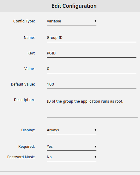

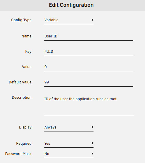

you can add uid and guid via adding variables.
per the docks to use tail scale you need to run the docker as previlaged.
please post tailscale quetion on the tailescale side of the forum:
https://forums.unraid.net/forum/111-tailscale/
review docs found in here:
stop the docker
edit the docker
scroll to bottom and click add
99 - nobody
100 - user group
0 - root
uid:
pgid:

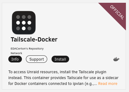

For such containers I would actually recommend the Tailscale Sidecar method <- using a sidecar will probably be much easier in an upcoming version from Unraid.

I was referring to SpeedTest-By-OpenSpeedTest container although I was hoping for a universal workaround. Seems like sidecar is the way as I don't want to run containers like this privileged.

The process for the Tailscale Sidecar will be possibly more simplified in the future.

I agree completely on that, don't run your containers privileged.
What is the Tailscale Sidecar?
You basically deploy this container (configure it to your liking) :
After that you use the network from the Tailscale-Docker in the container that you want to have your Tailnet by setting Network Type to "Container" and select the sidecar container at Container Network like this:
