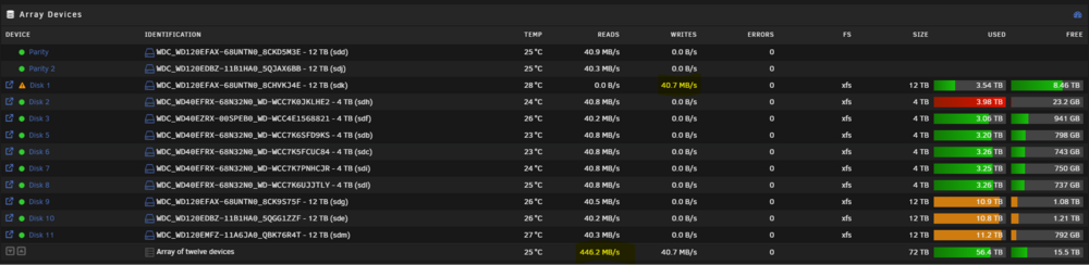

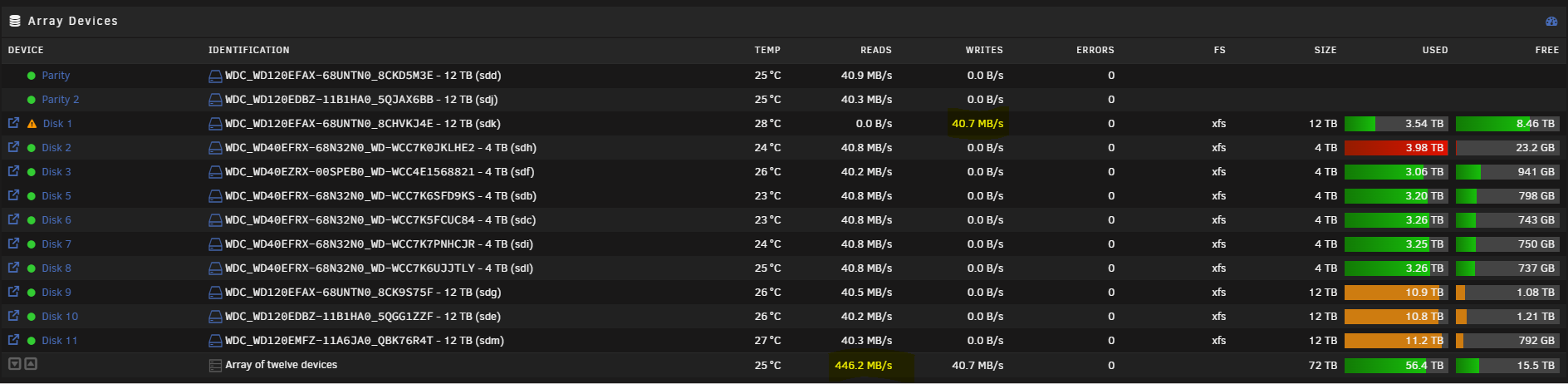

Hi I have replaced a 4TB WD RED with a 12TB WD RED and the ETA is on completion is over 3 days.
Write speeds are only around 40MB/s - Quick chat on discord suggests this is slower than normal. I have an Intel i5-13500, Docker and VM services are stopped. Was really expecting maybe a 1.5 days for rebuild to take place?
Diagnostics attached.

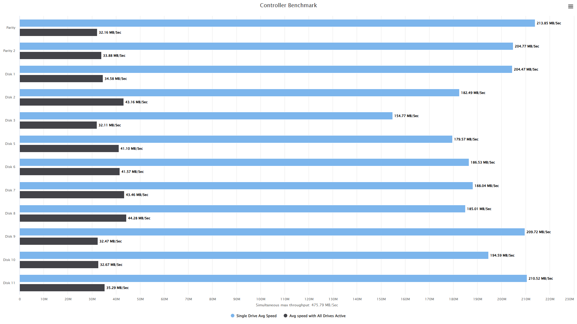

Nothing obvious logged, could be a slow disk or bandwidth problem, run the diskspeed container test, both the disks and controller tests.
It is what it is... If I have to wait 3 days fine but just wanted to make sure nothing wrong :)

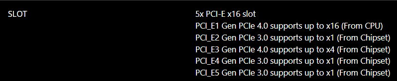

The diskspeed test confirms that there is a big bottleneck with the controller, post the output from:
lspci -d 1000: -vv
lspci -d 1000: -vv
root@Server:~# lspci -d 1000: -vv
04:00.0 Serial Attached SCSI controller: Broadcom / LSI SAS2008 PCI-Express Fusion-MPT SAS-2 [Falcon] (rev 03)
        Subsystem: Broadcom / LSI 9211-8i
        Control: I/O- Mem+ BusMaster+ SpecCycle- MemWINV- VGASnoop- ParErr- Stepping- SERR- FastB2B- DisINTx+
        Status: Cap+ 66MHz- UDF- FastB2B- ParErr- DEVSEL=fast >TAbort- <TAbort- <MAbort- >SERR- <PERR- INTx-
        Latency: 0, Cache Line Size: 64 bytes
        Interrupt: pin A routed to IRQ 18
        IOMMU group: 17
        Region 0: I/O ports at 3000 [disabled] [size=256]
        Region 1: Memory at 82600000 (64-bit, non-prefetchable) [size=16K]
        Region 3: Memory at 82580000 (64-bit, non-prefetchable) [size=256K]
        Expansion ROM at 82100000 [disabled] [size=512K]
        Capabilities: [50] Power Management version 3
                Flags: PMEClk- DSI- D1+ D2+ AuxCurrent=0mA PME(D0-,D1-,D2-,D3hot-,D3cold-)
                Status: D0 NoSoftRst+ PME-Enable- DSel=0 DScale=0 PME-
        Capabilities: [68] Express (v2) Endpoint, IntMsgNum 0
                DevCap: MaxPayload 4096 bytes, PhantFunc 0, Latency L0s <64ns, L1 <1us
                        ExtTag+ AttnBtn- AttnInd- PwrInd- RBE+ FLReset+ SlotPowerLimit 0W TEE-IO-
                DevCtl: CorrErr+ NonFatalErr+ FatalErr+ UnsupReq+
                        RlxdOrd+ ExtTag+ PhantFunc- AuxPwr- NoSnoop+ FLReset-
                        MaxPayload 256 bytes, MaxReadReq 512 bytes
                DevSta: CorrErr+ NonFatalErr- FatalErr- UnsupReq+ AuxPwr- TransPend-
                LnkCap: Port #0, Speed 5GT/s, Width x8, ASPM L0s, Exit Latency L0s <64ns
                        ClockPM- Surprise- LLActRep- BwNot- ASPMOptComp-
                LnkCtl: ASPM Disabled; RCB 64 bytes, LnkDisable- CommClk+
                        ExtSynch- ClockPM- AutWidDis- BWInt- AutBWInt-
                LnkSta: Speed 5GT/s, Width x1 (downgraded)
                        TrErr- Train- SlotClk+ DLActive- BWMgmt- ABWMgmt-
                DevCap2: Completion Timeout: Range BC, TimeoutDis+ NROPrPrP- LTR-
                         10BitTagComp- 10BitTagReq- OBFF Not Supported, ExtFmt- EETLPPrefix-
                         EmergencyPowerReduction Not Supported, EmergencyPowerReductionInit-
                         FRS- TPHComp- ExtTPHComp-
                         AtomicOpsCap: 32bit- 64bit- 128bitCAS-
                DevCtl2: Completion Timeout: 50us to 50ms, TimeoutDis-
                         AtomicOpsCtl: ReqEn-
                         IDOReq- IDOCompl- LTR- EmergencyPowerReductionReq-
                         10BitTagReq- OBFF Disabled, EETLPPrefixBlk-
                LnkCtl2: Target Link Speed: 5GT/s, EnterCompliance- SpeedDis-
                         Transmit Margin: Normal Operating Range, EnterModifiedCompliance- ComplianceSOS-
                         Compliance Preset/De-emphasis: -6dB de-emphasis, 0dB preshoot
                LnkSta2: Current De-emphasis Level: -6dB, EqualizationComplete- EqualizationPhase1-
                         EqualizationPhase2- EqualizationPhase3- LinkEqualizationRequest-
                         Retimer- 2Retimers- CrosslinkRes: unsupported
        Capabilities: [d0] Vital Product Data
pcilib: sysfs_read_vpd: read failed: No such device
                Not readable
        Capabilities: [a8] MSI: Enable- Count=1/1 Maskable- 64bit+
                Address: 0000000000000000  Data: 0000
        Capabilities: [c0] MSI-X: Enable+ Count=15 Masked-
                Vector table: BAR=1 offset=00002000
                PBA: BAR=1 offset=00003800
        Capabilities: [100 v1] Advanced Error Reporting
                UESta:  DLP- SDES- TLP- FCP- CmpltTO- CmpltAbrt- UnxCmplt- RxOF- MalfTLP-
                        ECRC- UnsupReq- ACSViol- UncorrIntErr- BlockedTLP- AtomicOpBlocked- TLPBlockedErr-
                        PoisonTLPBlocked- DMWrReqBlocked- IDECheck- MisIDETLP- PCRC_CHECK- TLPXlatBlocked-
                UEMsk:  DLP- SDES- TLP- FCP- CmpltTO- CmpltAbrt- UnxCmplt- RxOF- MalfTLP-
                UESvrt: DLP+ SDES+ TLP- FCP+ CmpltTO- CmpltAbrt- UnxCmplt- RxOF+ MalfTLP+
                CESta:  RxErr- BadTLP- BadDLLP- Rollover- Timeout- AdvNonFatalErr- CorrIntErr- HeaderOF-
                CEMsk:  RxErr- BadTLP- BadDLLP- Rollover- Timeout- AdvNonFatalErr+ CorrIntErr- HeaderOF-
                AERCap: First Error Pointer: 00, ECRCGenCap+ ECRCGenEn- ECRCChkCap+ ECRCChkEn-
                        MultHdrRecCap- MultHdrRecEn- TLPPfxPres- HdrLogCap-
                HeaderLog: 00000000 00000000 00000000 00000000
        Capabilities: [138 v1] Power Budgeting <?>
        Capabilities: [150 v1] Single Root I/O Virtualization (SR-IOV)
                IOVCap: Migration- 10BitTagReq- IntMsgNum 0
                IOVCtl: Enable- Migration- Interrupt- MSE- ARIHierarchy+ 10BitTagReq-
                IOVSta: Migration-
                Initial VFs: 16, Total VFs: 16, Number of VFs: 0, Function Dependency Link: 00
                VF offset: 1, stride: 1, Device ID: 0072
                Supported Page Size: 00000553, System Page Size: 00000001
                Region 0: Memory at 00000000825c0000 (64-bit, non-prefetchable)
                Region 2: Memory at 0000000082180000 (64-bit, non-prefetchable)
                VF Migration: offset: 00000000, BIR: 0
        Capabilities: [190 v1] Alternative Routing-ID Interpretation (ARI)
                ARICap: MFVC- ACS-, Next Function: 0
                ARICtl: MFVC- ACS-, Function Group: 0
        Kernel driver in use: mpt3sas
        Kernel modules: mpt3sas
root@Server:~#

So the obvious thing that sticks out to me is
Is it safe to cancel the rebuild and check the controller is seated correctly or even move it to another slot and start the rebuild again as its only completed just over 6%
This is the problem, it's only linking at x1, it should be x8, check the slot speed you have the HBA installed in.

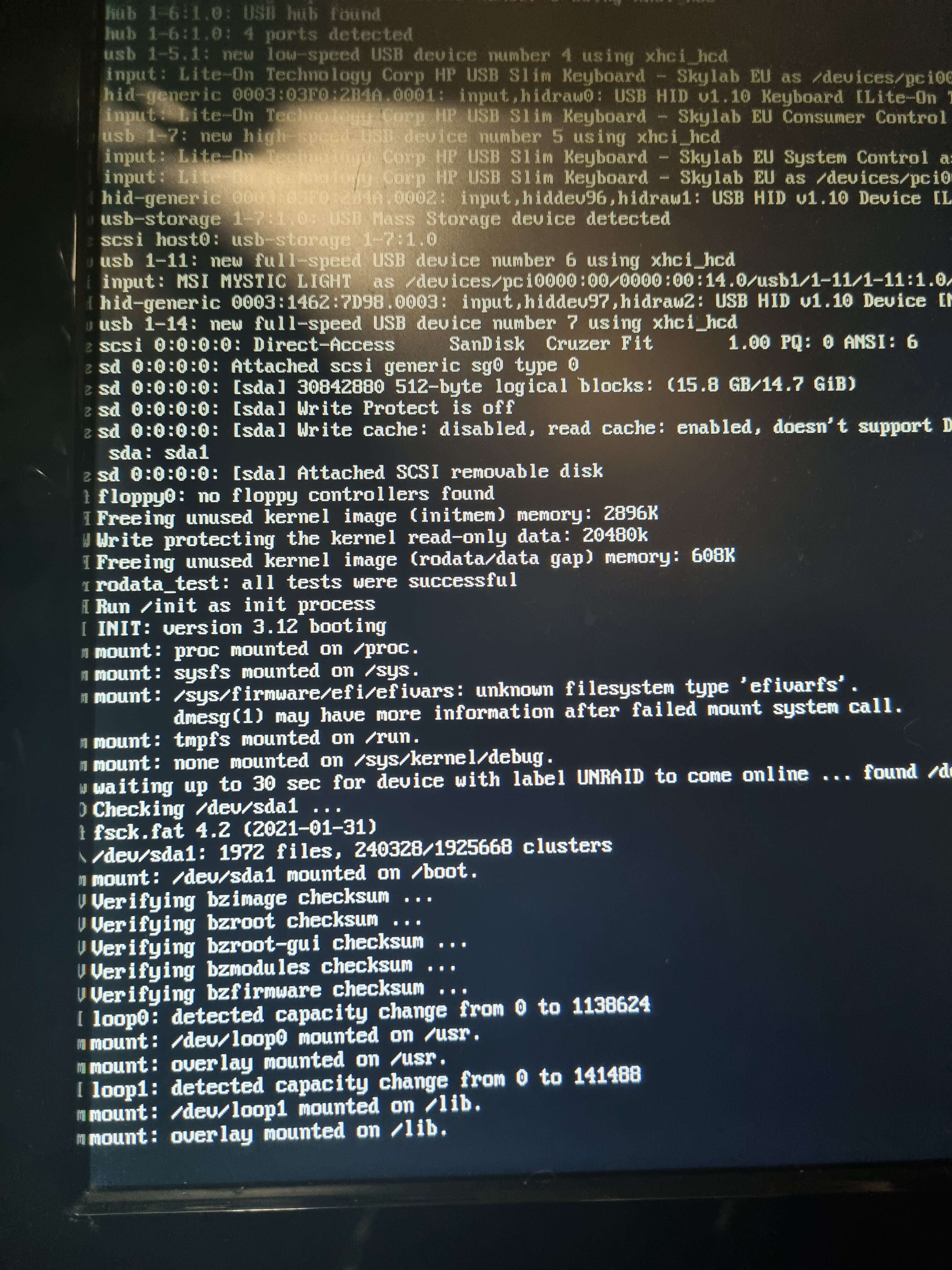

Not sure what's going on but Unraid won't boot into OS. Seems to stall at
"mount: overlay mounted on /lib"
Any suggestions?
Edited by bally12345
Added image
Removed all pci devices, which disconnects the controller too and still can't boot unraid even in safe mode... Do I need recreate the USB or has something else gone wrong?
The USB is a SanDisk Cruzer Fit 16 GB from 2018 so pretty old now I guess.
Created a new test usb with trial and that works, so will try restore backup of USB and hopefully that will get me back on track!
Restored back up of the flash drive on new usb and same! Stops at mount: overlay mounted on /lib
Back to square one... Not sure what to do next so will be shutting down and calling it a night until 2mw.
You can try redoing the flash drive, backup the current one first and then recreate it using the USB tool and just restore the bare minimum, like the key, super.dat and the pools folder for the assignments, also copy the docker user templates folder (\config\plugins\dockerMan\templates-user), if all works you can then reconfigure the server or try restoring a few config files at a time from the backup to see if you can find the culprit.

Also running lspci -d 1000: -vv is now giving me LnkSta: Speed 5GT/s, Width x4 (downgraded) which is better than x1 but seems my motherboard doenst support x8

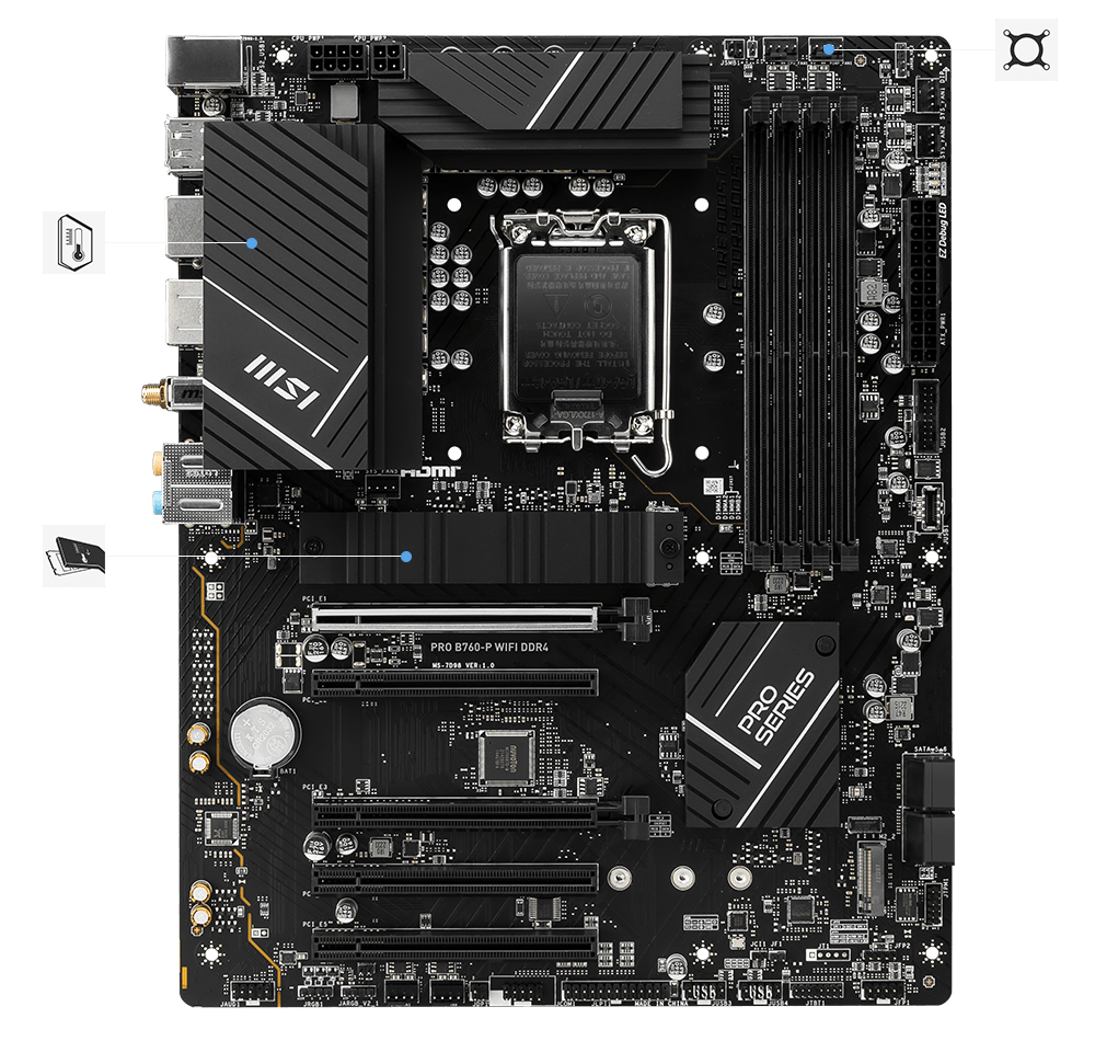

It should if you use the x16 CPU slot, though x4 it's not bad.
So maybe dumb question but that has GTX 1650 low profile card in the x16 slot I don't use much other than passing through to a Win11 VM... Is it better to swap em and maximise disk speed.

The rebuild looking much better now

Swapped over the GFX card with the LSI controller and now showing as
LnkSta: Speed 5GT/s, Width x8
I would 100% prefer faster disk io over the GFX card so hopefully everything will run much better from now. Just need to remember to change the binding for the GPU passthru to VM and should be sorted!
