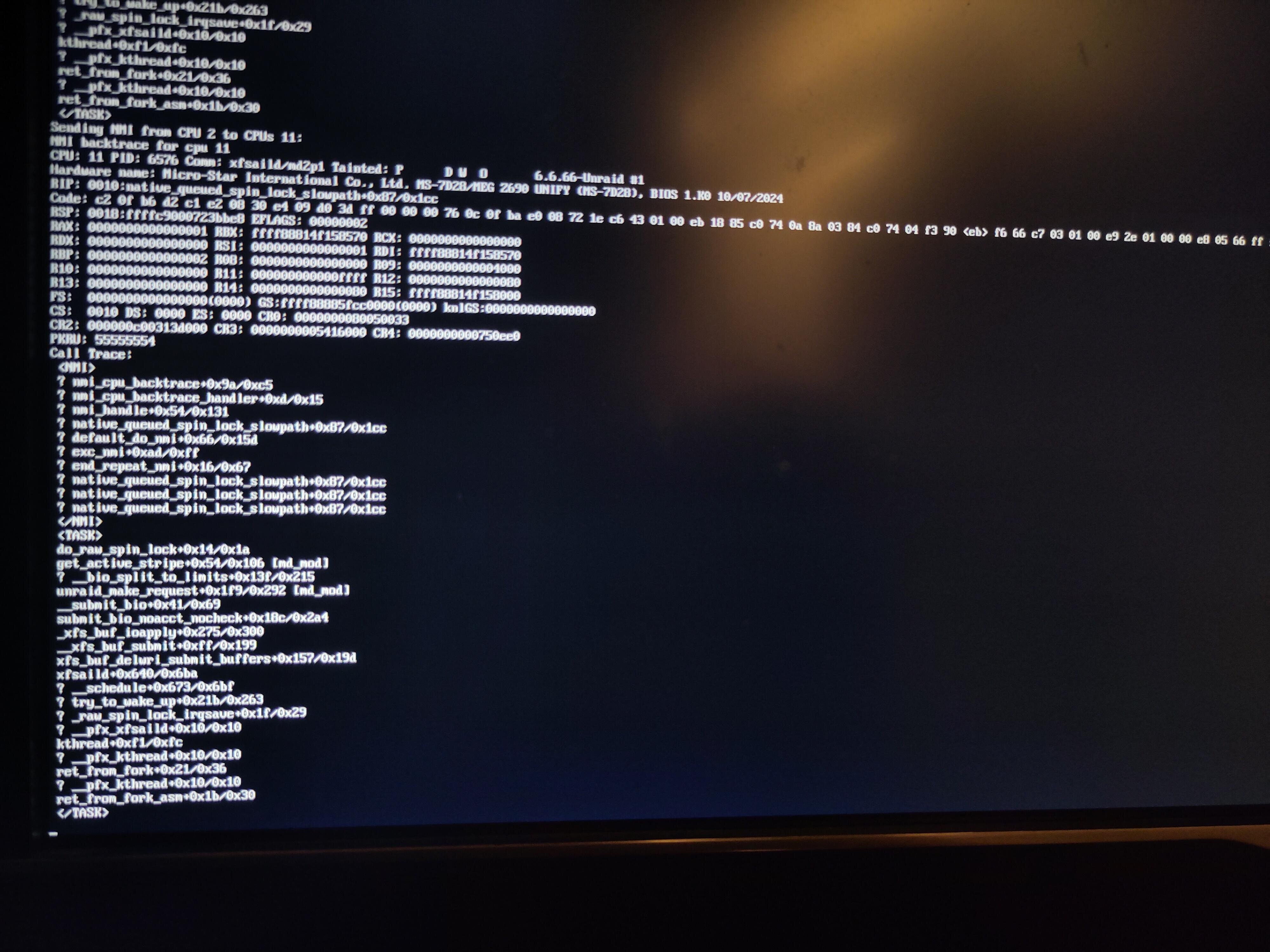

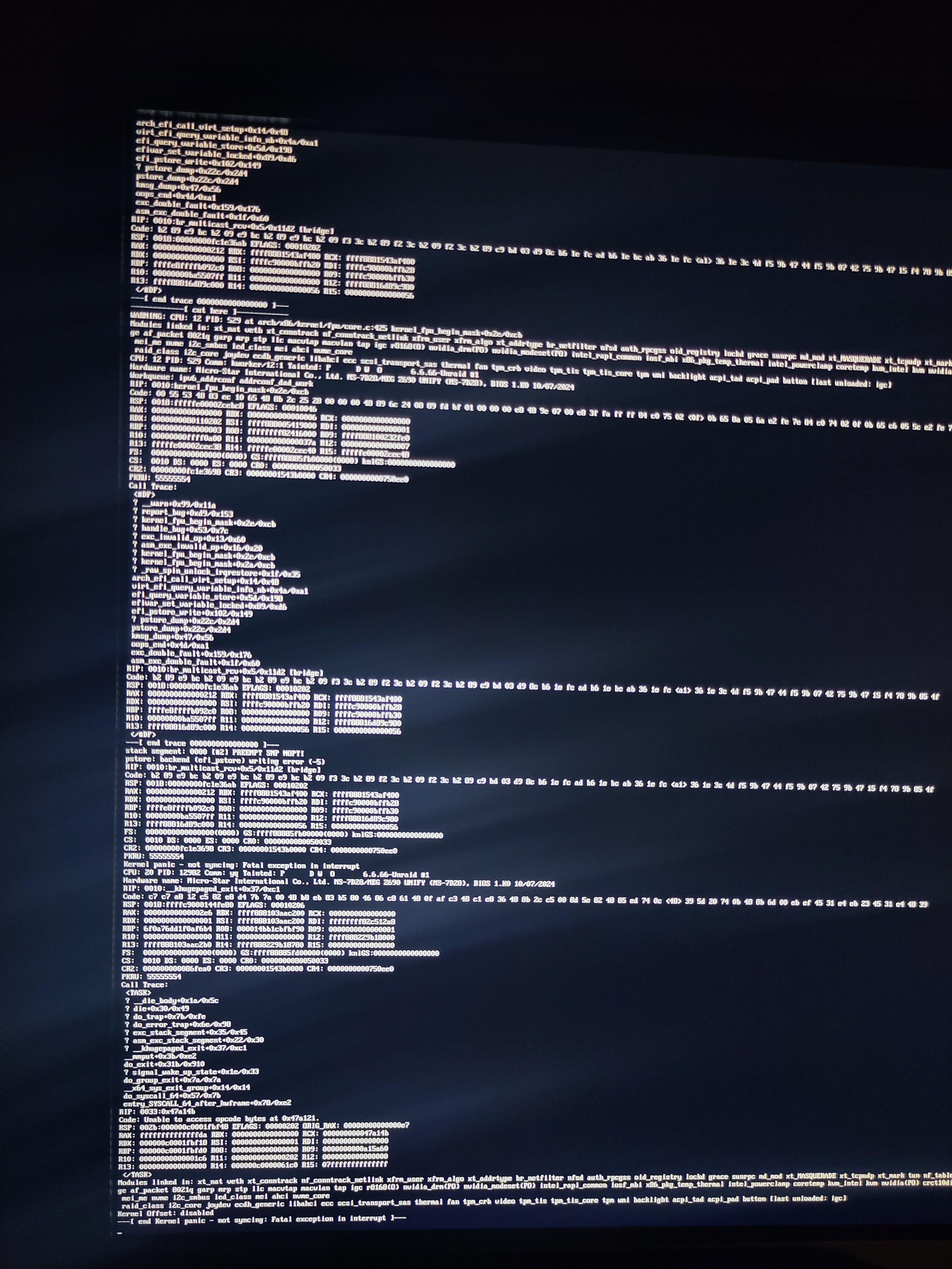

I got the message as seen on the image "Kernel Panic", After a reboot(reset).
The Cache drive is dismounted as seen in the image also there is the message "Unclean shutdown Detected".
Why not take some screenshots instead of photos? It would be much clearer.
Start the array with the cache assigned and post new diags if it doesn't mount.

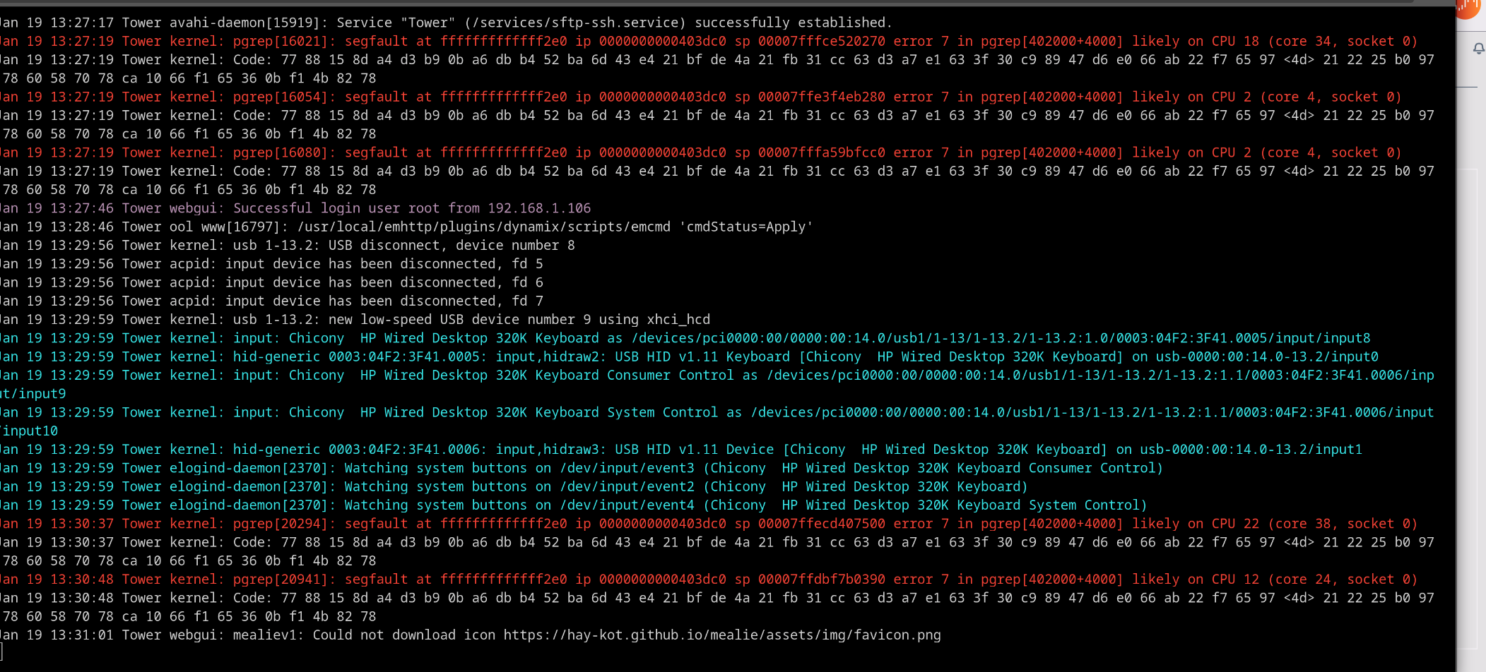

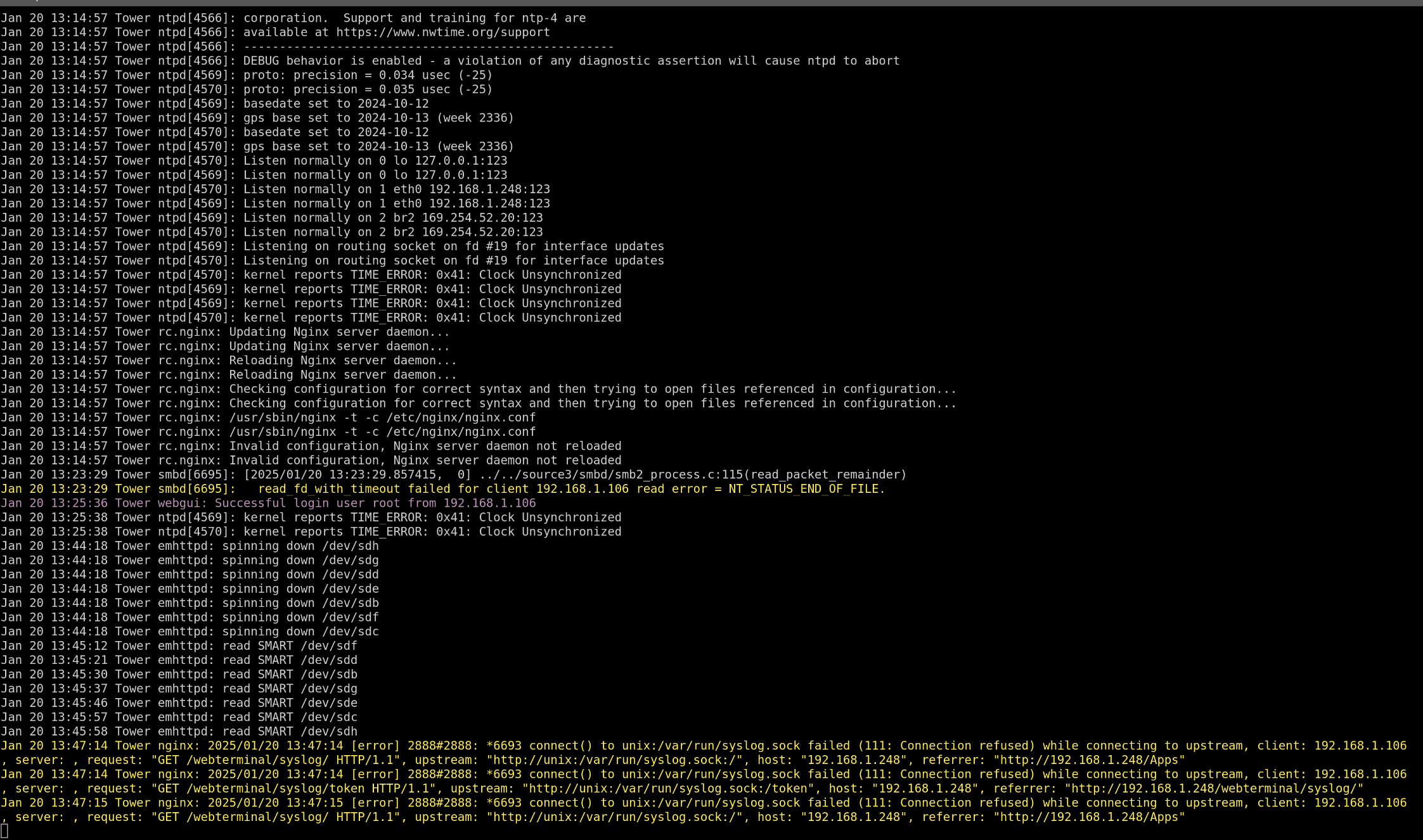

i do have this one from syslog

Try booting in safe mode to rule out any plugin issues.

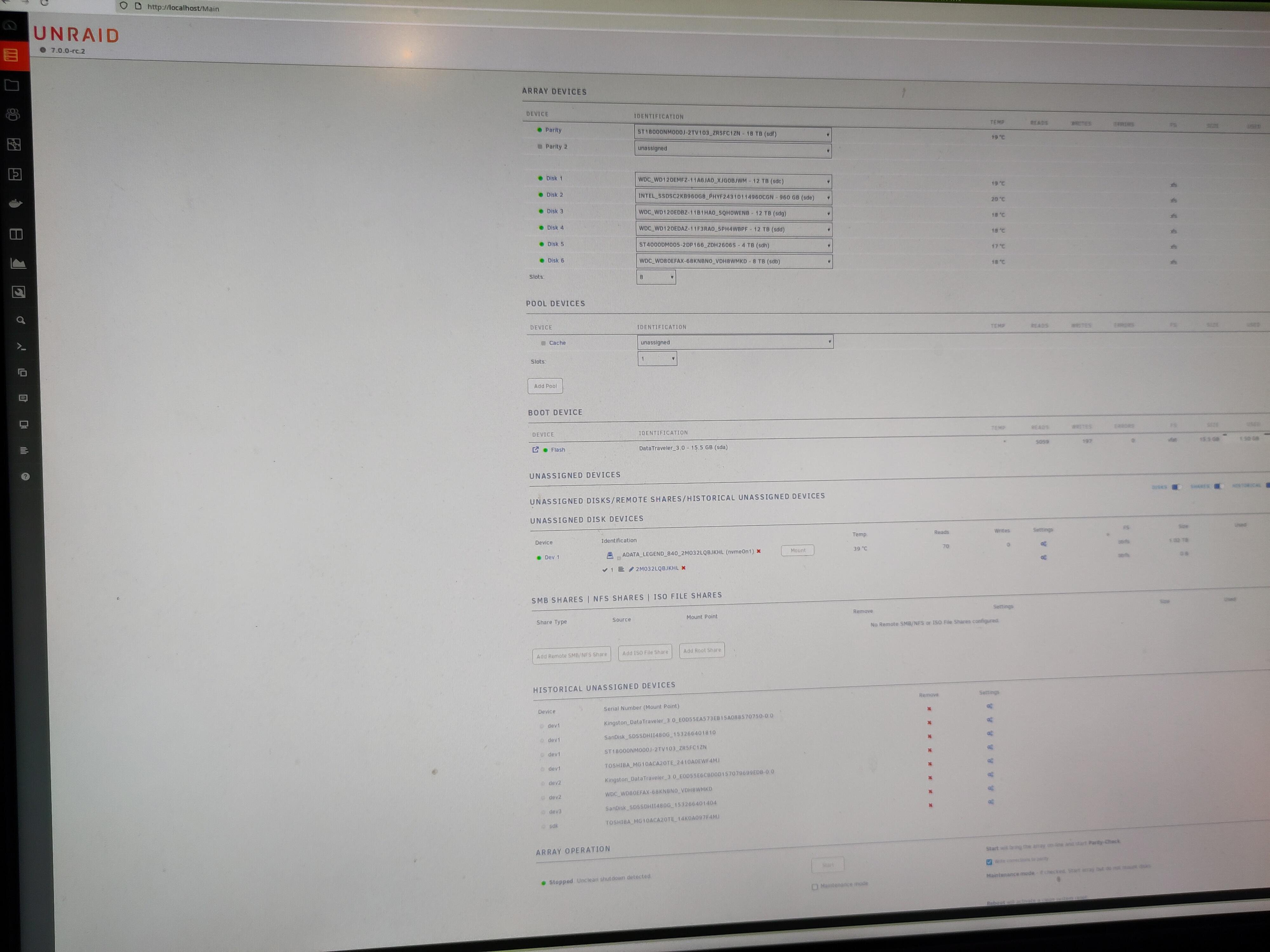

I added the Cache driver en started the array then firefix local crashed and was unable to do anything in the gui anymore.
After a while i shutdown the system by the cli with "shutdown" when i start up now to "start with GUI" the system locks on the login screen and i am unable to login.
Keyboard isn´t responding and numlock isn´t reacting, When i ping to the IP i get no reaction.
After a boot without ¨ Safe mode - no plugin" the systeem boot with black screen no system info when booting on the screen just black but turned on.
After a while i am now able to ping. But no web interface.
I did discovery that in the safe mode the port changed to :80 instead of :9980 what my setting was, So now i am in the GUI back again,ScreenshotFrom2025-01-2021-49-25.thumb.png.305145fecb4a581e5a69a666f1dae5de.png

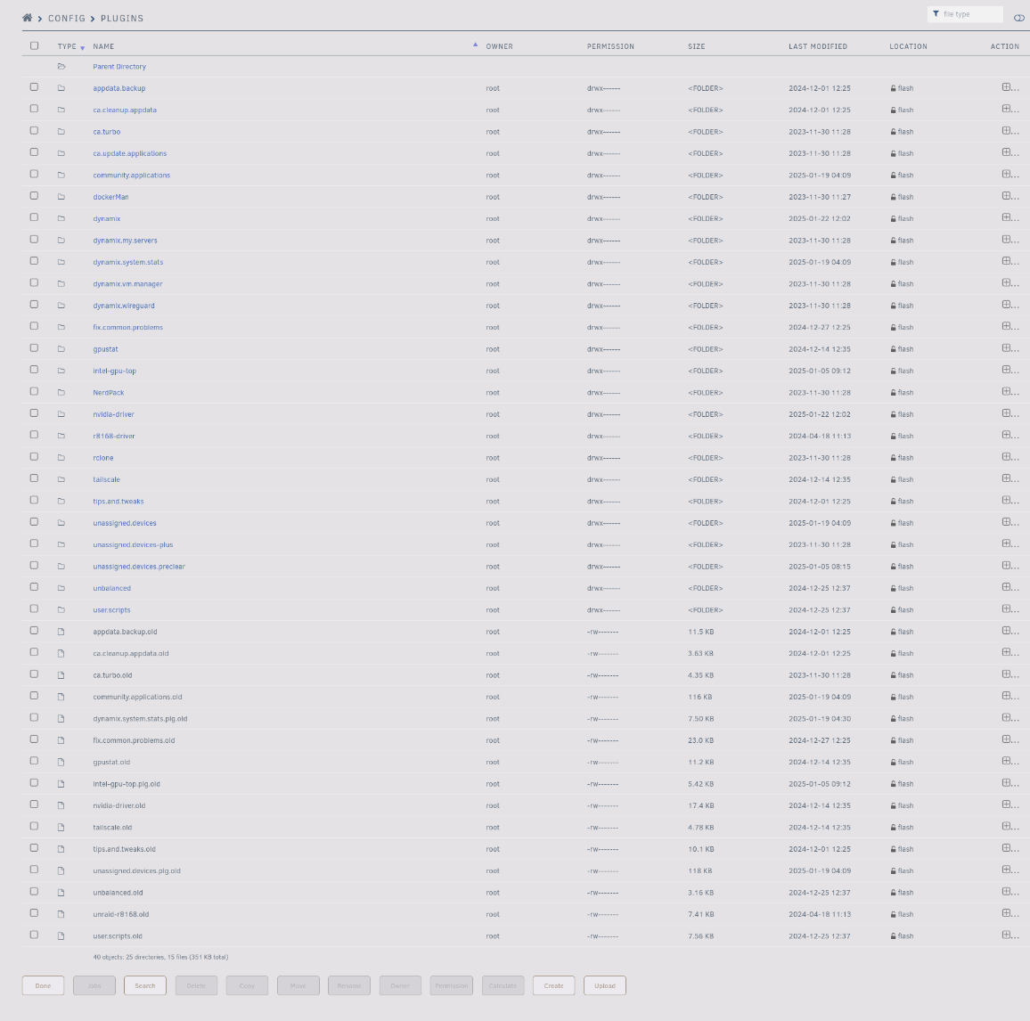

That suggests a plugin is the problem, try renaming all *.plg files on /config/plugins, then retest.
Hi JorgeB,
Still no boot when starting to normal mode, I do get this error as seen on the picure (sorry again from the phone).
When i started back to Safe mode "No plugin". It gets back online and i started the array.
Make sure all plugins were removed, you can also try redoing the flash drive, backup the current one first and then recreate it using the USB tool and just restore the bare minimum, like the key, super.dat and the pools folder for the assignments, also copy the docker user templates folder (\config\plugins\dockerMan\templates-user), if all works you can then reconfigure the server or try restoring a few config files at a time from the backup to see if you can find the culprit.
Hi Jorge,
Removing or Renaming, I renamed them all to .old, Do i also need to do the folders?
Can you tell me if like the cpu/gpu plugin change settings somewhere else and where to find them for example the intel-gpu-top/>

I made a back-up of the 3 plugin folders (Plugin, Plugin - error and plugin removed) then i emptied them and did a reboot.
Seems that the system is running good now. I reinstalled the com. plugin.

Do i have to put other files back, I emptied all files in (Plugin, Plugin - error and plugin removed)
Also i found Batman?..
This file is not pressed in the new installed com.plugin
Some plugins folders are parts of a stock install, but you can copy from the zip.
You can delete that.

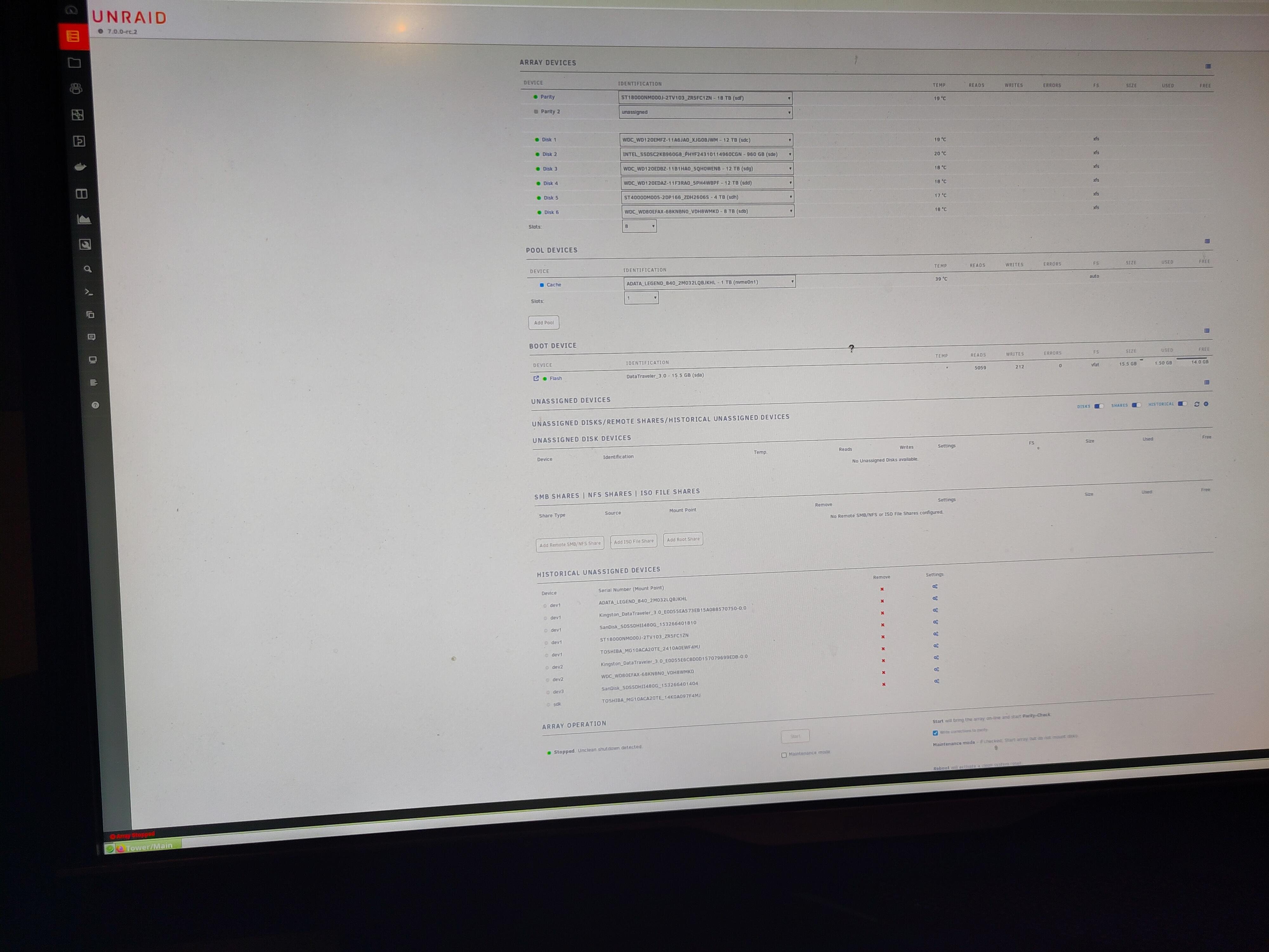

But when i install the "Community plugin" the systems start showing blank screens everywhere. Like in the screenshot i am able to ping the server but the webpage is unusable. I am able to use the terminal for example Ifconfig. But clicking on the log button doesn't do anything.
Do you have any suggestions for this issue?
Thanks
Edited by DuckWaze
Added info/Spell error
Try using a different browser, and make sure no ad-blocker/firewall is blocking the GUI
