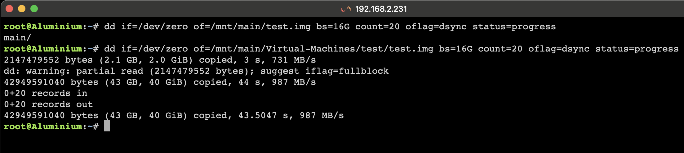

Running 3 Samsung 980 in a ZFS RaidZ1. I'm getting really bad internal Speeds:
What could cause this to run really slowly, the drives are rated for at least 3/3 GB/s of read and write, yet im getting 1/3 with a Raidz1

You are likely being limited by the CPU, don't like to use dd for speed testing, try the test below, but don't expect much more than 1GB/s with that hardware:
pv /path/to/large/file > /dev/null
