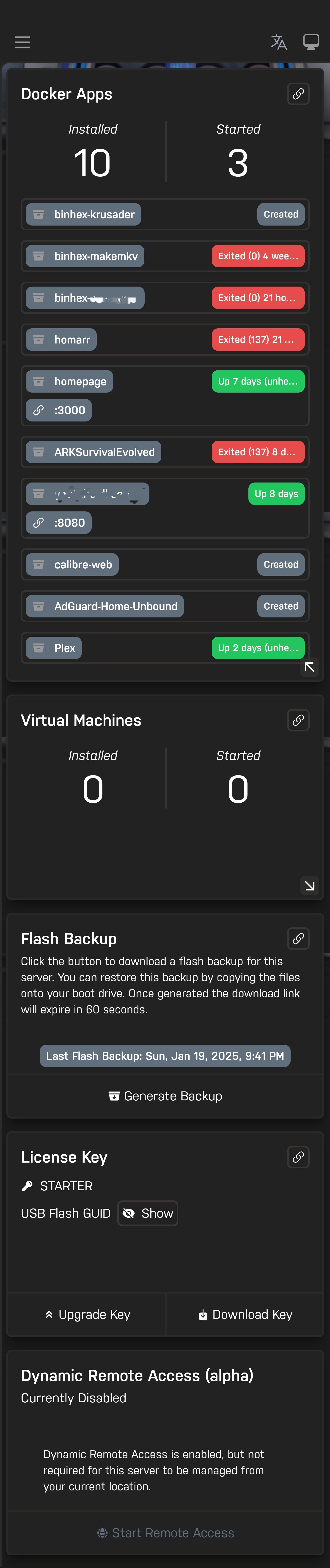

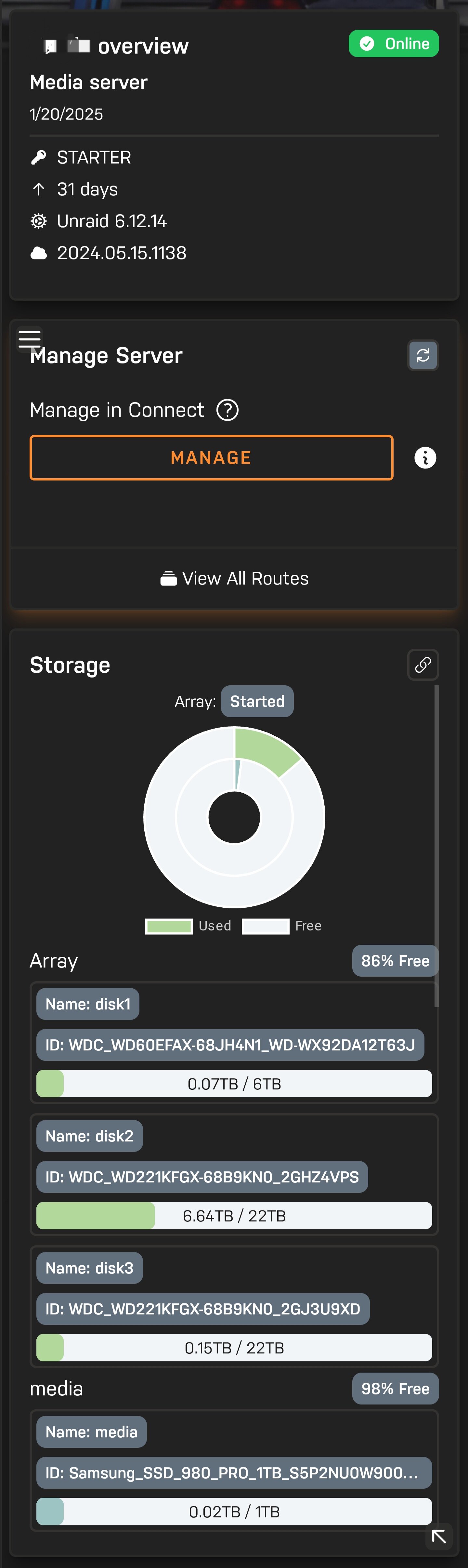

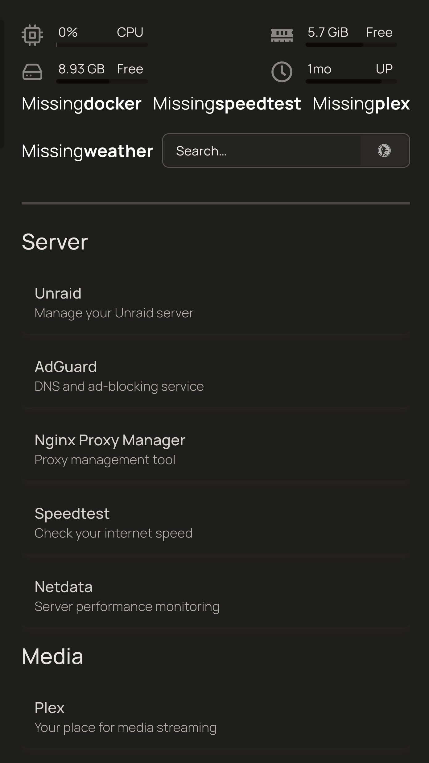

When I enter the correct user & pass and hit log in it clears the text fields like I never tried. When I enter a wrong password on purpose it says invalid. It knows what's right and what's wrong, but it still won't let me in. I also can't access shares half the time, it's random. The arraybis still running, plex is online and working almost at 100%. If I try and change a poster for a playlist in plex it wont load the current image or let me upload. Im not currently on the same network so im using tailscale and im also remoting into a pc that is on the same network. The pc says HTTP ERROR 500 and wont even load the login page. I did notice my ram was unusually high, 60-70% out of 16gbs. I stopped all my dockers except plex and homepage. Hopepage shows 5.7gb free for ram. The closest i can get to my dashboard is the unraid connect app showing me a few stats. What can I do? Get a new boot usb drive? Need more ram? A simple restart when I'm there in-person?

I am not sure exactly how to reply to you with this being my first time using this site, but I wanted to explain further. I doubt it is a browser issue because I cannot access it from any browser. I have tried samsung internet, chrome, and I used chrome remote desktop to remote into my pc at home. I used chrome on windows and I still cannot get in. It randomly works and I tried right now and it worked. I saw some apps needed to be updated so I went to apps and I got a lot of errors, one is "Failed to write to /tmp/community.applications/tempFiles/templates.json" and if I refresh the page enough times I get "503 Service Temporarily Unavailable". I also tried going to /main /Dashboard but i get redirected to / login. A few days ago I added the tailscale ip I use to get into unraid as a global something. I had gotten a notification in unraid to add it so I did. What ever it is may be affecting ram. I only have 3 dockers running, one uses ~400mb ~150mb ~150mbs. Im using a total of 700mb of ram yet my ram usage is at 11gb/16gb, so 70%
However, I think I messed up the files to something somewhere. I was messing around in appdata for homepage, but besides that I do not know what caused this. It is not a browser issue, not tailscale or ip because even a pc on the same network cannot get in. Shares are affected most of the time same as the log in. And redirection works because I get sent back to /login.
