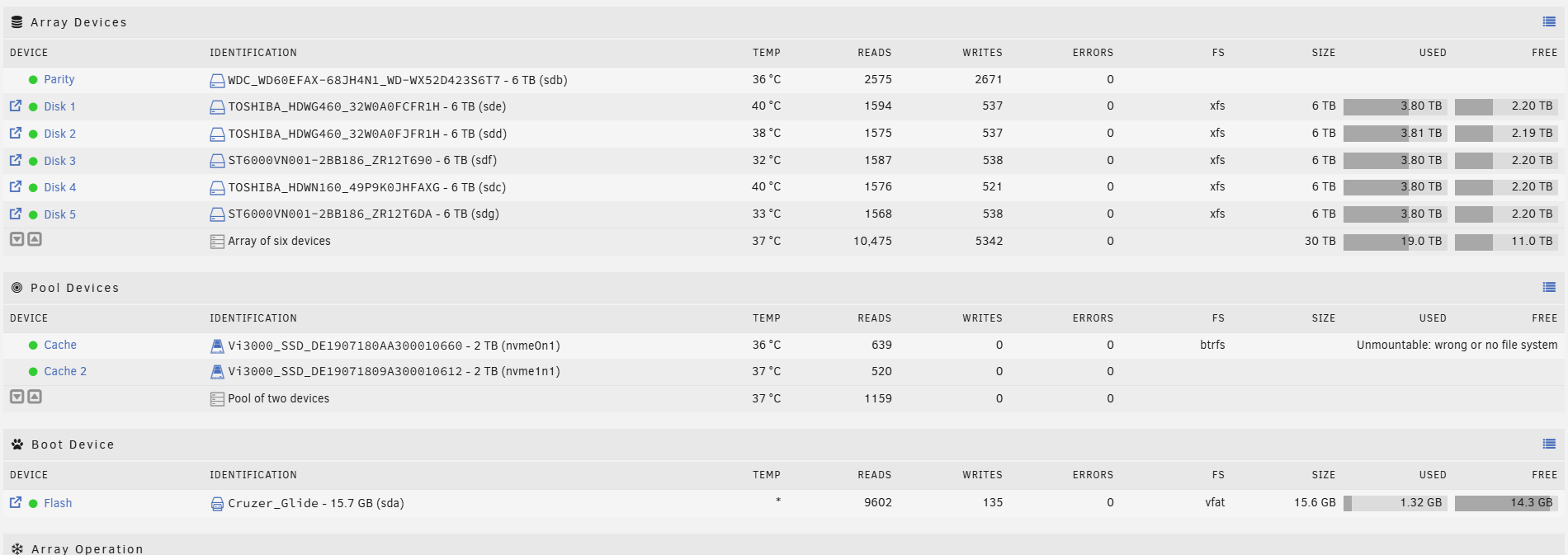

cache drives "Unmountable: wrong or no file system"
my 2 cache drives are both not working. i am getting the error "Unmountable: wrong or no file system". The file system is btrfs. my diagnostics are attached.
How can I fix this? For what it's worth, both cache drives have 99%-100% SSD endurance remaining.

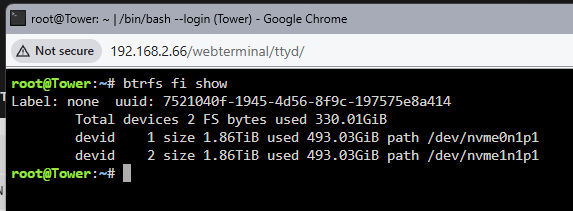

run a btrfs scrub and check disk from the web ui disk menu:
Please stop the array at the start in maintenance mode:

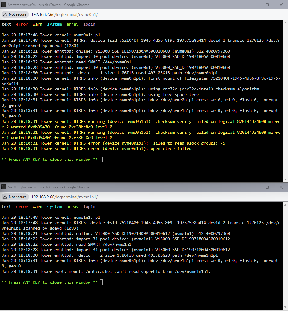

On 1/21/2025 at 3:53 AM, JorgeB said:
Since btrfs is detecting data corruption recommend running memtest first, then there are some recovery options here:
https://forums.unraid.net/topic/46802-faq-for-unraid-v6/page/2/#findComment-543490
