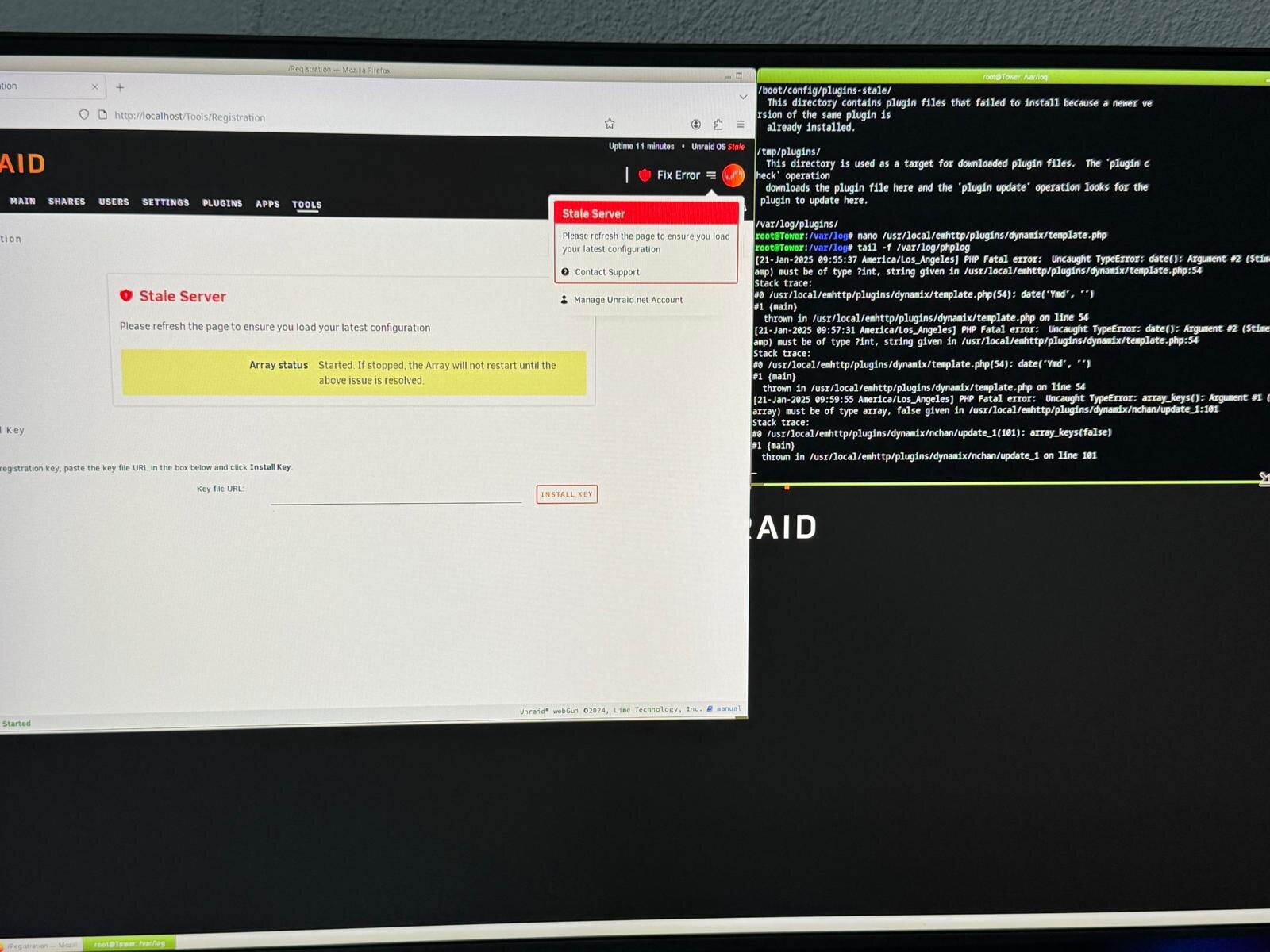

Recently I had a power loss and since then I have no web ui.
To get UI I have to do
/etc/rc.d/rc.nginx start
/etc/rc.d/rc.php-fpm start
As they are not doing autostart
For a moment this works fine for login but then I get php errors when I login, I get :
tail -f /var/log/phplog
PHP Fatal error: Uncaught TypeError: date(): Argument #2 (Stimest amp) must be of type ?int, string given in /ust/local/enhttp/plugins/dynamix/template.php:54
Stack trace:
#0 /ust/local/enhttp/plugins/dynamix/template.php(54): date("Yd', "')
#1 (main)
thrown in /us/local/enhttp/plugins/dynamix/template.php on line 54
And if I replace that code with 0, I get
PHP Fatal error: Uncaught TypeError: array_keys(): Argument #1 ($ array) must be of type array, false given in /usr/local/emhttp/plugins/dynamix/nchan/update_1:101
Stack trace:
#0 /usT/local/emhttp/plugins/dynamix/nchan/update_1(101): array_keys (false)
#1
(main)
thrown in /usi/local/enhttp/plugins/dynamix/nchan/update_1 on line 101
Here's what I tried;
  • several restarts
  • safe mod both with and without gui
  • powerdown just to be sure about clean shutdown
  • restore backup of the usb
As soon as Unraid become unresponsive, I physically removed all the disks from array in the hopes for not losing data.
I have no idea what/where to look at in the logs so I'm at my wits end.
And yes I ordered a UPS...

The flash drive is missing files, including the go file, restore from a backup or the stock zip.
