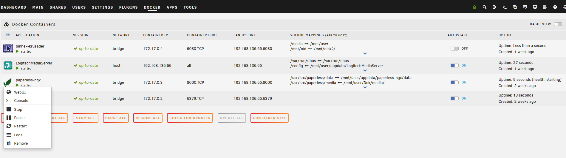

Docker Tab, click the icon and select "Edit". There you can modify any variables you set originally or change them etc.
I seem to recall doing that kind of thing in the past, but for whatever reason I can't seem to find the "edit" option.

Because "edit" is based upon the name matching the template.  If the template doesn't exist, the implication is that you either created the container yourself at the command line and are managing it yourself, or by another application and that application is managing the container.  Your situation is closest to the first.
Not really sure how to handle the inadvertent change that you had added to the command being issued...
