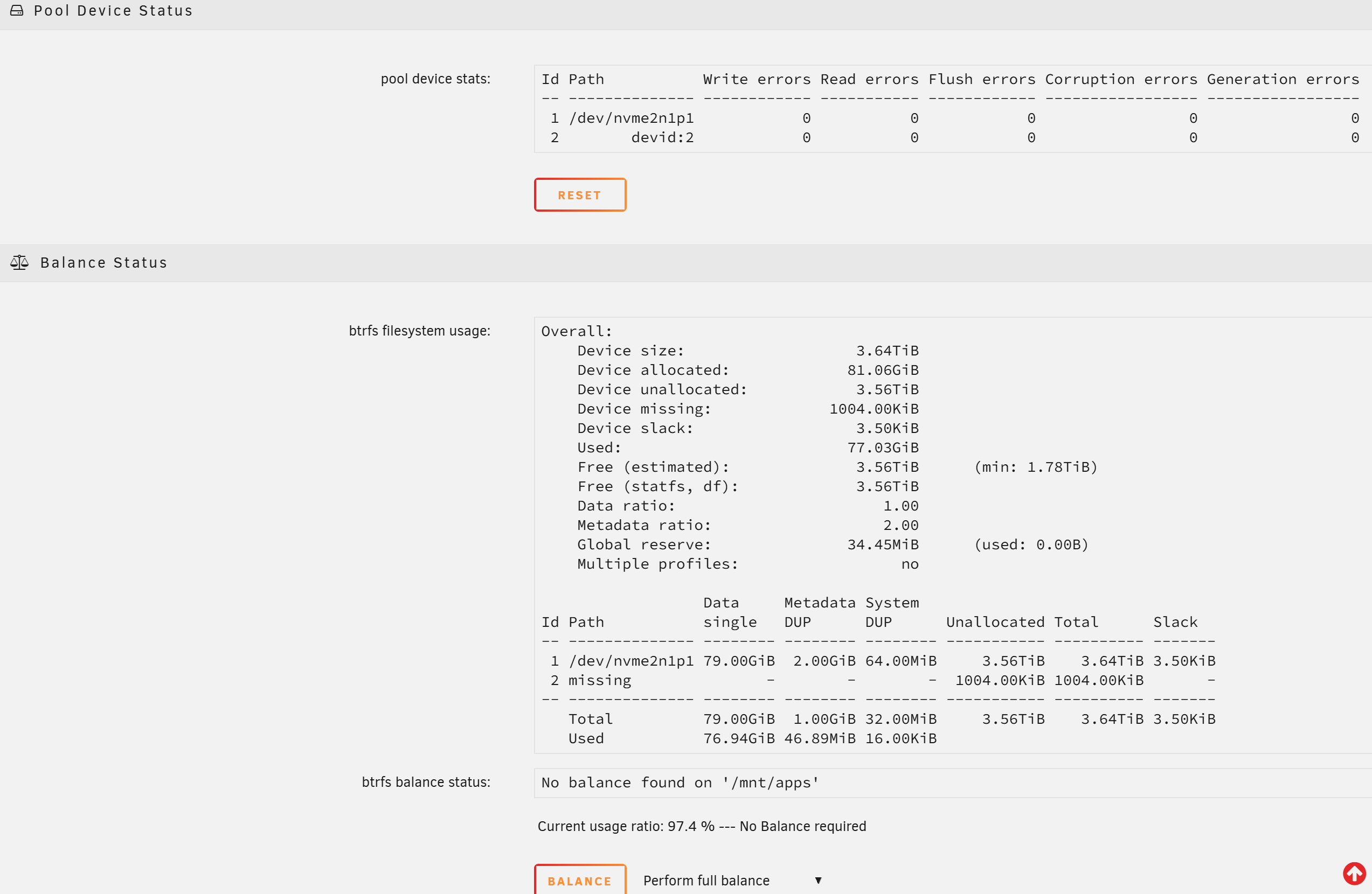

Paused the arrays, added the drive to the pool, started the array... But the stats looked like that 2nd drive isn't really being used. I also didn't notice a rebalancing or anything, even though I triggered it manually.

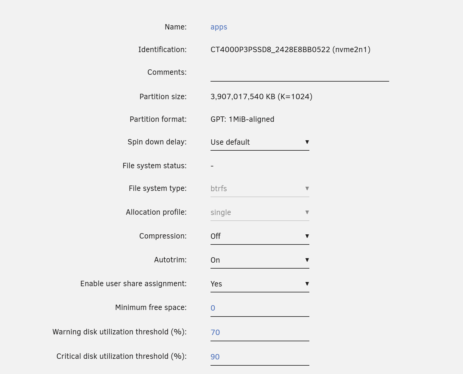

It also only shows the first drive in the status and file system, and "allocation profile: single" which I cannot change.
How can I add the 2nd drive and have it properly be used in RAID1?

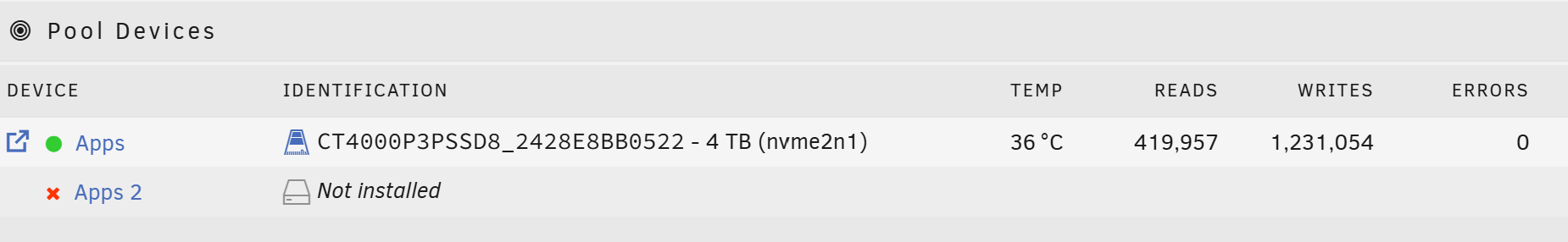

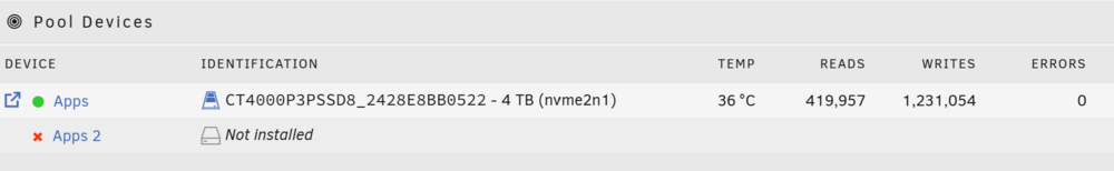

OK, I did that. What seems odd is that when I went through the steps and re-added the new pool (same name) with a single slot, assigned the 522 drive, and started the array - it automatically shows me "Apps 2" as not installed. Did it reuse the old pool config somehow? Attached also the new created diagnostics.
It's normal, because the other device was "missing", now stop the array, assign the other device as apps2 and start the array, it should start a balance, when the pool activity stops, post new diags.

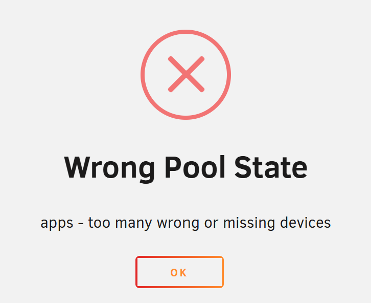

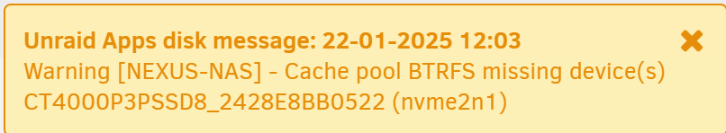

Stopped the array. Assigned the second drive as app2, but now it cannot even start the array and gives the following error...

The problem is that the pool is a single in the cfg:
diskFsProfile="single"
But not sure why it is that way, doing what I asked should import the poor as "raid1", and I just tested to confirm, and it did that.
To fix the issue:
  • stop the array
  • unassign apps2
  • edit /boot/config/pools/apps.cfg and change diskFsProfile="single" to diskFsProfile="raid1", sve and exit
  • reassign the apps2 device, start the array.

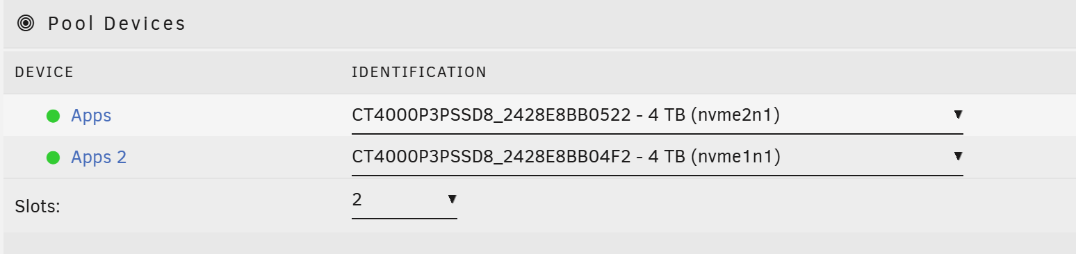

Thank you, the array started back with that change.

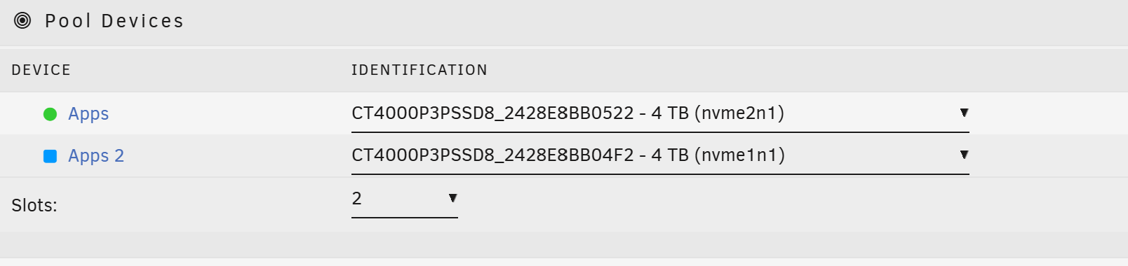

After assigning the second drive and starting the array, I see diskFsProfile=single again in the pool, even though it started back up with both assigned... Is that normal? I do see the second drive listed now but I want to make sure it actually is running in RAID1. Diagnostics attached.

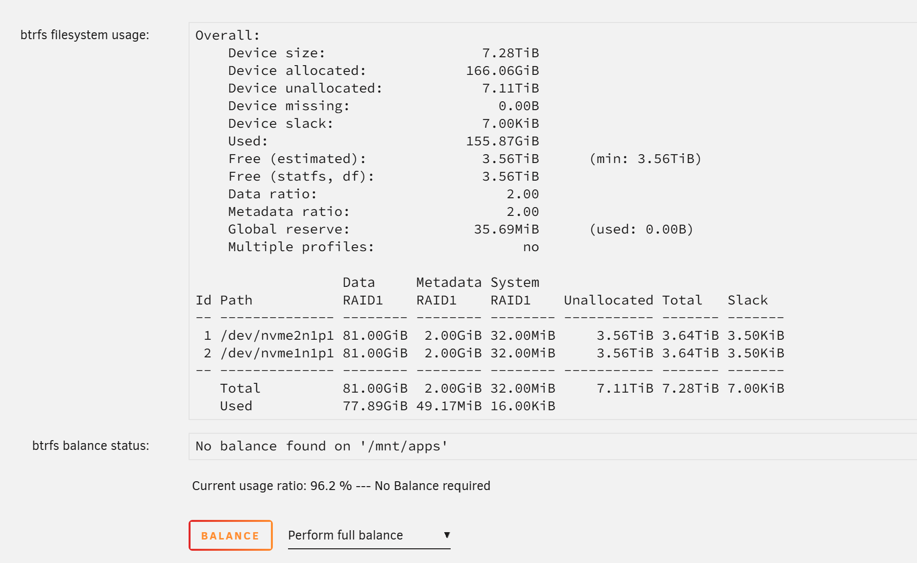

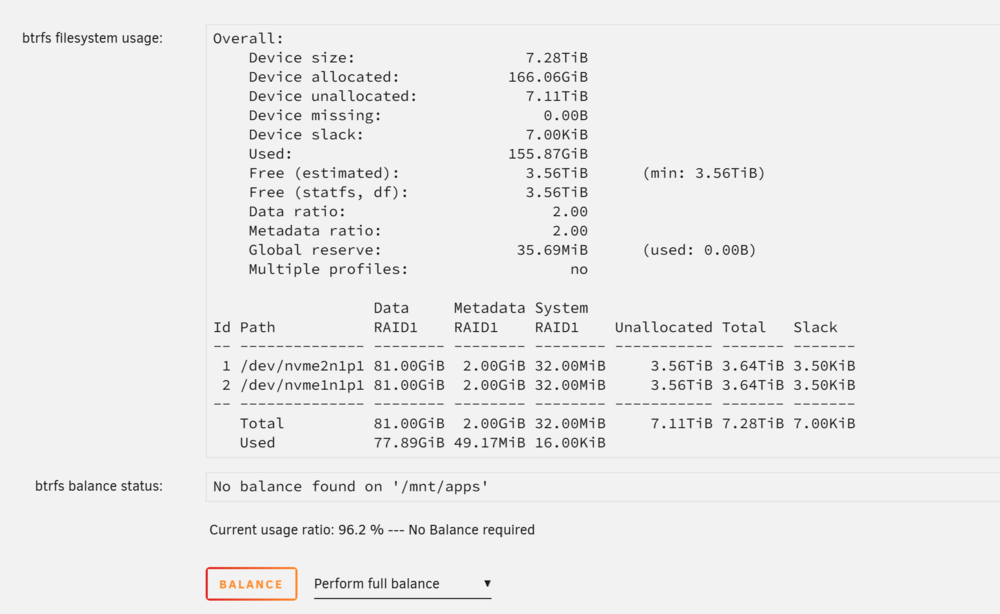

It balanced to single, not sure why, but just click on the pool and balance to raid1, it should then remain a mirror.
That worked now, it shows Raid1 allocation profile. The same balance conversion had no effect prior going through this process of re-adding the pool. Looks like it's all in great shape now. Thank you so much for your help!
