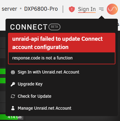

Can't Connect after reinstalling the Plugin
It all started with sporadic connection Issues. And because I just want my Flash Backup reliable working I thought reinstalling would fix the issue.
But now I can't even Register my Server anymore...
Thats all I get after going through the Registartion flow.
Here is the Report

I have attached the /var/log/unraid-api/stdout.log file. It seems that my server can reach the Apikey server.
if I run a curl command from my Unraid Machine it works
root@DXP6800-Pro:/# curl --request POST \
  --url https://keys.lime-technology.com/validate/apikey \
  --header 'Content-Type: application/x-www-form-urlencoded' \
  --data guid=REDACTED \
  --data apikey=unraid_REDACTED
{"valid":true}
So I'm now clueless why the Plugin fails and can't connect...
I Hope somebody can help me.
