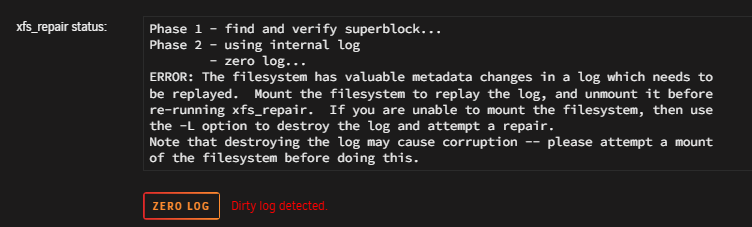

Okay so I pressed "Fix" and got this:
Click #Zero log"
13 minutes ago, JorgeB said:
Click #Zero log"
Thank you so much man! A simple solution thanks to Unraid but you really helped me. It's a very precarious situation.
