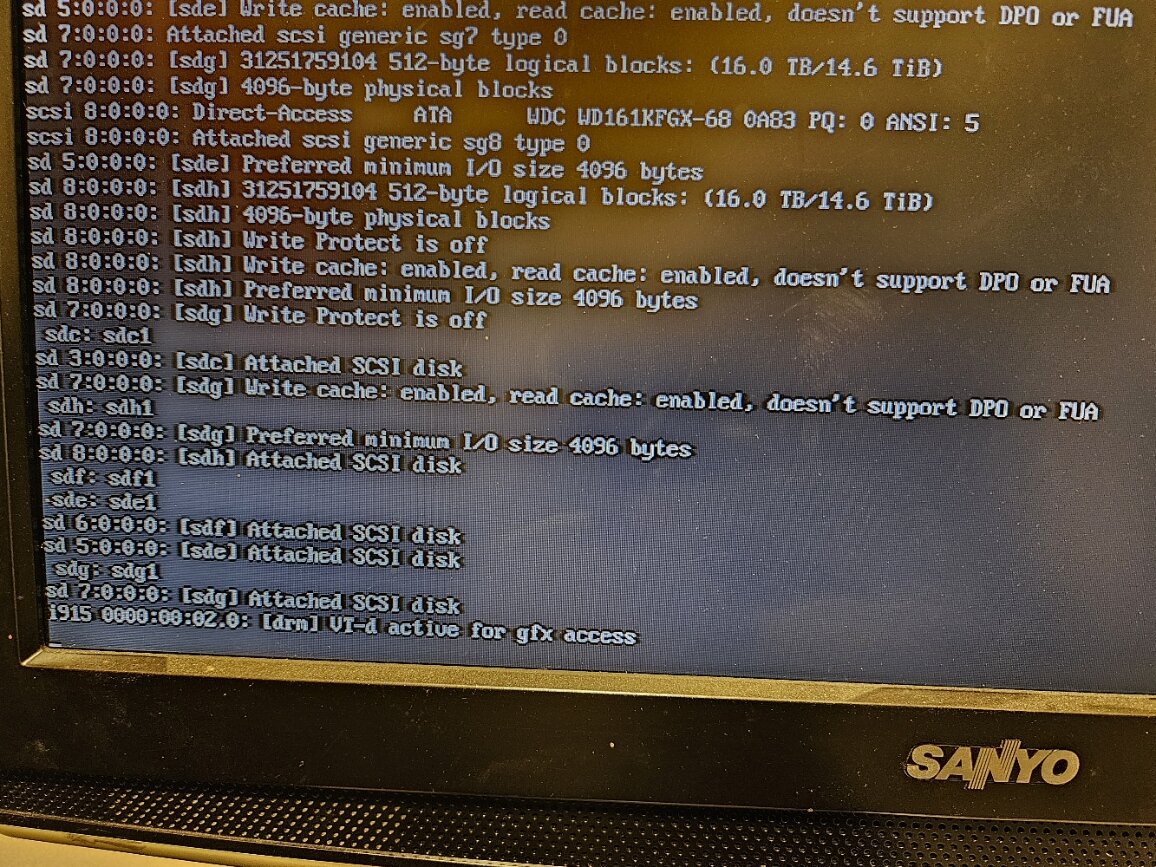

i see this is fixed in other issues but i was wondering if it was related to another issue i have i can never get to a unraid os version with ip address and unraid login command, but my server is still up and working.
the other issue i have is when i start the server, if i just try to let it boot its a black screen but if i go into bios first and then exit it boots just fine. i have disabled fast boot and i have also Rename the folder in the Unraid flash drive “EFI-“ to EF and neither of these worked. So if i upgrade instead of rebooting i shut it down get into bios and then it will boot into unraid. I assume a reboot is the same thing as a shutdown but just faster for people? any help would be appreciated
