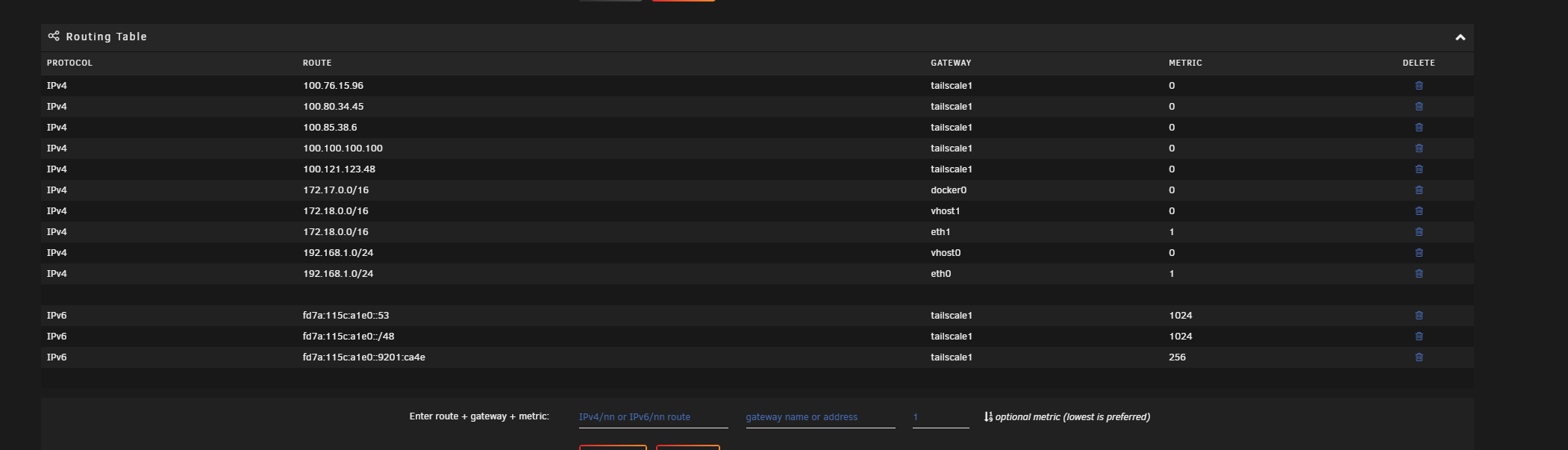

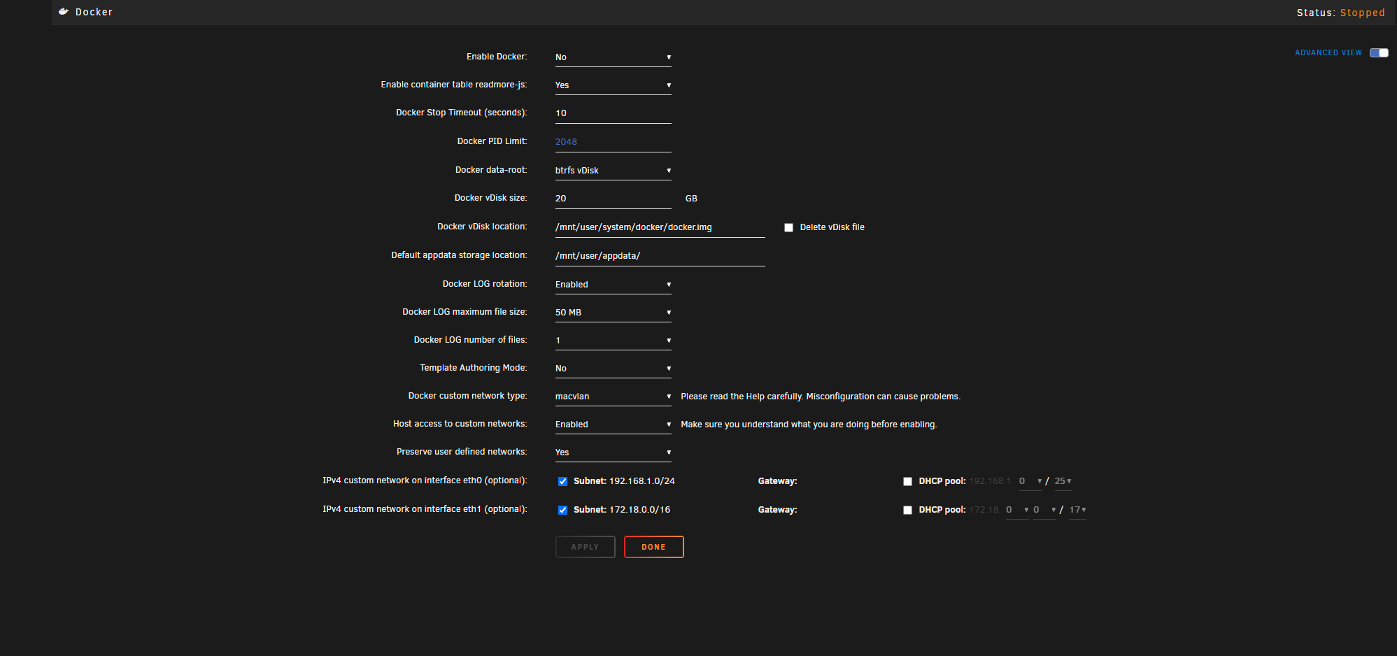

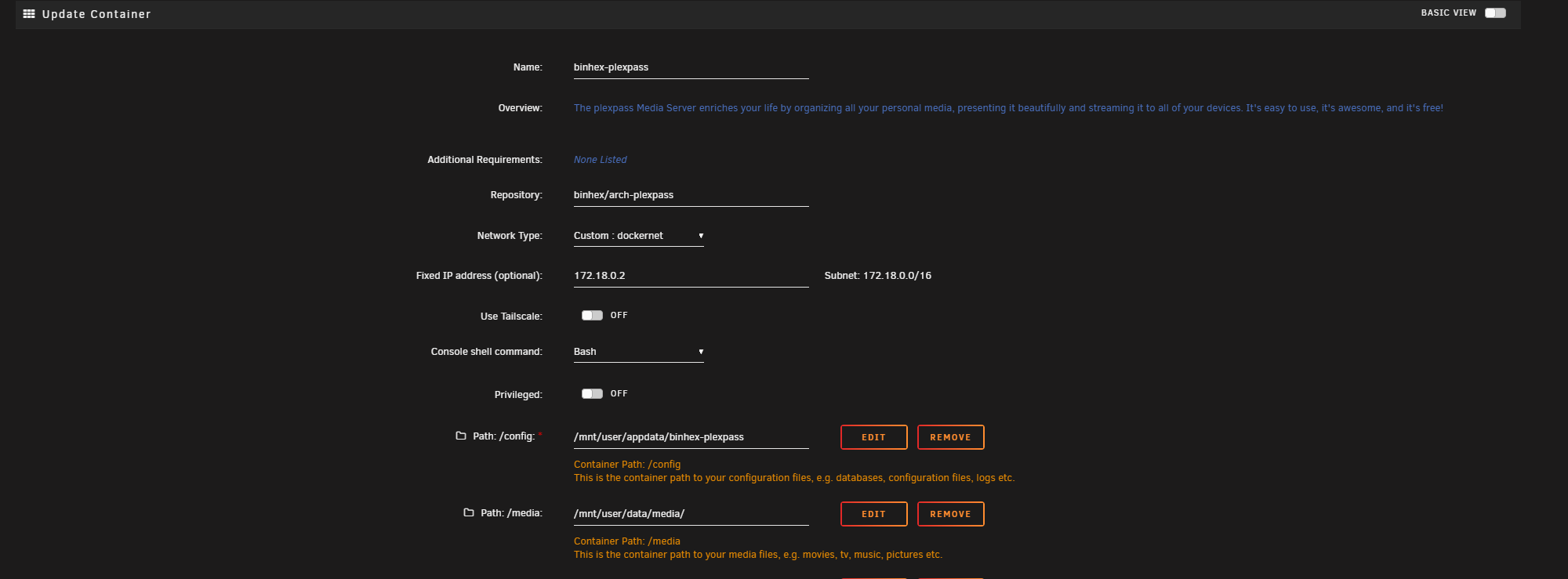

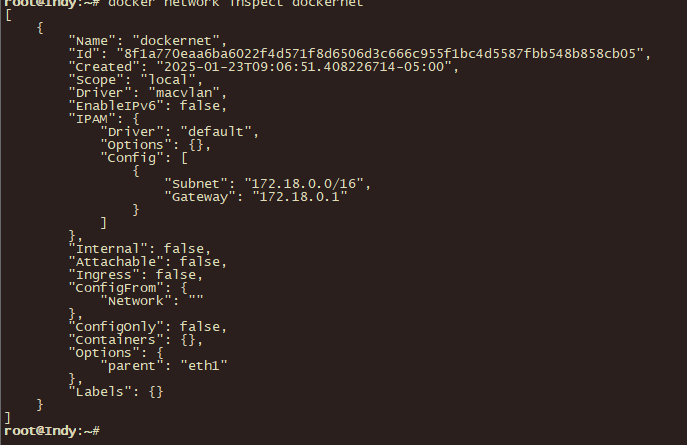

I created the docker network with the following:
docker network create -d macvlan \
  --subnet=172.18.0.0/16 \
  --gateway=172.18.0.1 \

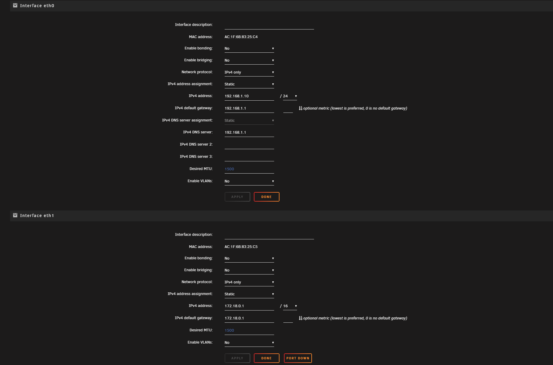

  -o parent=eth1 \
  dockernet
Ive tried setting it to the eth0 and eth1.

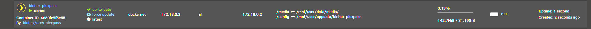

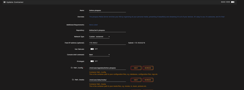

I can see the IP of the container in my Ubiquiti dream machine.

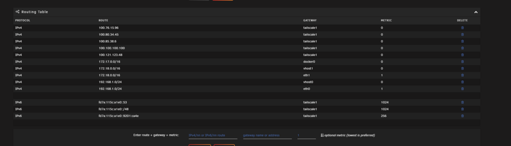

I've tried adding a static route on the router.
I dont know what else to try. I'm losing my mind at this point.
