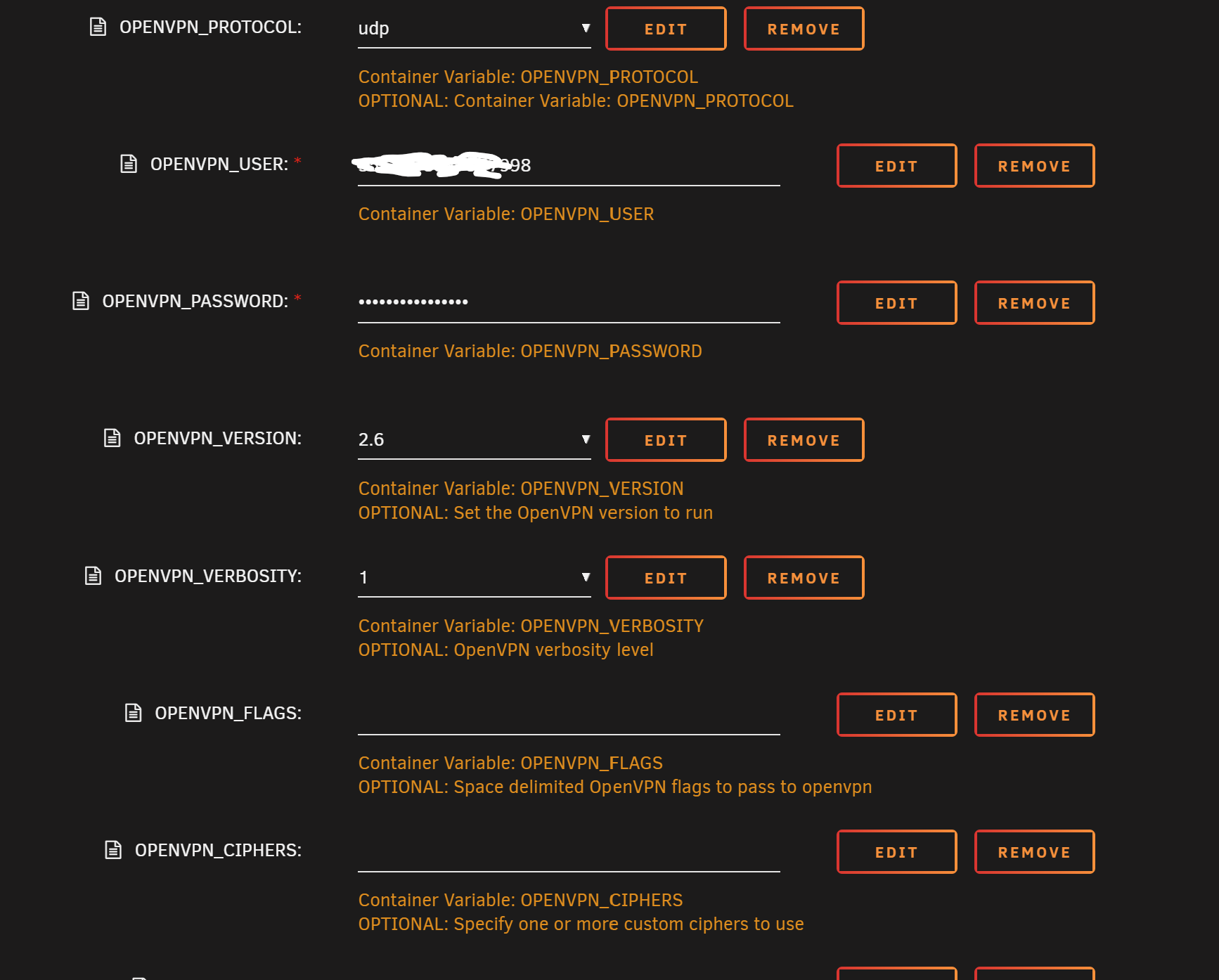

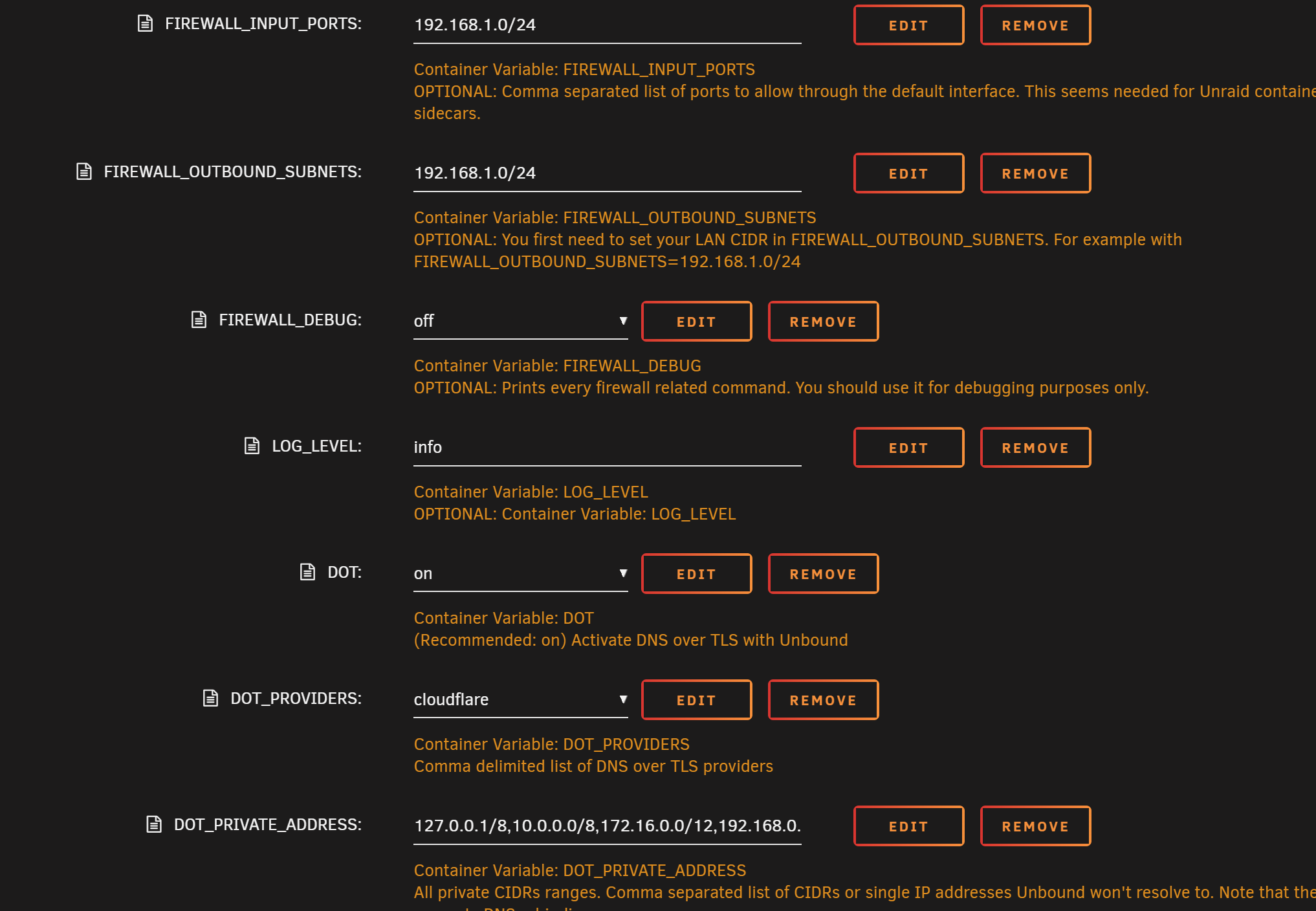

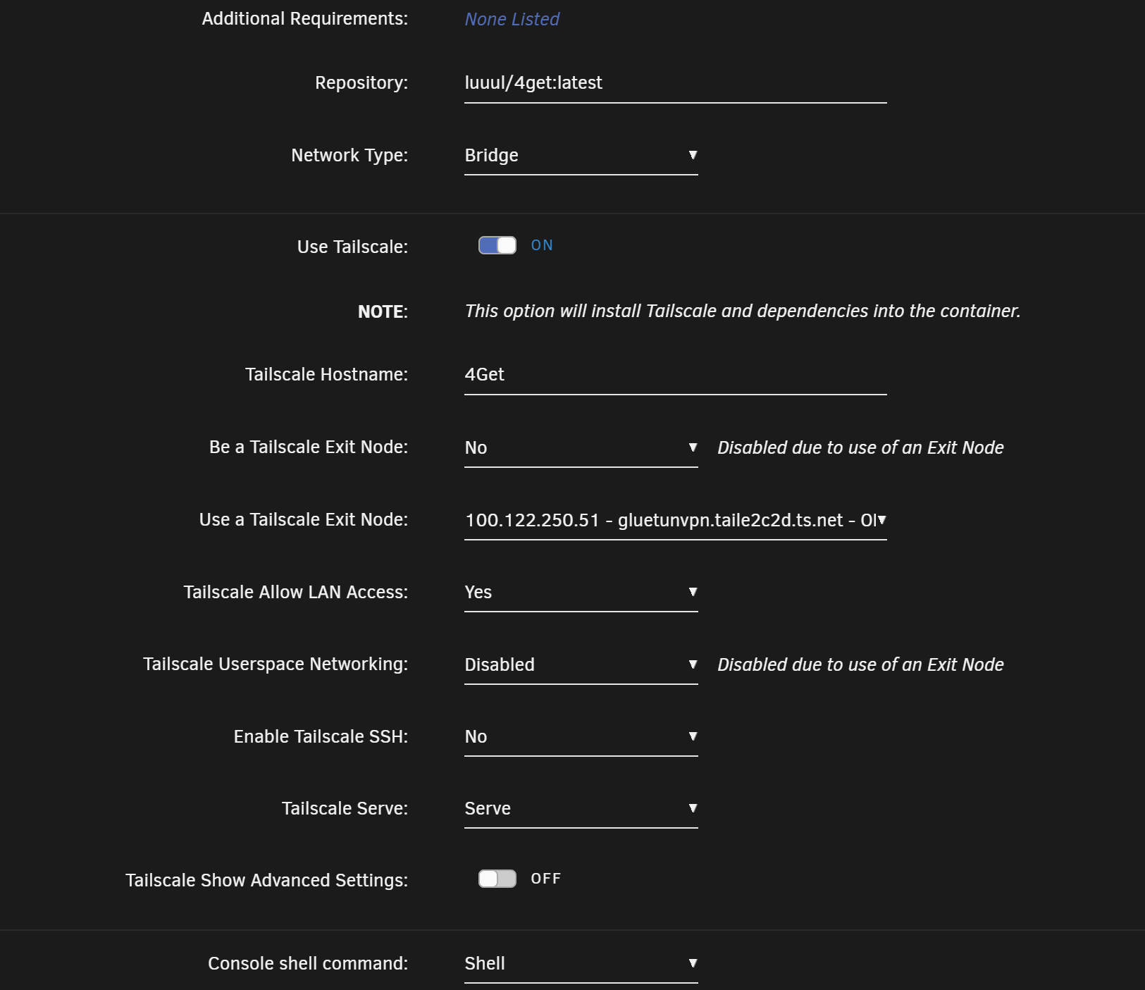

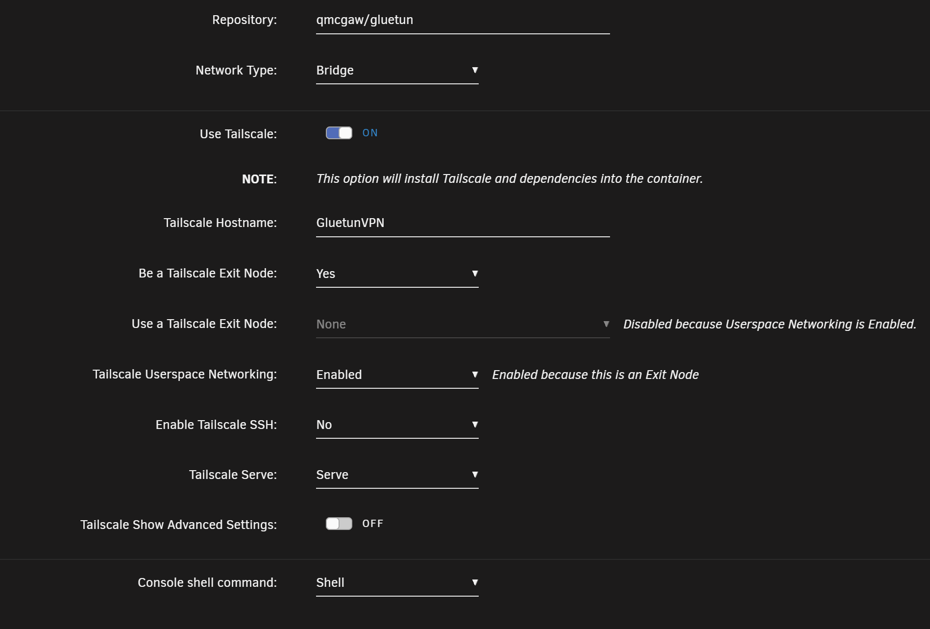

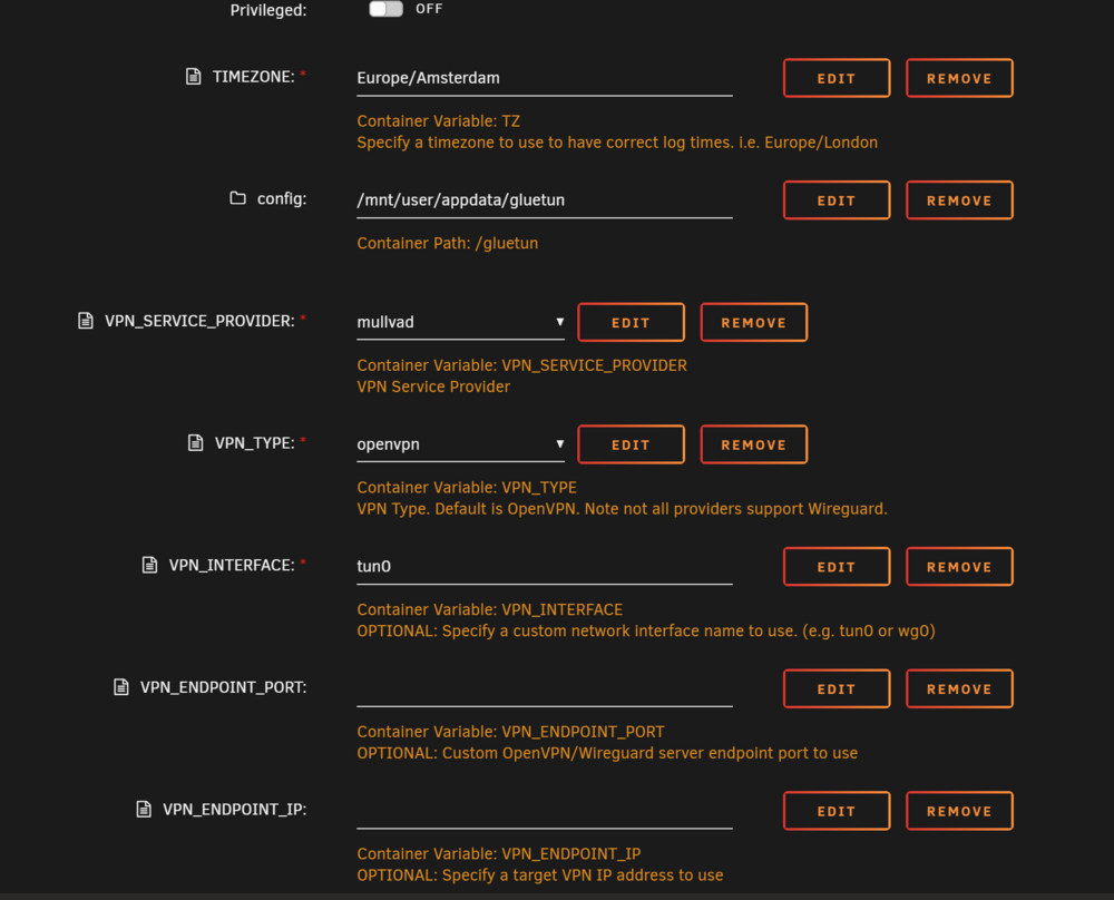

Like this?

First of all please disable Serve everywhere, did you watch the video all to the end?
Serve doesn't work for this container in the default configuration.
After you disabled Serve everywhere try to connect through a device that is able to access your Tailnet and connect with http://<4getTailnetIP> (please note that no port is needed because it uses port 80 internally and also that you have to use http:// not https://)
Do you need Serve for GlutenVPN too? I would recommend that you don't enable Serve where you not need it.
I watched it. I deleted /mnt/user/appdata/gluetun/.tailscale_state and than rebuild the docker. After that it worked.

If you update the 4Get container it should now be possible to use Serve if you only have http enabled in 4Get.
