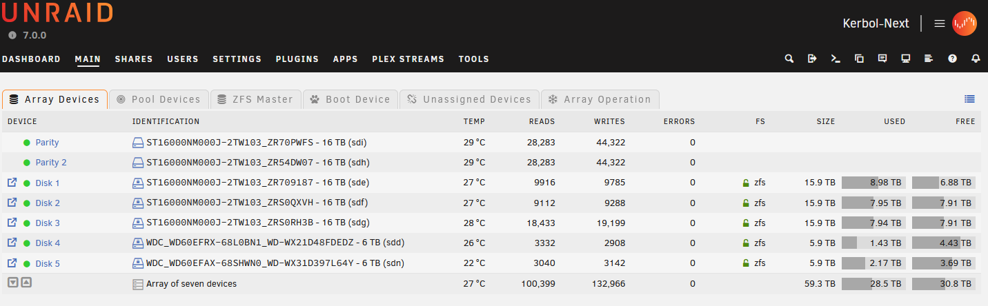

January 23, 20251 yr Community Expert Looks like the array is started in those. Didn't notice anything wrong. Post a screenshot of MAIN - Array Devices
