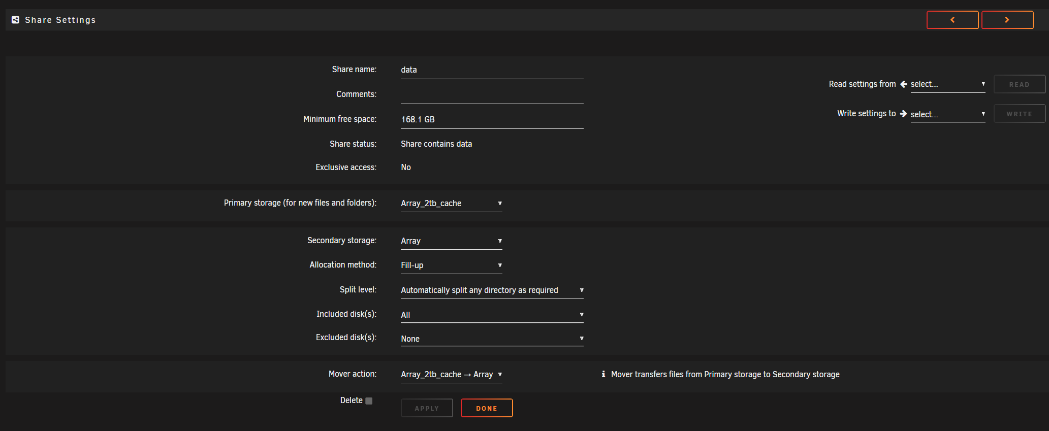

File are stuck on my cache and won't move to the array.   I'm setup correctly as per the screen shot, i've shared below.
App data is on a separate cache and is working fine.  This share is my content, and the new files are new downloads from usenet.
I'm using usenet, so not active seeding running on the files.  The file download but then do not move to the array.  The cache is 99% full. When I start mover manually and have enabled logging I get the following (with no files moving).

There's a Data.cfg, delete that one from /config/shares and re-aspply the share settings.
How do I access that folder? It's not visible in my shares GUI?
You can export the flash drive over SMB, or just use the CLI
rm /boot/config/shares/Data.cfg
