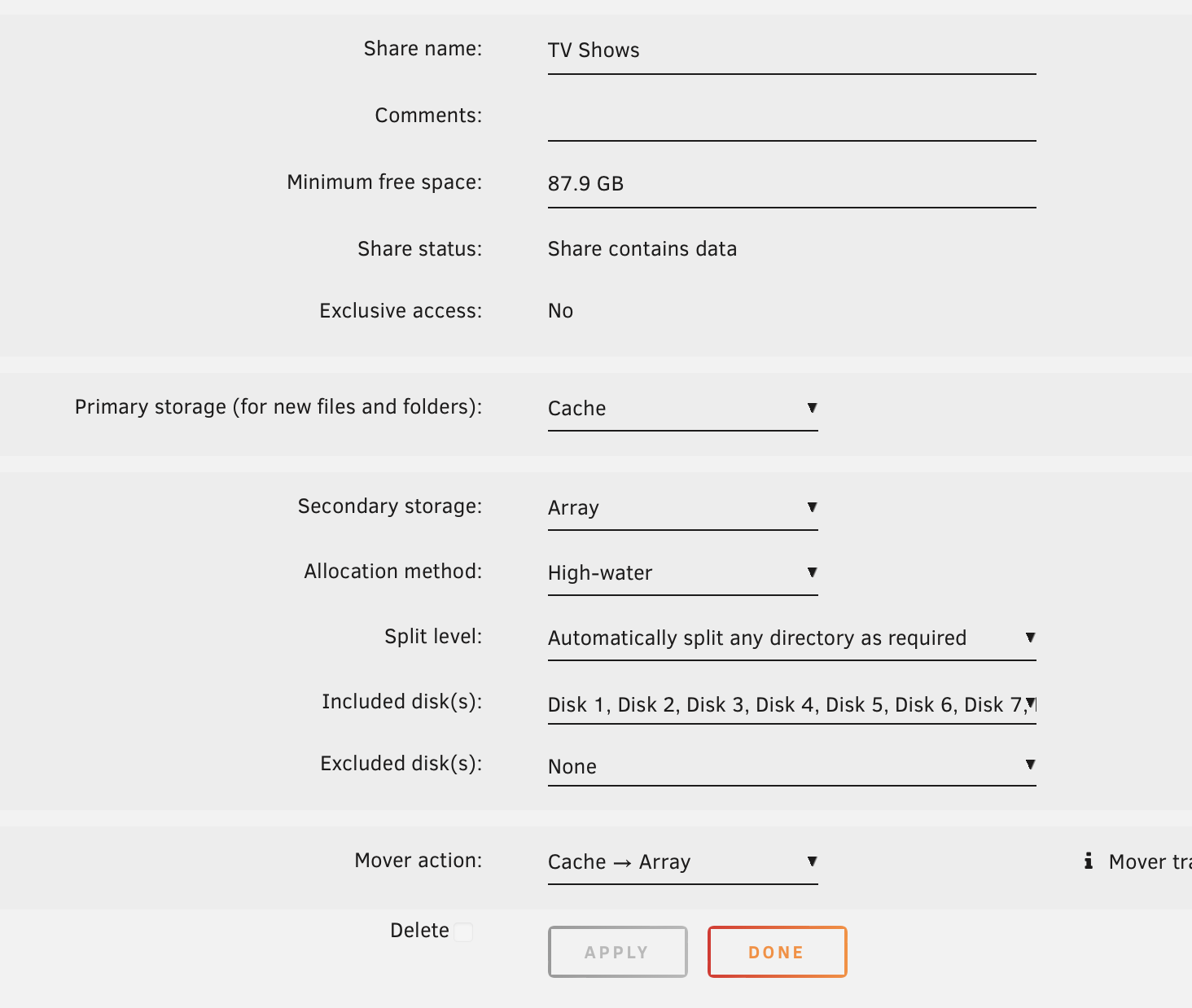

Mover not moving files to away from cache drive since upgrade to 7.0.
Any help or ideas would be fab!
tower-diagnostics-20250126-1334.zip
Solved by JorgeB

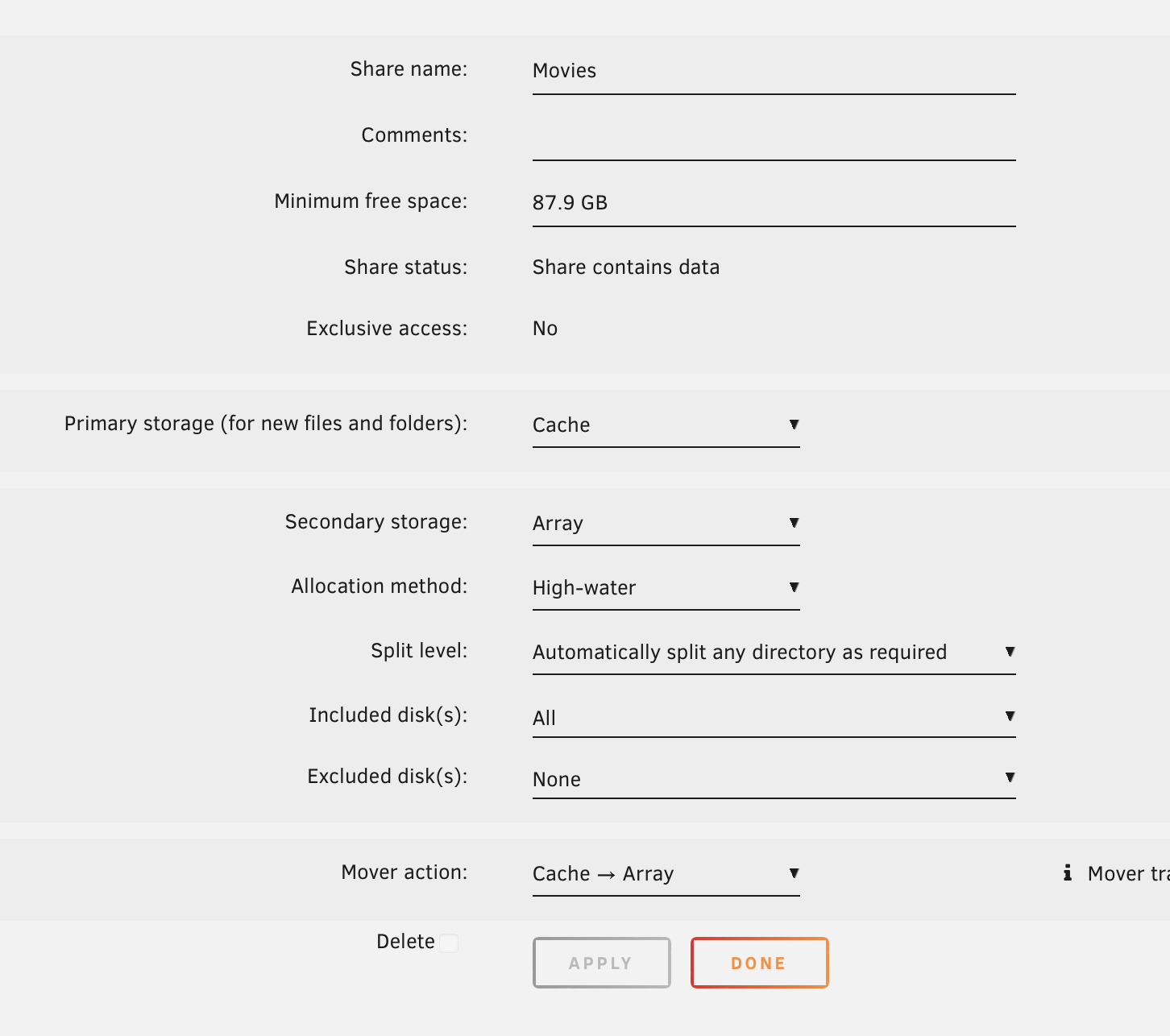

Same Problem here. And i don´t see any share options for primary or secondary storage.
I updated to 7.0 from 6.12.14.
unraid-diagnostics-20250126-1055.zip
Edited by rl2664
Remove the mover tuning plugin and retest.
57 minutes ago, rl2664 said:
Same Problem here.
Your share is configured as array only, so the mover has nothing to move, you need to select a pool as primary, array as secondary.
As you can see in the screenshot, there is nothing to configure in the share settings since 7.0.
New data always is stored on the cache disks and the mover moves it to the array. That also work in 7.0 until the point that the mover should move. I downgraded to 6.12.14 and updated to 6.12.15 and everything works fine.
Heres the diagnostics from 6.12.15. Somthing wrong is happening within the update 7.0.
EDIT: I get it, somehow the configuration of the share get lost in the update process. I changed the configuration now to Cache -> Array and test again...
unraid-diagnostics-20250126-1345.zip
Edited by rl2664
With the array as primary, there's no secondary option
29 minutes ago, itimpi said:
@rl2664  you should definitely remove the Mover Tuning plugin.
If the problem still occurs then try booting in Safe Mode as if then works one of your other plugins is causing the issue.
I dont have this plugin installed. Maybe the original poster @Garthy
There is some confiuration that got lost in the update process. As @JorgeB already pointed out, the cache was disabled after the update. If i run my backup user script, the data is stored on the cache and because the lost config never moves away from there.
Whatever, everything works fine now. Thank you all very much for the fast help.
