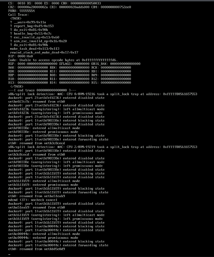

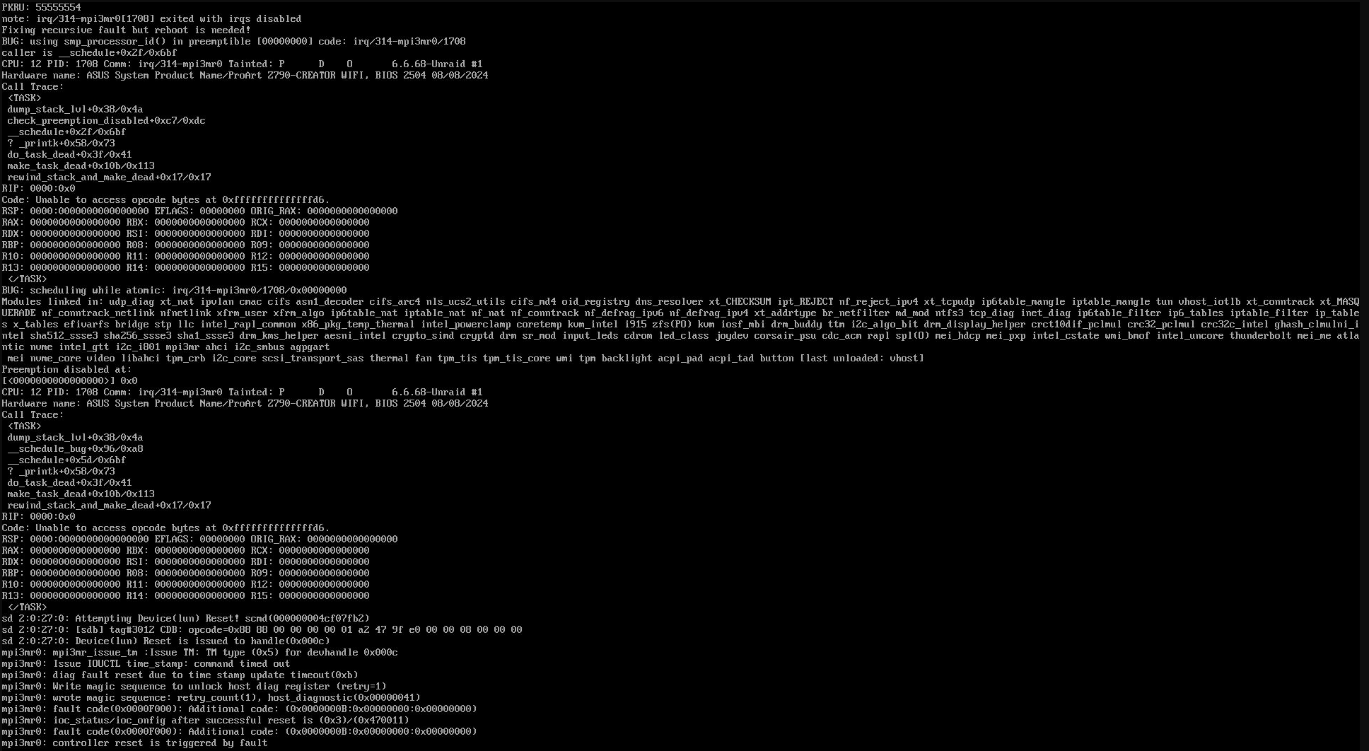

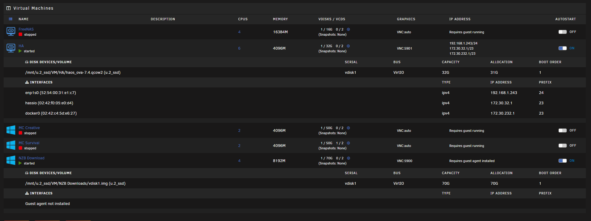

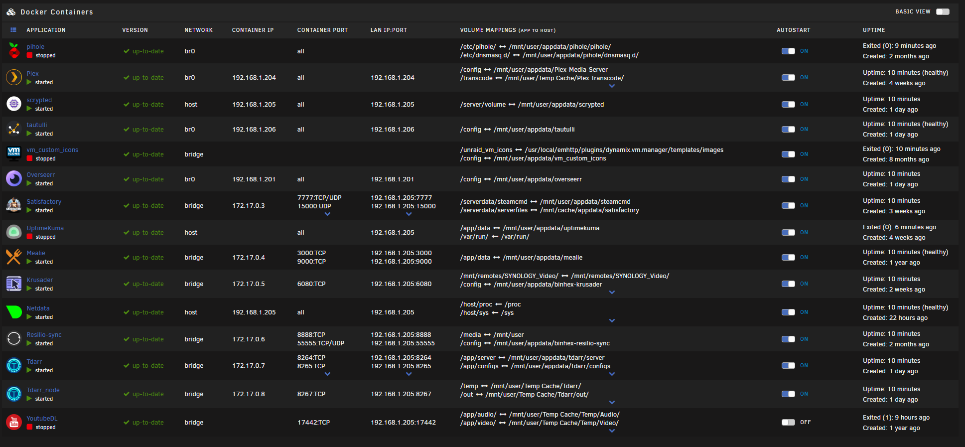

Prior to 4pm yesterday my system has been rock solid (would run 3+ months no issue) since it has been running so long and I had an HBA to add, I figured I would do the 7.0 update finally. so I checked to make sure all plugins and docker containers were up to date, then went forward with the update. there was a lot of issues after the install that seemed to be related to the USB flash drive having corrupt files. after 24hrs of dealing with that the system will be "stable" until its not. I was not able to catch the text that showed up on the main screen of the server, however it had to do with port 0 - eth0 enabling and disabling or eth0 being renamed. I was looking to see if someone can look over the images to let me know if there is something I do not have set right with the network settings (br0 / bridge / host) also had some issues come up when starting and stopping VMs that really upset Unraid as well... errors came quick, could not get a screen shot. but once that happened my Docker Vdisk started to balloon to the point that the server was mostly unresponsive. I was able to send reboot command via command line, but it never happened.
I have a couple pics of my docker / VM info as well as the last set of errors that popped up right before it locked up. sorry I do not have more at the moment. I need to look into what info could help and will get that setup for the next time it happens.

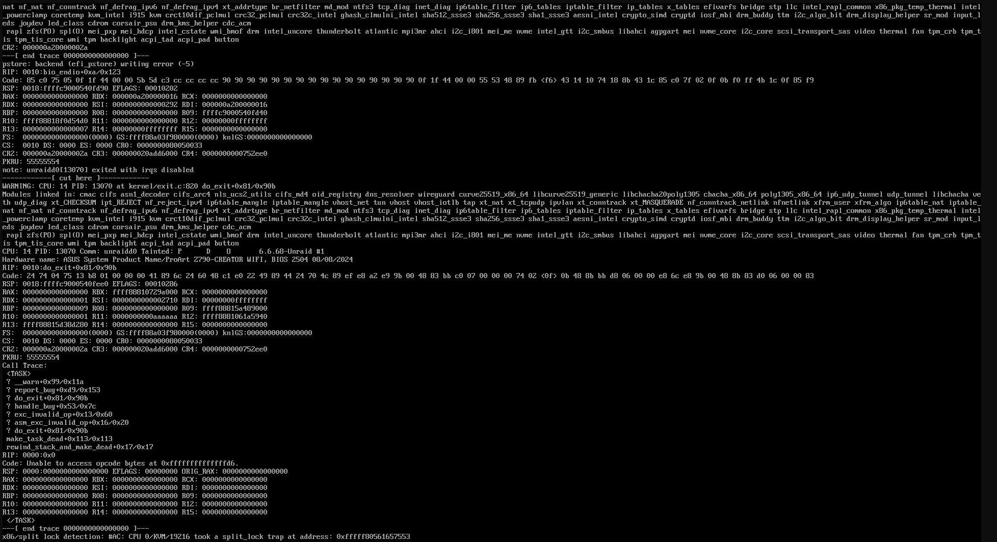

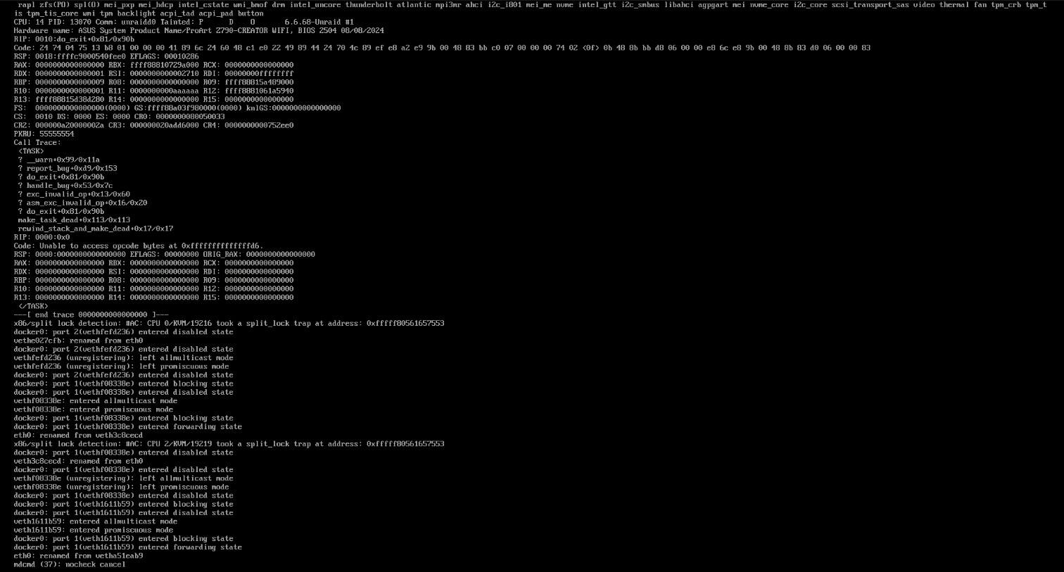

Reboot and one of my returning issues showed its face... while the server is still up and running... I dont expect it to for too long.

Some more messages about network related errors?. what is odd it this only shows up when I am trying to do network heavy workloads (like backing up data from this unraid server to my backup box)

Unraid driver is crashing, this is almost always a hardware issue, start by running metest, and since you have an i9-13900K, it could also be the Intel 13/14 gen issue.

interesting. once I started having all the issues, I put the original hardware back in and nothing changed. (original HBA) I will check memtest. I did have issues quite some time ago with the CPU... (6 months back) it would crash as soon as an hour, to maybe running only a couple days, was random. however it was a completely different scenario. was basically a dead box when it would crash. since doing the micro code update, has been perfect. it was not until I did the update to 7 that everything changed. I was able to run the server for 3+ months and not need a reboot. now I cant get it to run a few hrs without all these odd issues that eventually cripple the server. Is there a way to tell if a flash drive is bad? The unraid OS said it was corrupt. after formatting and restoring files, it has gotten better, but makes me wonder if this can potentially be a USB flash drive issue? just throwing things out there in case. just having a hard time with this is all. thanks for looking.
Flash drive issues are typically logged, but you can try replacing it.

Log is filled with call traces, looks more like a hardware issue.
