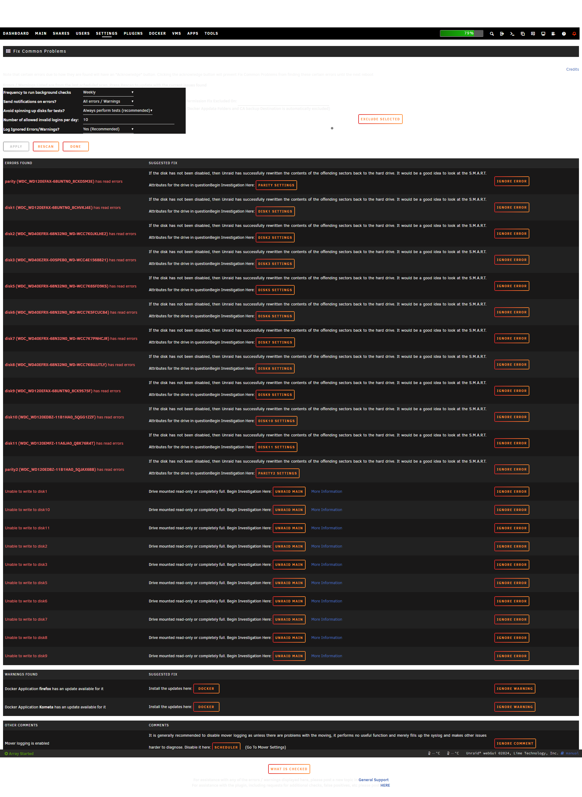

Fix Problems Page
screencapture-192-168-1-3-Settings-FixProblems-2025-01-26-14_05_45.thumb.png.f3153906375650e0a969dbf87ce3f57d.png

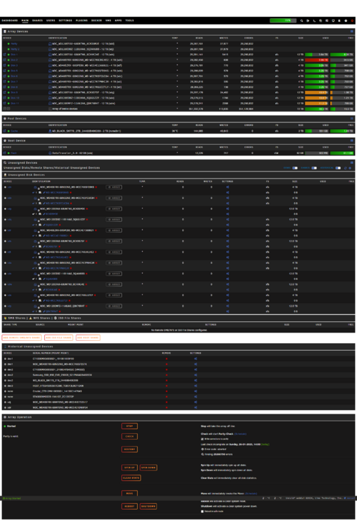

Main Page
screencapture-192-168-1-3-Main-2025-01-26-14_04_18.thumb.png.22a90c716bdd2ea7aaadd91e7d21ac85.png

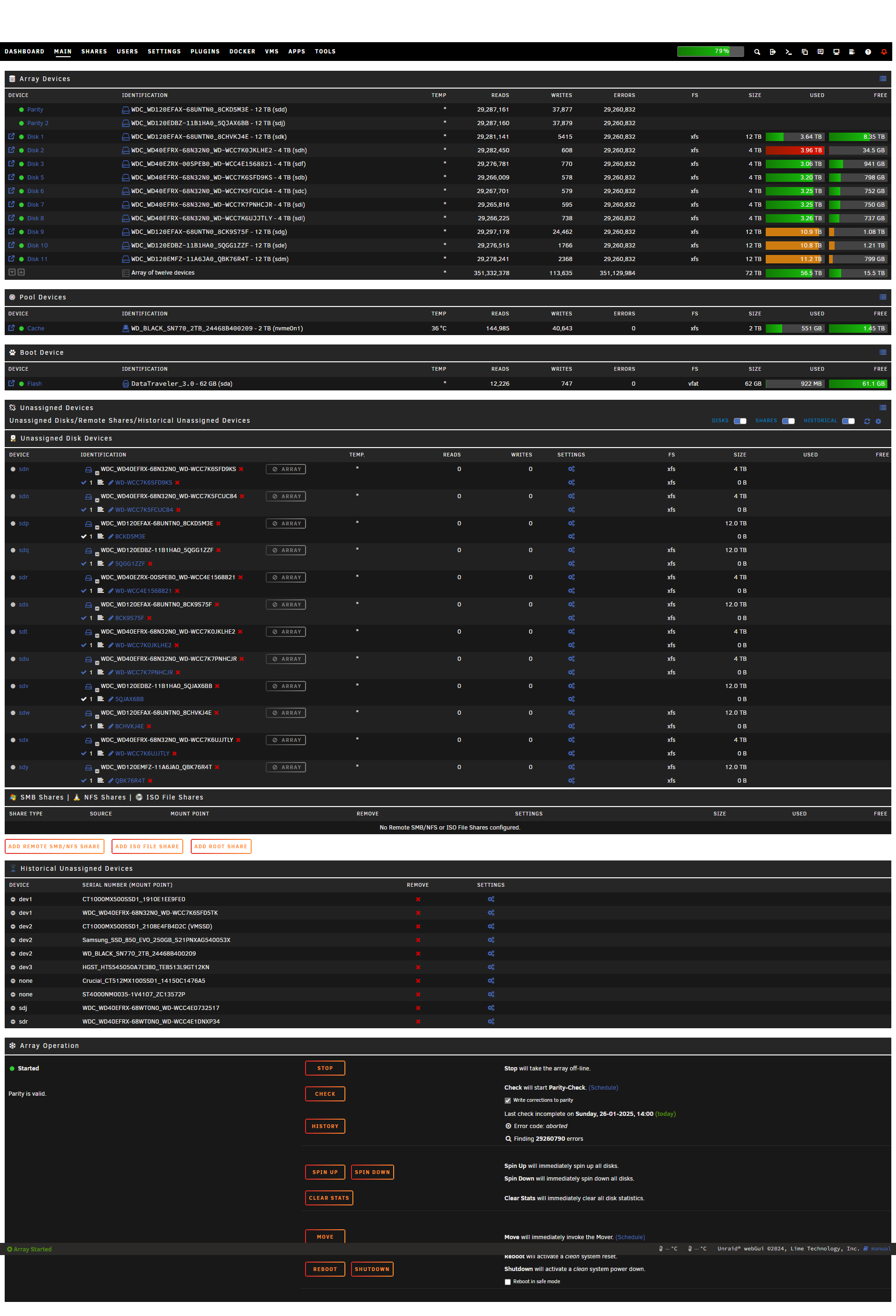

After stopping the array it looks like all the disks are missing, going to shutdown and make sure the card is seated correctly. Might just move back to the original slot?
Moved it back and everything is working but would like to understand what happened if possible and whether I should just leave LSI controller in 4x PCI slot and call it a day.
The HBA reset itself, you can try again and make sure it's well seated, but it could also be a compatibility issue with the board and the HBA in that slot.
