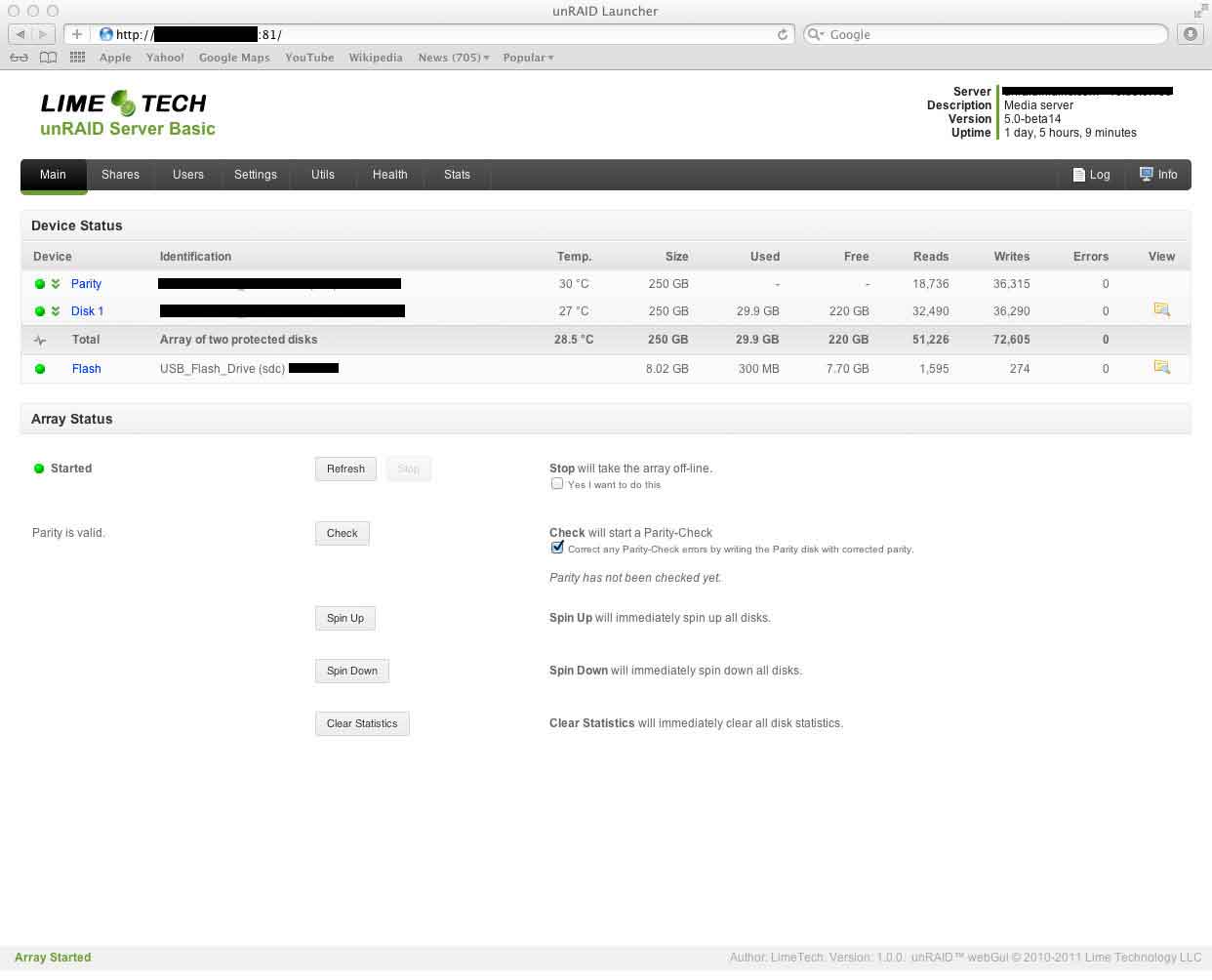

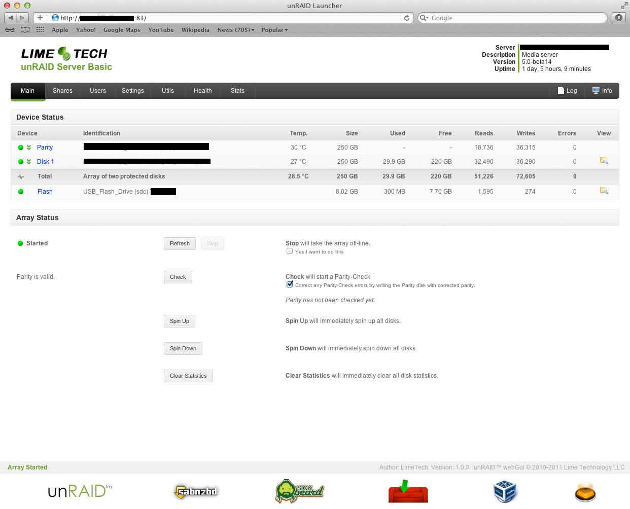

One idea for a plugin... Have a navbar for the various sites / apps hosted on unRAID.  I used your web server plugin and mixed in some dynamic html to have a navigation bar across the bottom that autohides.  In there I placed launcher images for each of the various sites hosted on the unRAID box.  Makes quick work of jumping between them!
Thanks!
(screenshots attached)
